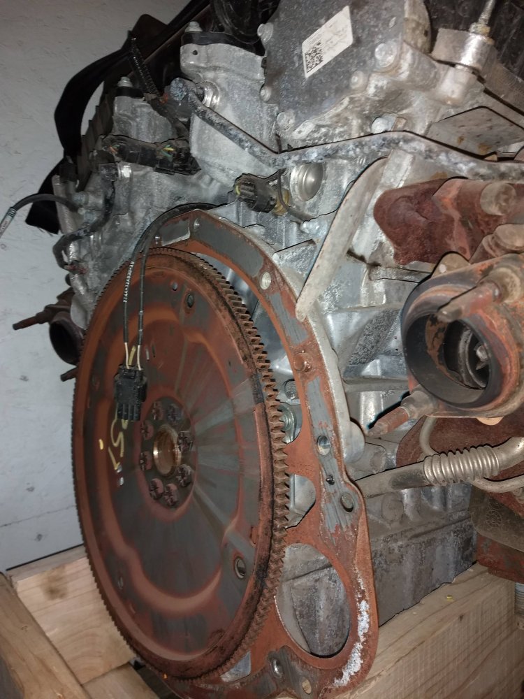

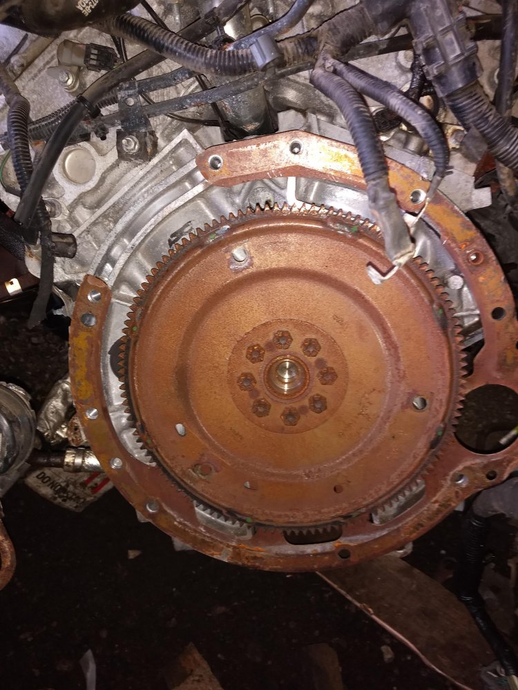

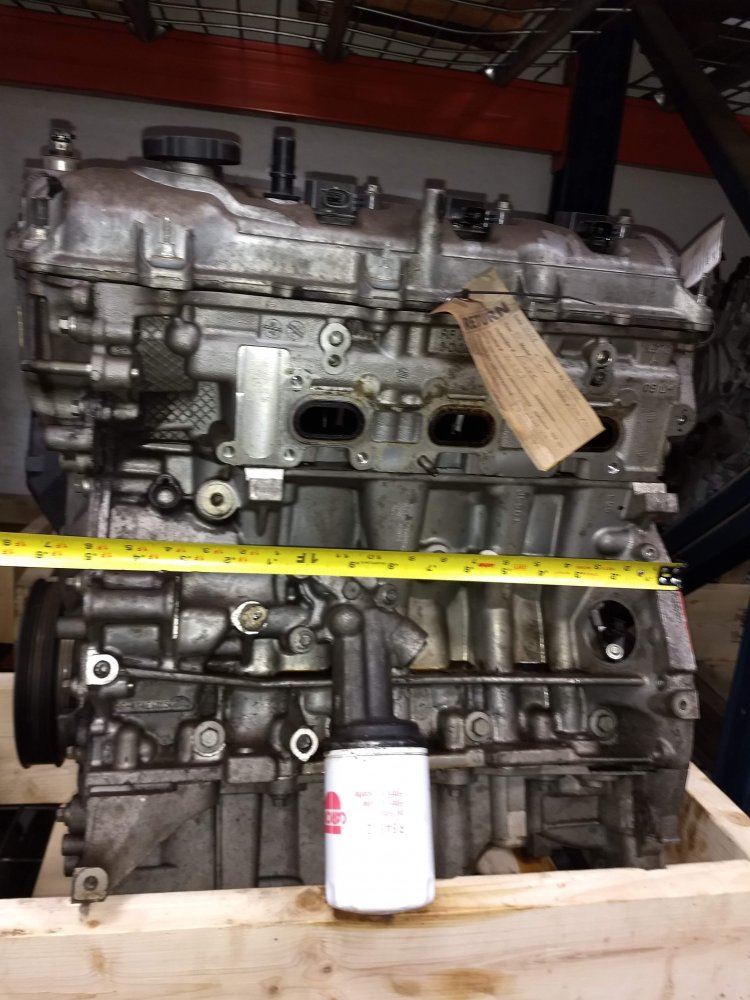

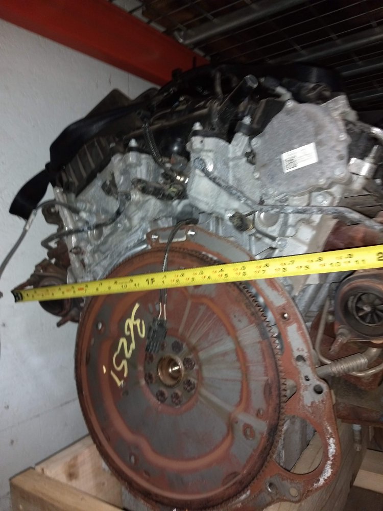

I have few good pics of the L I have handy at home....but this bay pick on the exhaust side will give you an idea.
The L block is essentially the same. 2.0 has a longer rod then the 2.3..... so dwell....rod ratio and valve and injection events are diverse in results. Closed deck vs open deck are variables...but lazy cam phazers will murder head gaskets and heads over 350 HP with either design..
