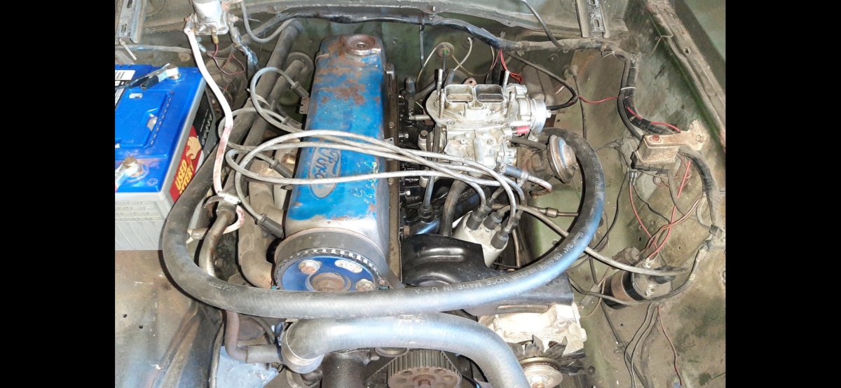

2.3 carb help. What are these gizmos?

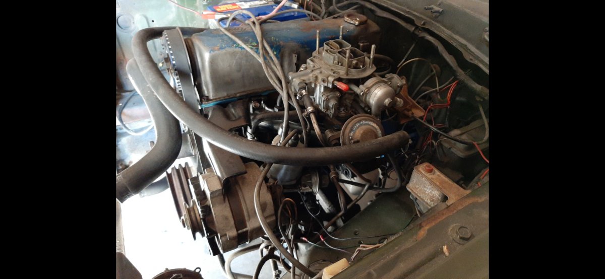

In second picture, the accelerator pump can be seen to the left of EGR valve it is attached to the side of the carb with 4 screws

Here's what I'm working with in all its glory... I miss computers...

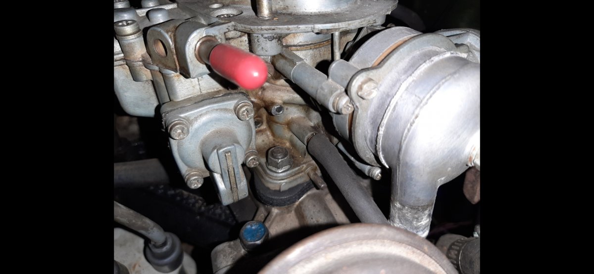

Vacuum advance most times was hooked to a vacuum sourced from below the throttle plate. Should be fine to block it off for now. There are usually 2, 3, or more vacuum ports along the base of the carb. Some will be vacuum at idle, some at open throttle.
These are the only 2 vacuum ports ON the carb, the red cap, and the one below is where the vacuum advance was connected.
