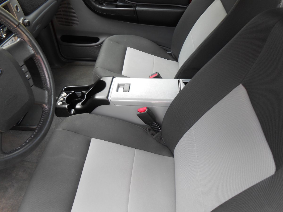

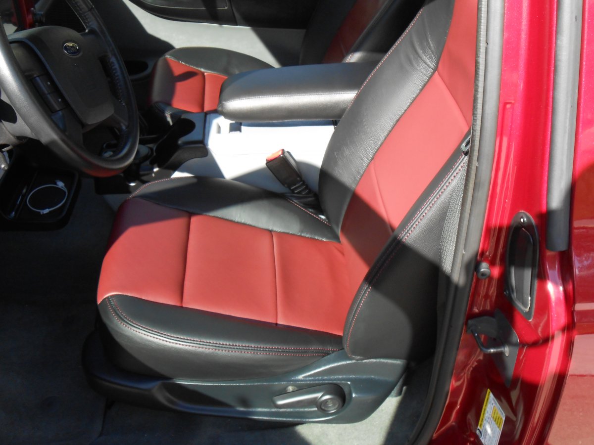

Cut the Drivers seat, add an Explorer center console from the u pick-it lot. New seat covers for a bucket seat and there you go. There are several videos on you tube to show you how to cut the drivers seat. Here's mine I cut the seat and added console and seat covers from katzskin-leather. The Black & Gray is the stock material tucked in tight after cutting 20% of the seat off. The leather is the final deal.
