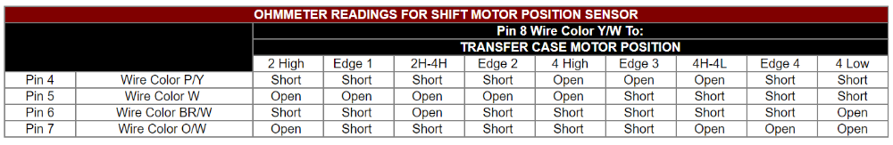

You can test the wires with ohm/continuity tester to see if the contacts are working
Yellow/white wire is the main wire
Other color wires should connect to the Y/W wire as you turn the shaft, as shown below
Its important that the shaft be re-set in the correct position on re-assembly
This is how the 4x4 controller can "see" what position the shift motor/transfer case shift rod is in
Yes, the flashing 4WD lights means either the shift motor is not moving OR the contacts/sensors are not changing like they should

Yep. that's the one I have. On the testing grid, what is Edge 1-2 etc?
As the shift motor moves the 4x4 Controller expects to "see" instant sensor change to the "edges" of each of the 3 selections, 2WD, 4H and 4L
Then it expects to see the contacts opening and closing, as shown, until it gets to the selected position
4H-4L is actually Neutral selection, although not a "setting" you can access without a no longer sold "neutral kit", it was use for flat towing of a 4WD Ranger automatic behind Motor homes
If you look at the transfer case with motor removed, Neutral is directly across from 2H, between 4H and 4L
