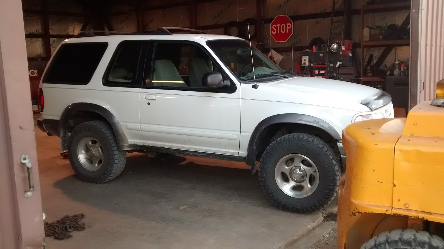

I'm starting a build thread mostly so I can keep track of where I am at on this build. Here's the project vehicle as it sits currently. Spring over axle in back with shorter shackles, full coil over conversion in front. Aussie locker in back and lock-right in front.
I haven't made up my mind for sure if I want to go full width or not. I picked up a narrow front LP disk braked D44, lift coils, lockouts and some other spare parts from PlumCrazy (thanks again for hooking me up with this for a great price) but I also bought a full width front HP disk braked D44 with a matching 9in with disk brake conversion.
I've also picked up 5 used 35x12.50-17 BFG KM2s with a set of dodge rims for the large backspacing to keep it somewhat narrow if I do go full width axles. I checked and the local junk yard has a transfer case from a 96 ranger and a IFS toyota steering box that I plan on picking up.
