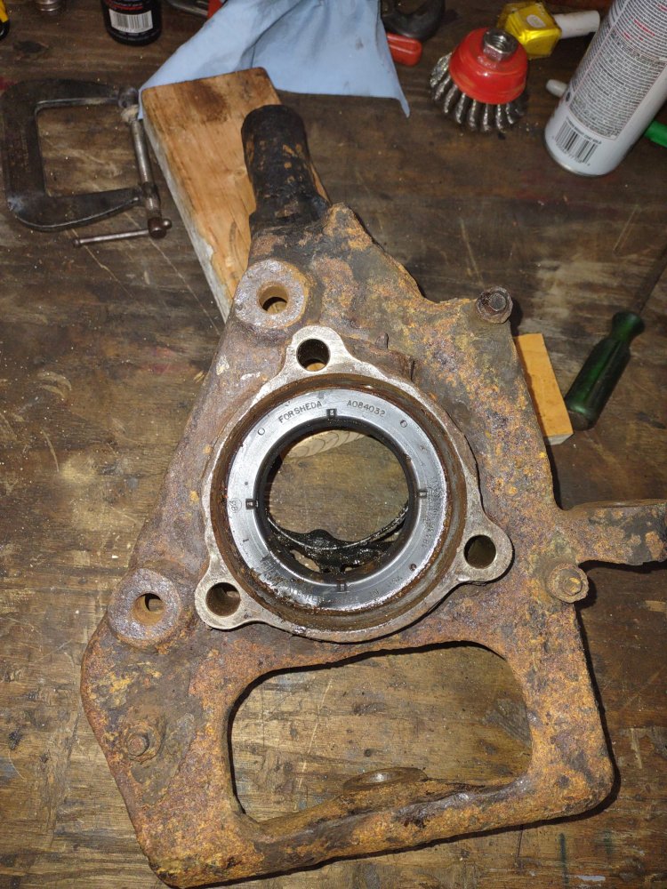

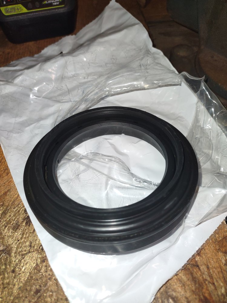

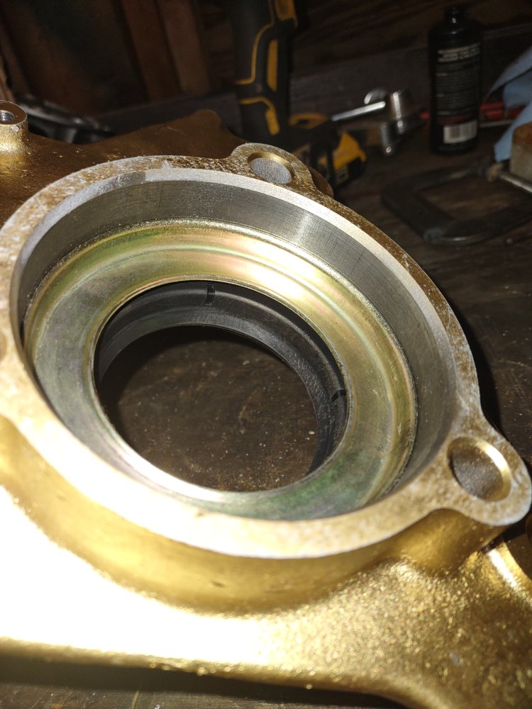

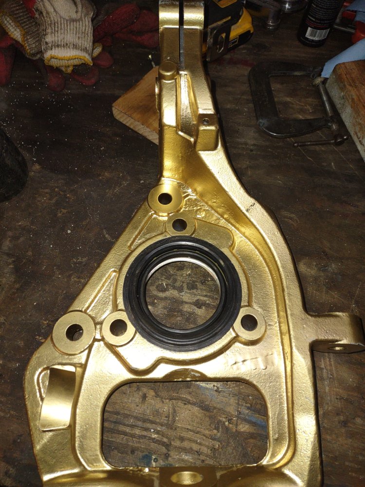

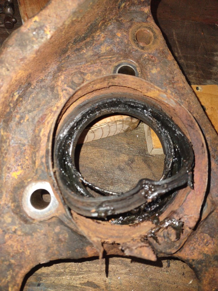

Hey all,
I'm replacing my steering knuckles and installing these seals. The stock ones appear to have seals on both sides of the hub and the ones I have are just 1 piece.
Should I drive these all the way in? The stock ones appear to be flush with the knuckle surface and there's about 1/4in between the seat and the underside of the seal.
Pics for reference

No worries I took a crack at it last night after finally getting the rest of the suspension in. I believe it needs to be pressed in all the way or the CV axle doesn't seat in enough to accommodate the orange c clip. I'm going to drive it in as far as I can tonight and report back​
