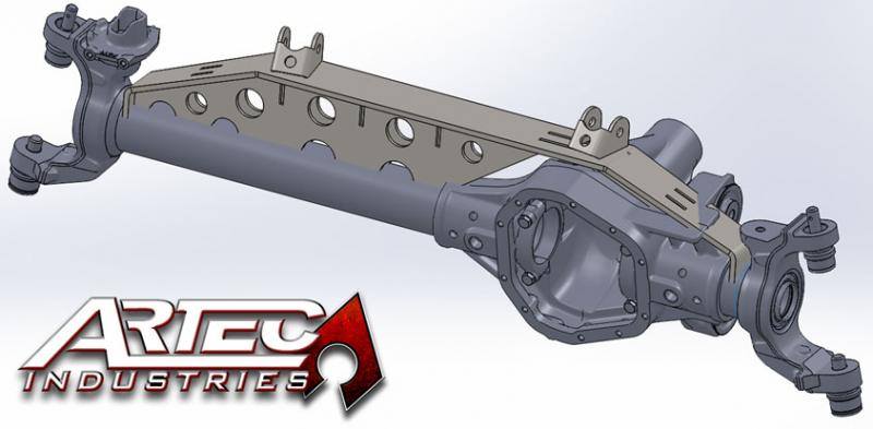

Alll the cool kids are usint super duty stuff just sayin..... my next one ill be using an 05 and up front unless they come out with a good link truss for the 99-04
It kinda fits. Artec makes one but its for a JK swaps. So I am sure you can get just the truss with a phone call.

Wonder if the leaf sprung axles the same that looks like a radius arm 60
Yea looked on thier site and it says it fits all year ranges. Find it weird they say make sure you have a 60 not a dana 50.
Seeing as the housings were the same just the 50 has a smaller ring and pinion neck down axles and 30 spline stubs.
