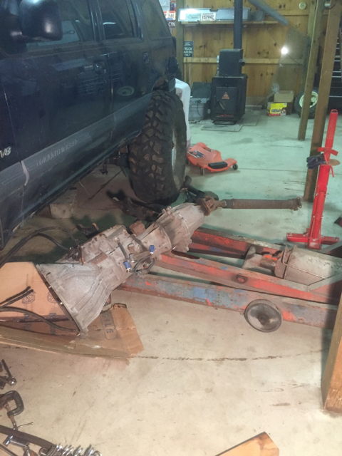

Finally posting this.
The 4R70W is on its way to the West coast. Excuse the last minute crating with materials I had in the truck.
1999 5.0L Mountaineer Build - SAS with Tons
The 4R70W vs a SBF ZF5. I think it should go in nicely.
