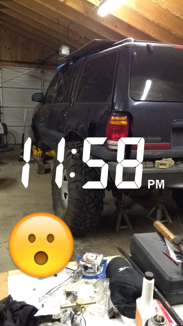

Going to move the axle back a few inches to avoid cutting too much out of the door. This is the height I want to be at depending on how I can get the front to work.

I actually touched this thing Thursday night. I think that puts me at 6 hours of wrenching on it this year? Bummer.
Nothing exciting but posting anyways.

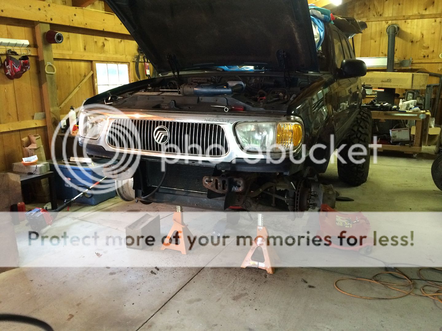

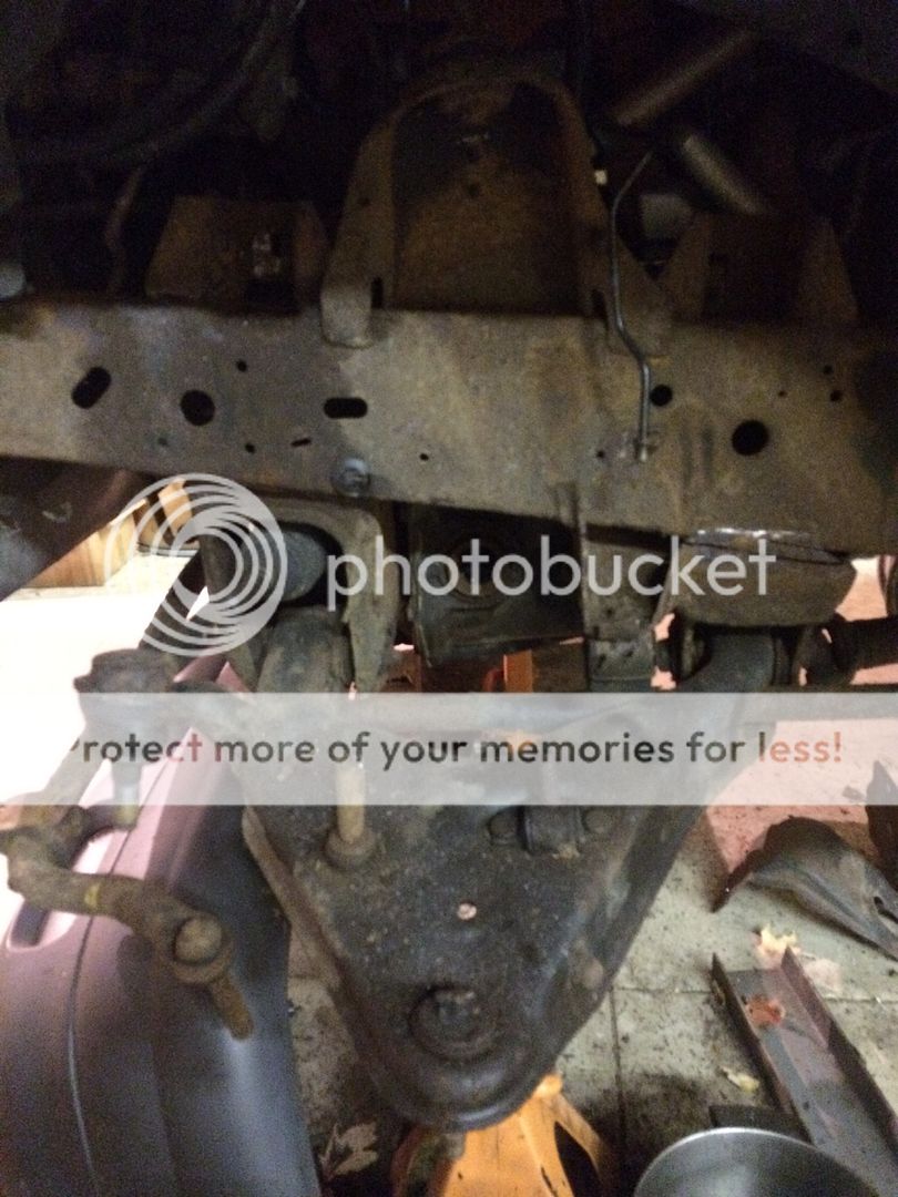

Pulled the front bumper. Welded some bracing across the frame that isn't shown. I attempted to remove the IFS via a reciprocating saw without disassembling the IFS. Decided its faster to disassemble then cut.
1999 5.0L Mountaineer Build - SAS with Tons
One side is apart...

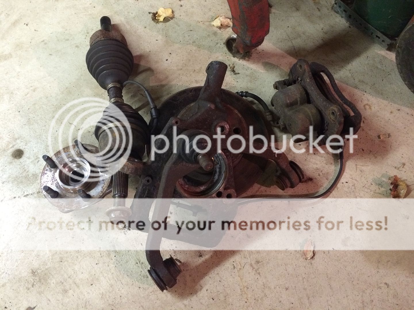

This is the first IFS vehicle I have worked on where the upper arm was easily removed. Go figure since I am cutting it up...
