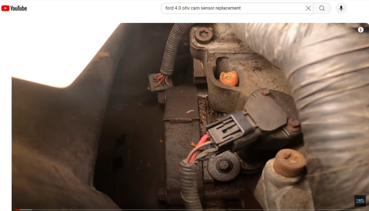

BUT: Where are the darn sensors??? None of my manuals show where they are located, and I can't find 'em.
Please help! Where are they located? Bank 1 is the passenger side, right? But I'm darned if I can spot where the sensor is. Does anyone have a photo or diagram?

Where Google fails... try Youtube!
Found it. TRQ has a video on replacing the cam sensor on Youtube for 1993-1997 Ford Ranger 4.0 engines. Even though mine is a 1999 the sensor is in the same place. Back of the engine near the firewall.
I checked and sure enough I had not plugged my sensor back in. Plugged it in and all is good!
Posting so other dummies like myself can find the sensors.
