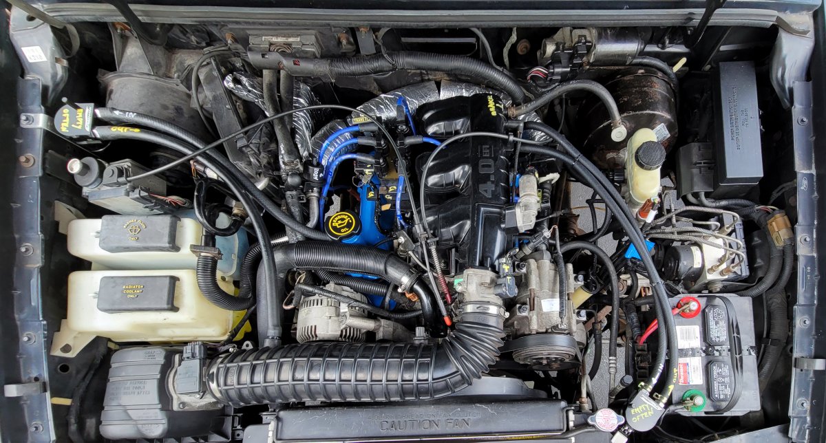

Update 8/20/2024:
I decided to go with two cans:

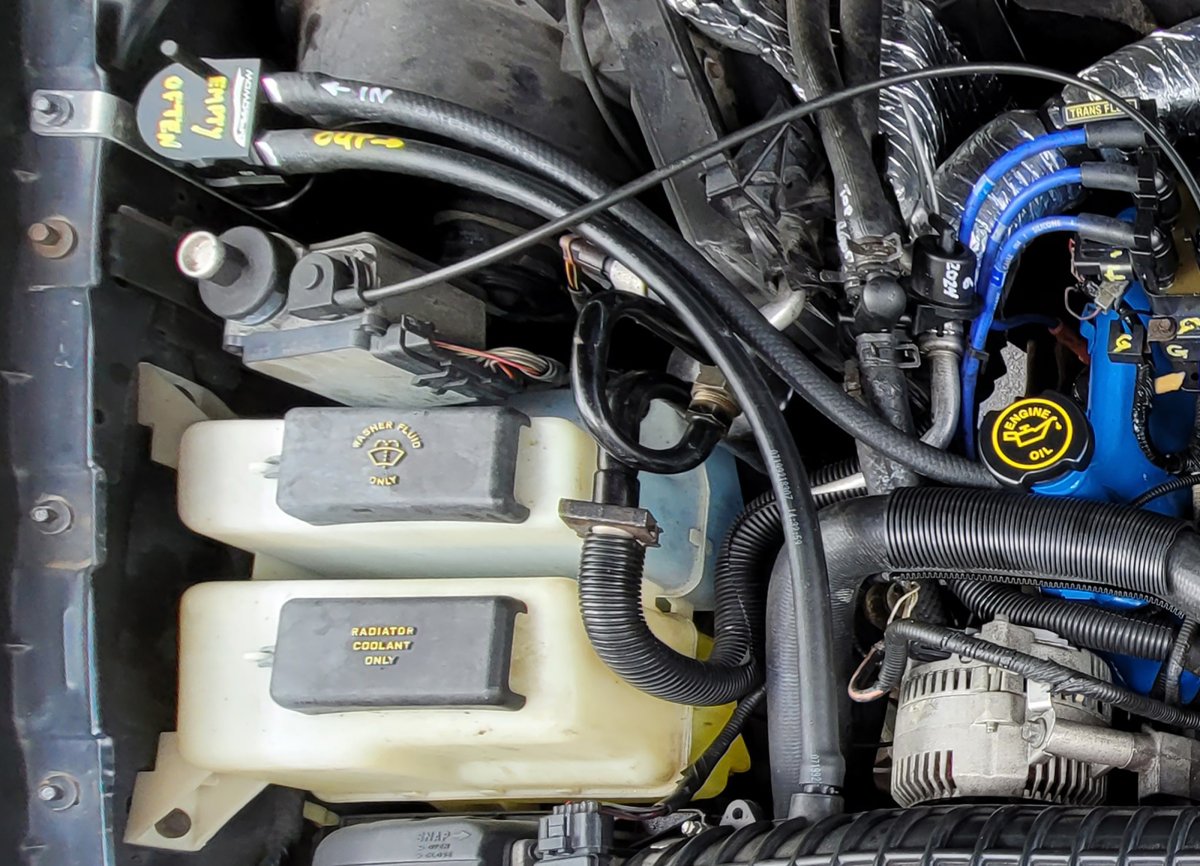

Placed the first one (from passenger's side valve cover to intake snorkel) on the side of the engine compartment, using the supplied bracket and an existing bolt just under the hood. I'll have to remove the bolt to get this one open. Not ideal, so will puzzle on this for a time.

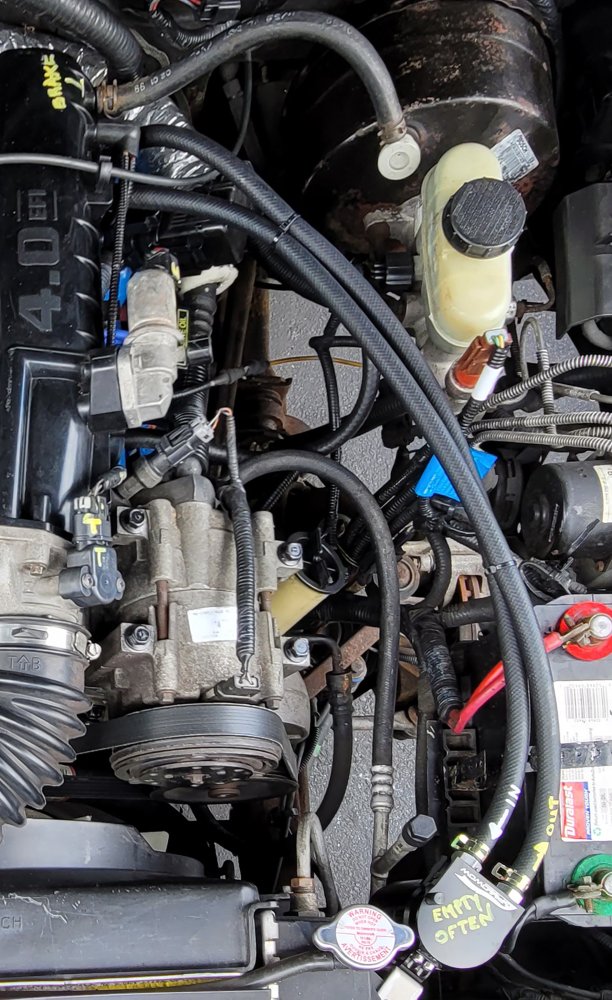

Placed the second one (from drivers side valve cover PCV to intake manifold) up front on the plastic radiator mount. Drilled a hole in the mount and used the supplied aluminum bracket and a stainless steel nut and bolt.

Looks good! I don’t remember mine coming with any mounting brackets. Glad they do now!
The new ones came with a decent quality hose too! Good fit for the driver's side. But had to buy 1/2 inch hose for the passenger side.
