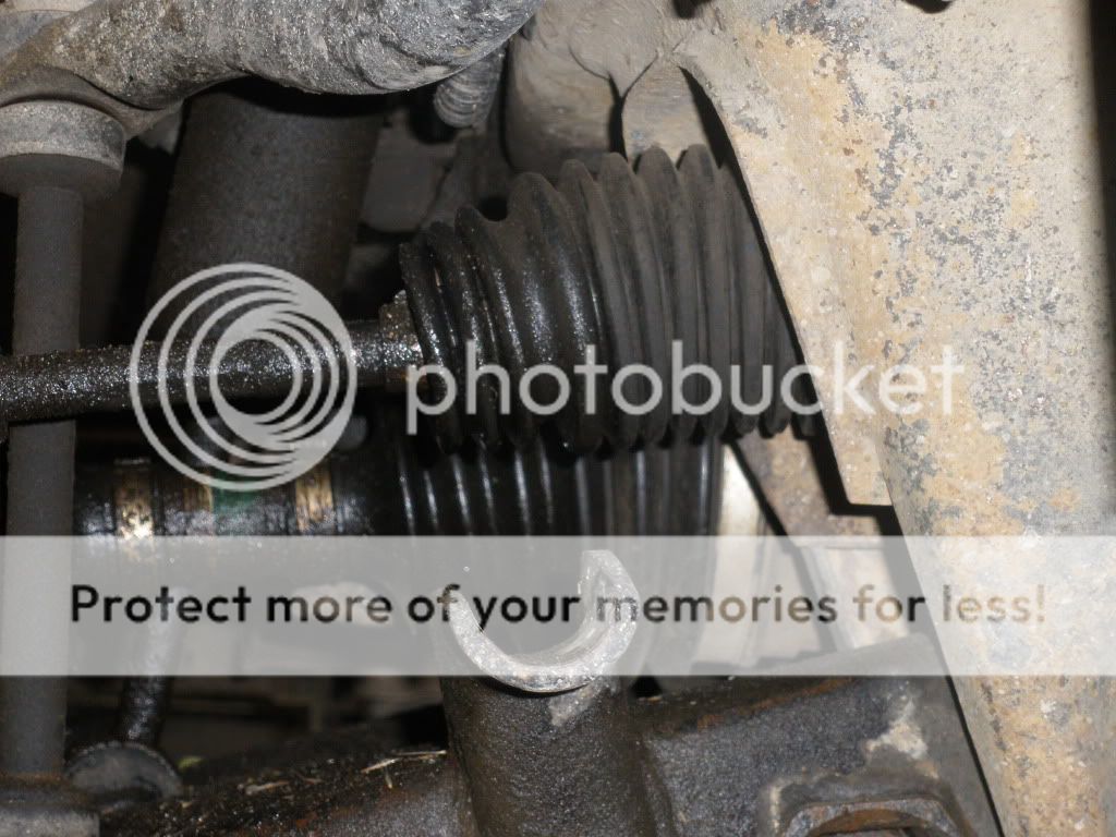

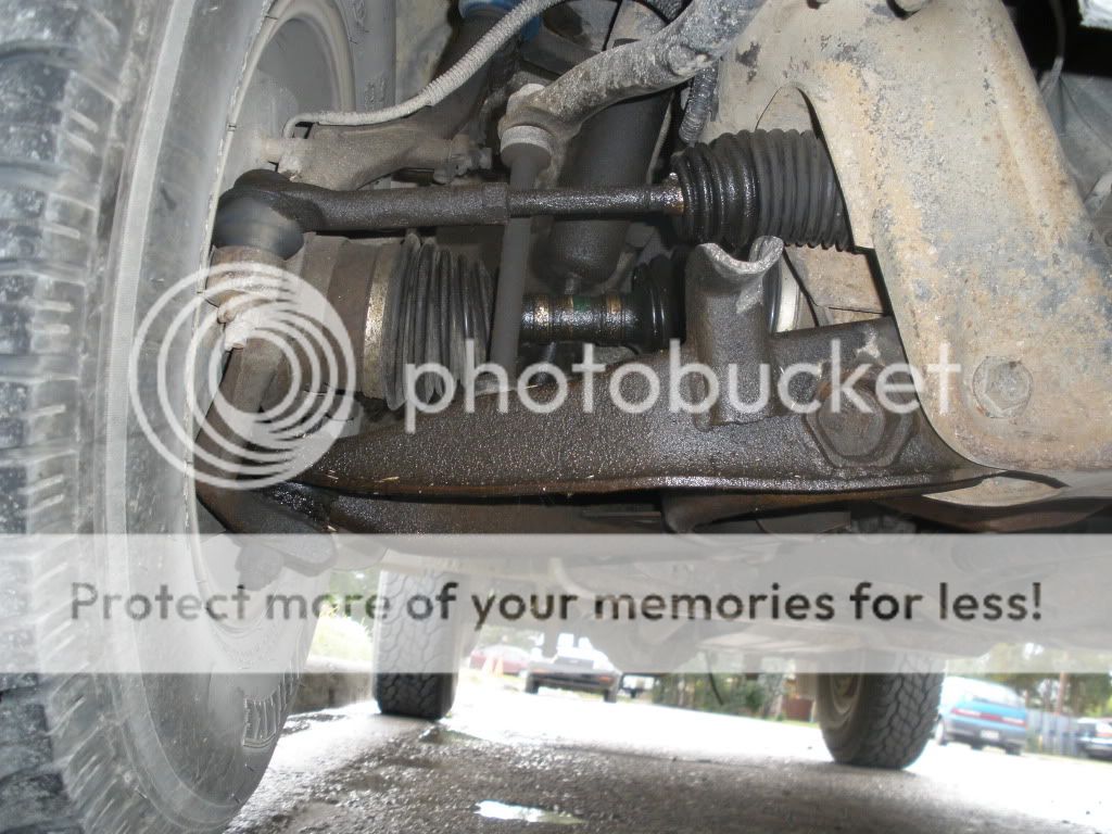

I'm also going to get the small shop to check out a leak on the passengers side A-arm. It appears to be power steering fluid. I've noticed many other Rangers of this generation (both 2WD and 4WD) with the passenger's side A-arm wet. Anybody else have this problem or know what it might be? You can see it in these two pics.

Where's it wet? Get a picture actually on the passenger side.
I'll grab a much better pic of the front end tommorrow but if you look on the passenger side A-arm it is darker than sub-frame. The driver's side A-arm is dry and light like the diff support crossmember but the passenger's side is all wet and darker. THe hole thing is covered in what appears to be power steering fluid coming out of the tie rod boot. ???.
So far on maybe 80% of 98-00 Ranger I've seen have been like that so I was wondering if it is a known problem point.
http://www.fordforums.com/f279/2000-ranger-power-steering-leak-58903/
Mine isn't that bad but it is the same issue. I'll grab a picture as soon as I can.
Hows your power steering fluid? Have you checked it to see if it's low at all? I have crap on my a-arms that look like fluids but it's just from working on it using pb blaster and wd-40 and crap like that and not wiping it off. I've never used dye in power steering before but i'm sure they make some. That's probably one of the best ways to see if you have a leak or not. I'd take off the passenger side wheel and take a closer look.

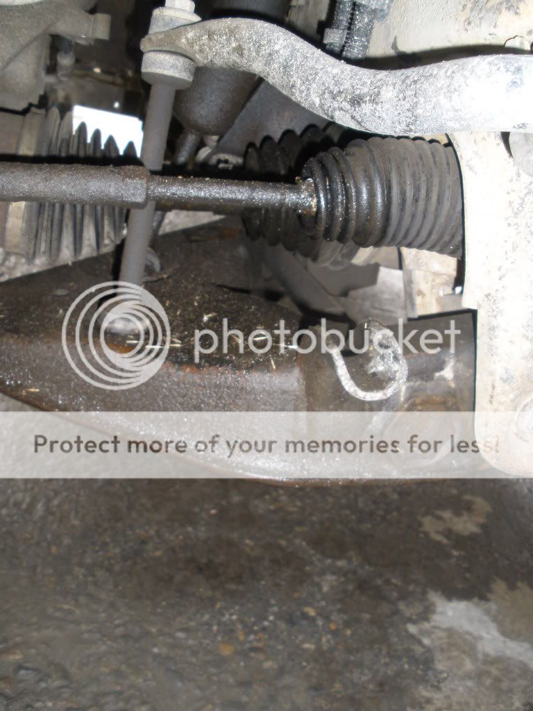

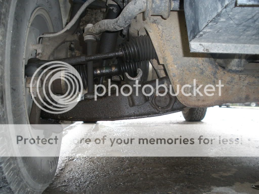

Here are some pics of the front end.
