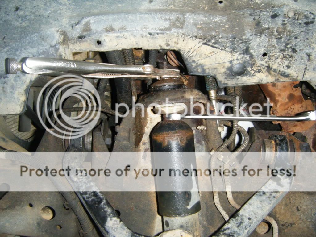

Hopefully you don't have the original shocks like I do. Here's what I had to do to get the nuts off:
Yeah Tom I had a brain fart there, I thought it was one of the weird still 4x4's with the T-Case mounted to the tunnel. Like I said, 'Brain Fart' lol. As for the shocks I think I'm gonna have to do that, I bought a can of Liquid Wrench and another of WD!
The passenger side came off after about 20 minutes with the correct wrench. When I got to the drivers side it was coming off and then one slip and I busted my knuckles and rounded off the head. If you have the original shocks, the top nut that the vise-grips are on in my pic is a 13mm wrench. The wrench holding the lower nut is 18mm if I remember correctly. If not it's a 15mm. The two nuts on the lower shock mount are 12 or 13mm aswell.
