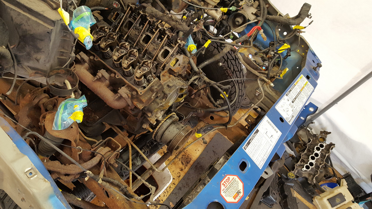

This is my 1998 Ranger 4x4 restoration build that I have been working on since March. This was my first vehicle that I bought over 15 years ago now. The previous summer I lost oil pressure on the highway and before I could pull over and shutdown, the motor was seized. Since this truck has a truck load of sentimental value I decided to do a full restoration on it.
I hope you guys enjoy.

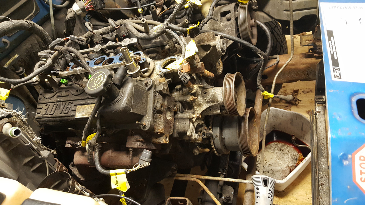

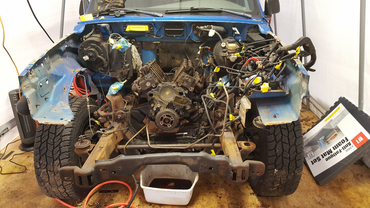

This was the start of the tear down process. The truck was tired and needed some loving

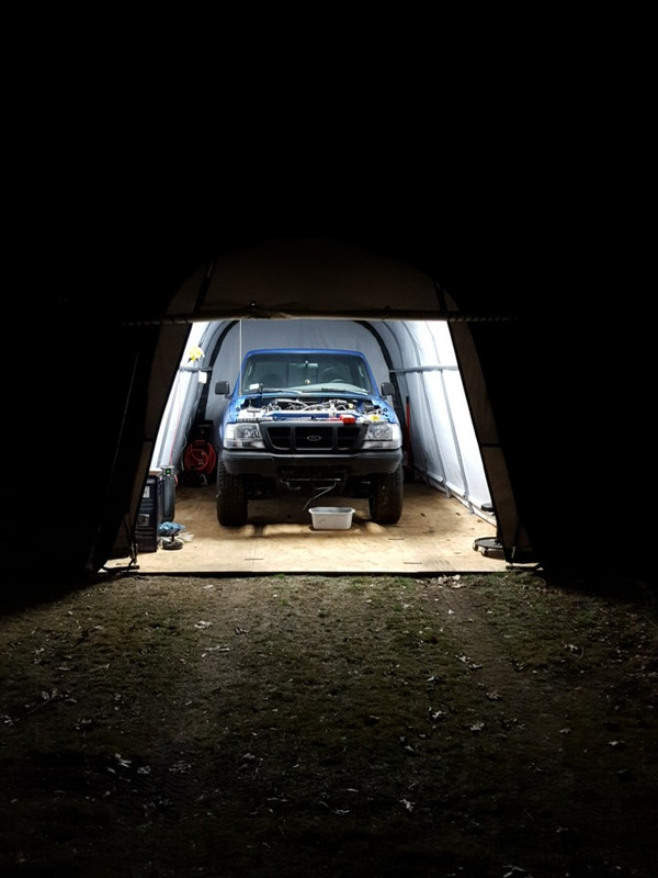

What size tarp shed are you working in? How did you put the floor together?
Looking forward to your progress.
The garage is a 12' x 20' that I bought from Northern Tool. The floor is 3/4" plywood that I waterproofed with Thompson water seal and screwed together with strapping that I cut into 8" brackets and painted so they wouldn't rust. Considering it only cost me about $600 total, I've really been able to do some good things in there.

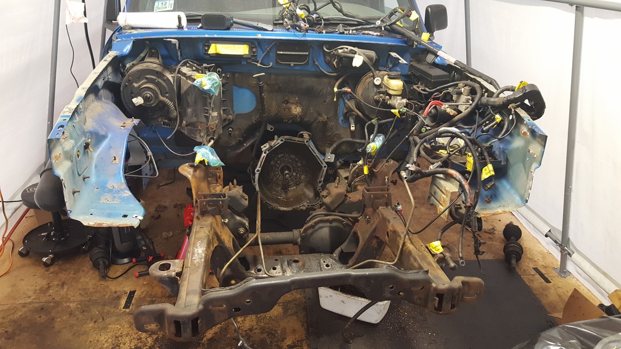

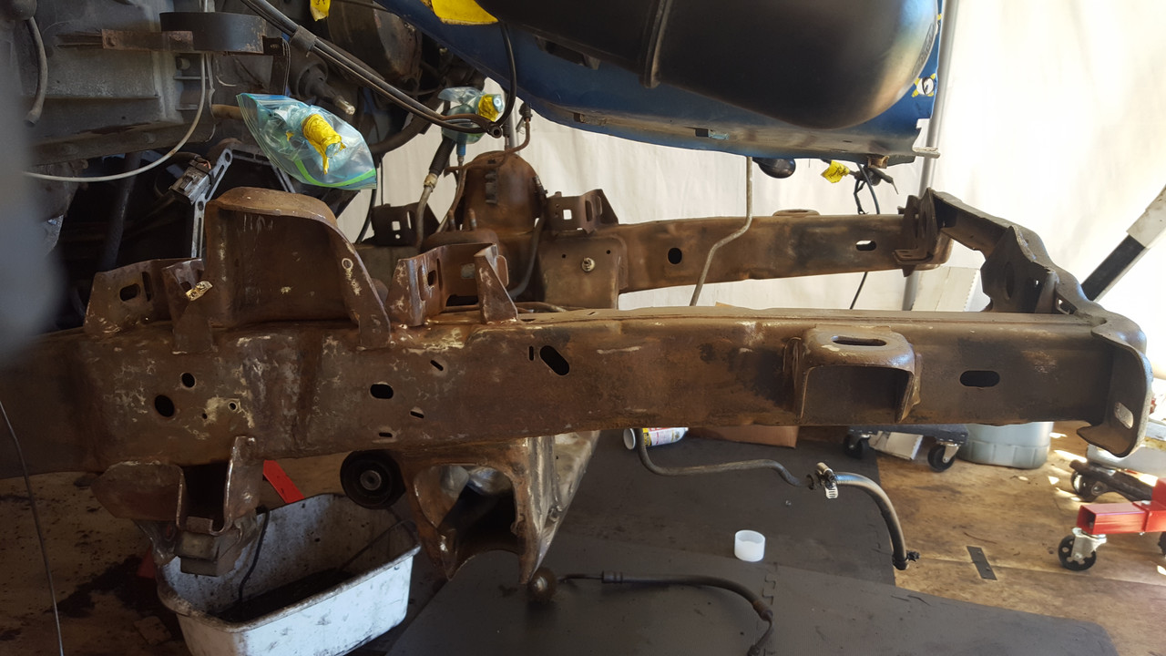

The suspension was a mess and the 4 wheel drive no longer worked. All the vacuum lines for the hubs were rotted away. I converted over to live axles and sealed hubs from an explorer with help from the tech article on this forum :icon_thumby:
