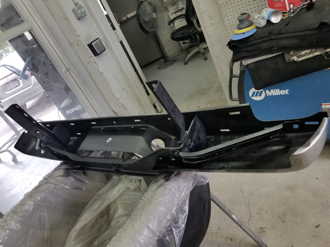

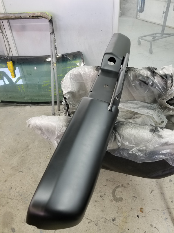

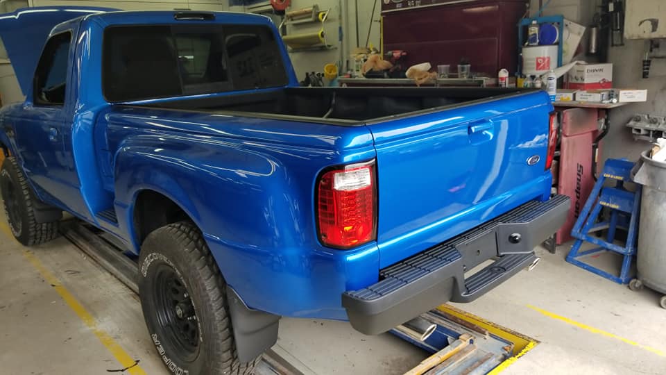

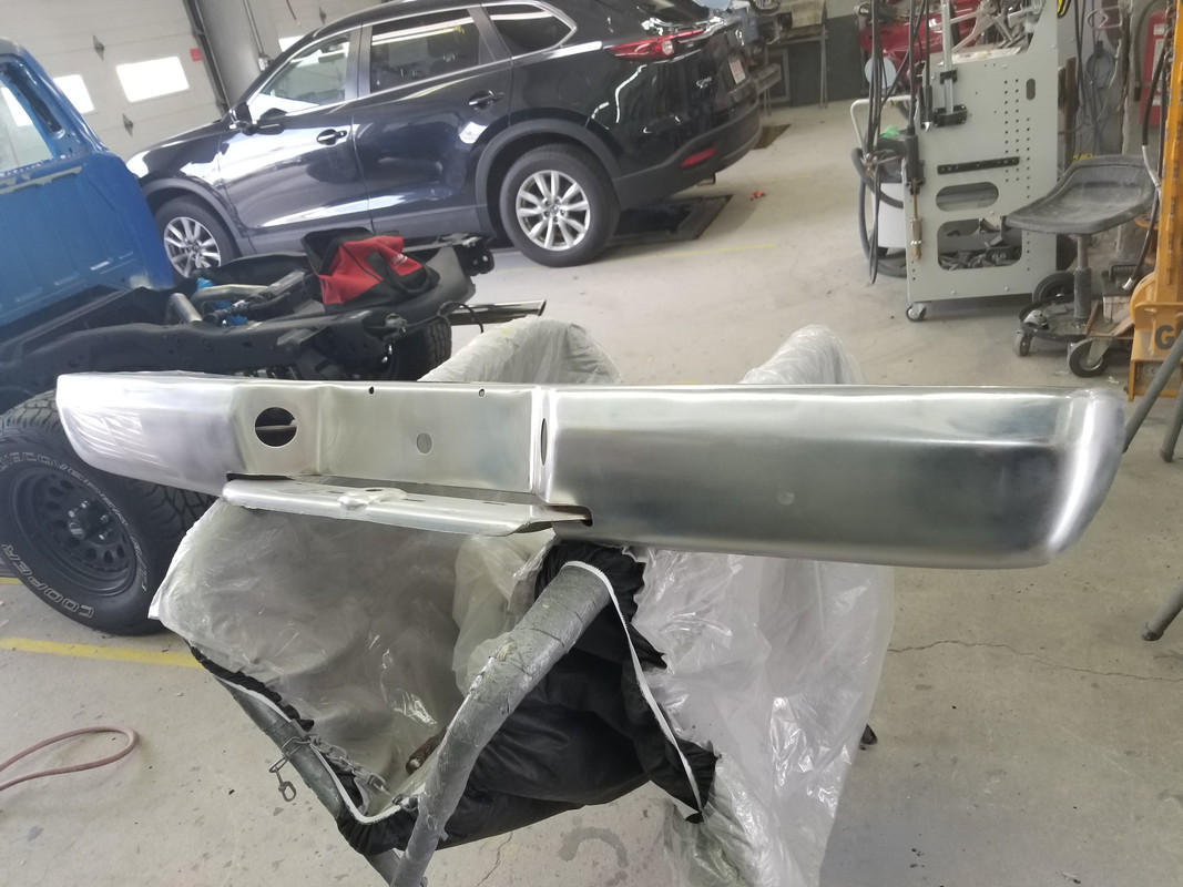

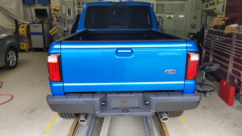

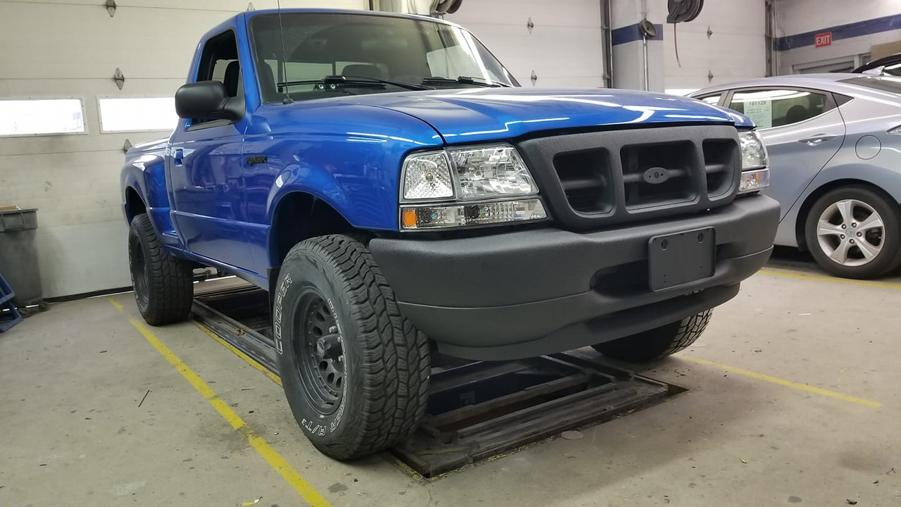

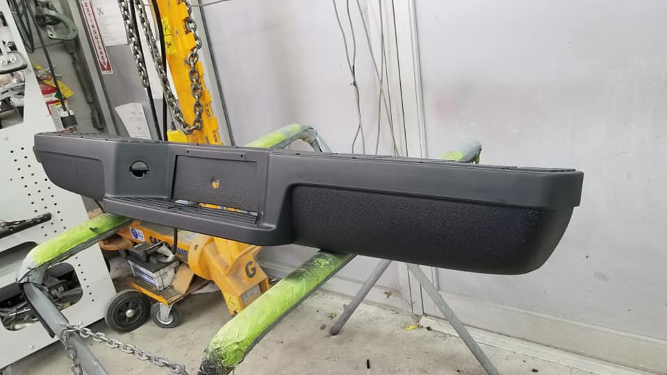

I decided to reuse my factory chrome rear bumper and just change the color to match the theme of the truck. I scuffed the F**k out of it with grey scuff pads and shot it with SEM self etching primer. The grille, front and rear bumpers were then sprayed with U-Pol Raptor bed liner. I had in process photos of that but I had a phone crash and lost a few photos. :dunno:

Looks factory fresh!

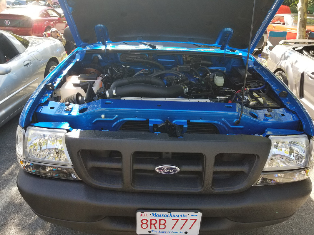

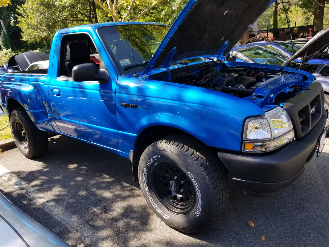

I had to cancel on at least 3 pre-registered shows trying to get this thing finished up. It wanted to fight me every step of the way the last 2 months. I ended up having to pull my transmission for a 3rd time and have it rebuilt a second time. :mad::mad::mad: It's the only part on the truck I didn't do myself and it bit me in the ass hard. Fortunately it is now fixed correctly and like butter. I had to go through like 3 gallons of brake fluid before I was able to get all the air out of the system. Of course as soon as I took it on the road for the first time the check engine light popped on with code P1309. After setting and resetting the camshaft syncro multiple times and 2 weeks of head pounding frustration I figured out that the OEM harmonic balancer that I put on had the timing marks etched in the wrong position so it was off by 3 degrees. WTF Ford!

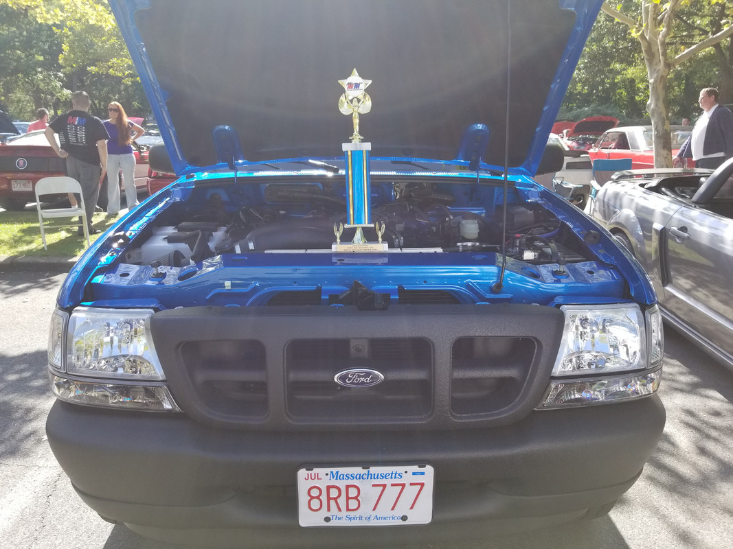

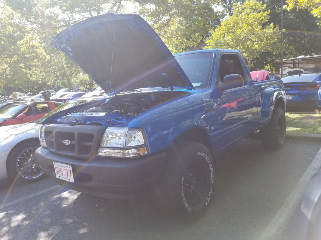

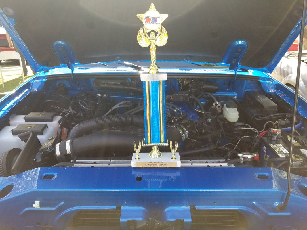

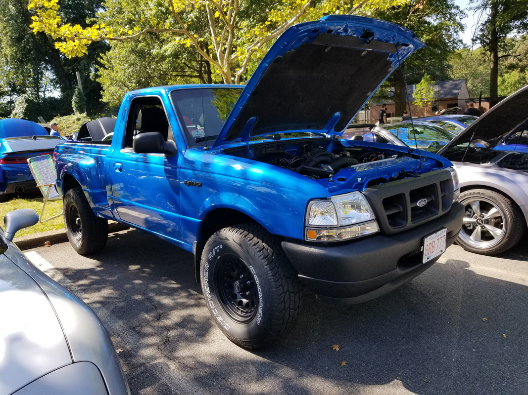

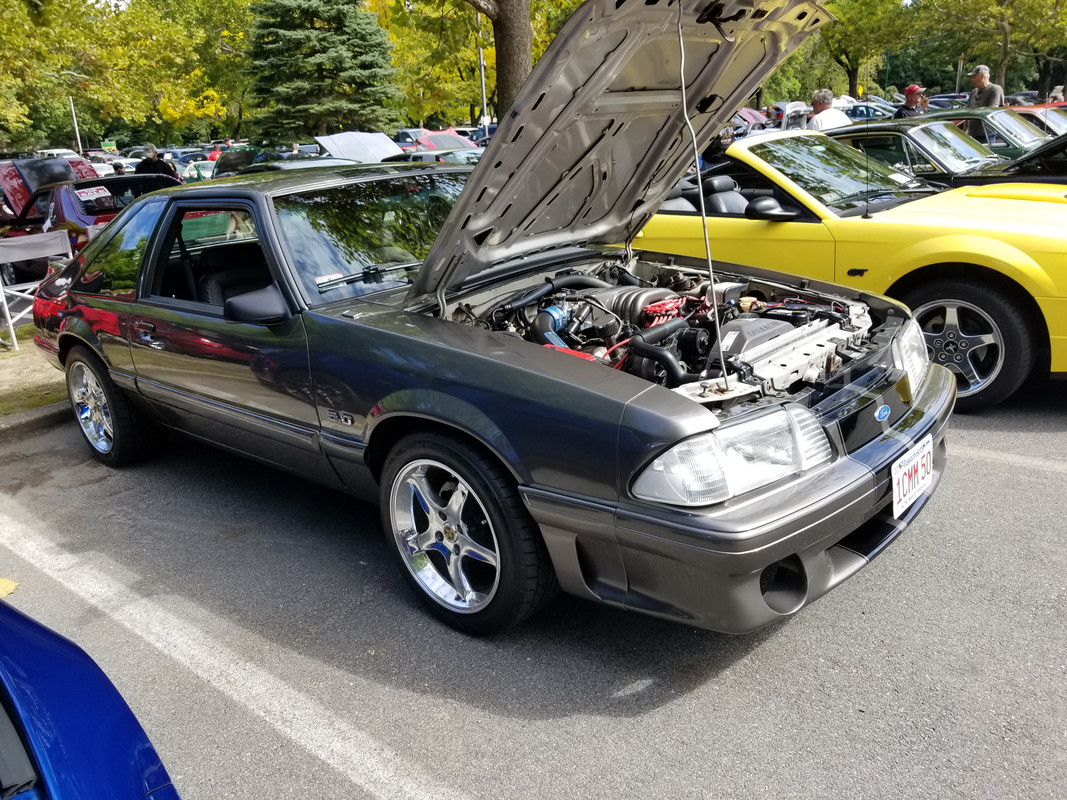

Anyways I was able to get into it's first car show along with my 1991 LX Mustang a few weeks back and holy sh*t I took home second place in the daily driver class. I couldn't believe it. :icon_surprised:
Wow nice build.man I love it. How many hp do you think your rebuilt 3.0 has? Could you feel a difference in power?

That trophy is well deserved. Good job brother.
