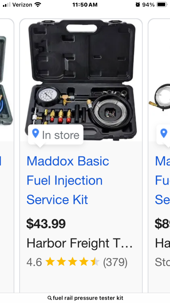

I was just debating if I should get a fuel rail pressure test kit. I found this one at Harbor freight for a reasonable price.
I’m looking for feedback, but again, I think my injectors are fouled. If I put this fuel tester on the Schrader valve on the fuel rail, that will tell me what the pressure is before the injector, but that won’t tell me if my injectors are fouled. Yes/no?
I’m never opposed to buying new tools, they will all go to my son in a few years, but I’m not sure if this will tell me about my problem.
OTC Tools 5630: Fuel Pressure Test Kit 0-100 psi - JEGS https://share.google/6ZiDdKjQRTSFyLmiz
I bought that one a year or two ago.
I'll just say this...
Checking for proper fuel pressure is a must for nearly every drivablity issue. It's also the easiest test to do. It may not tell you what is wrong... but it can positively tell you what it isn't.
