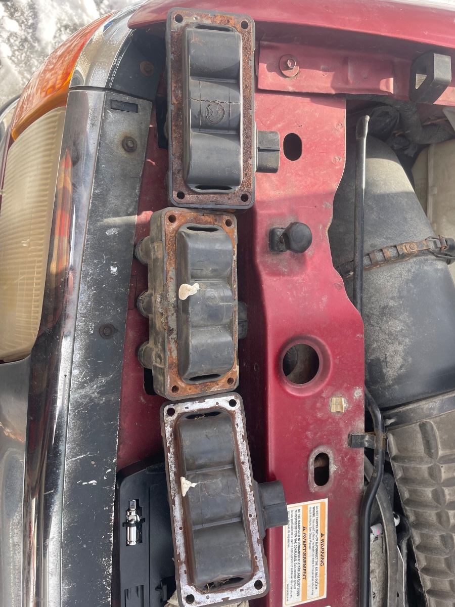

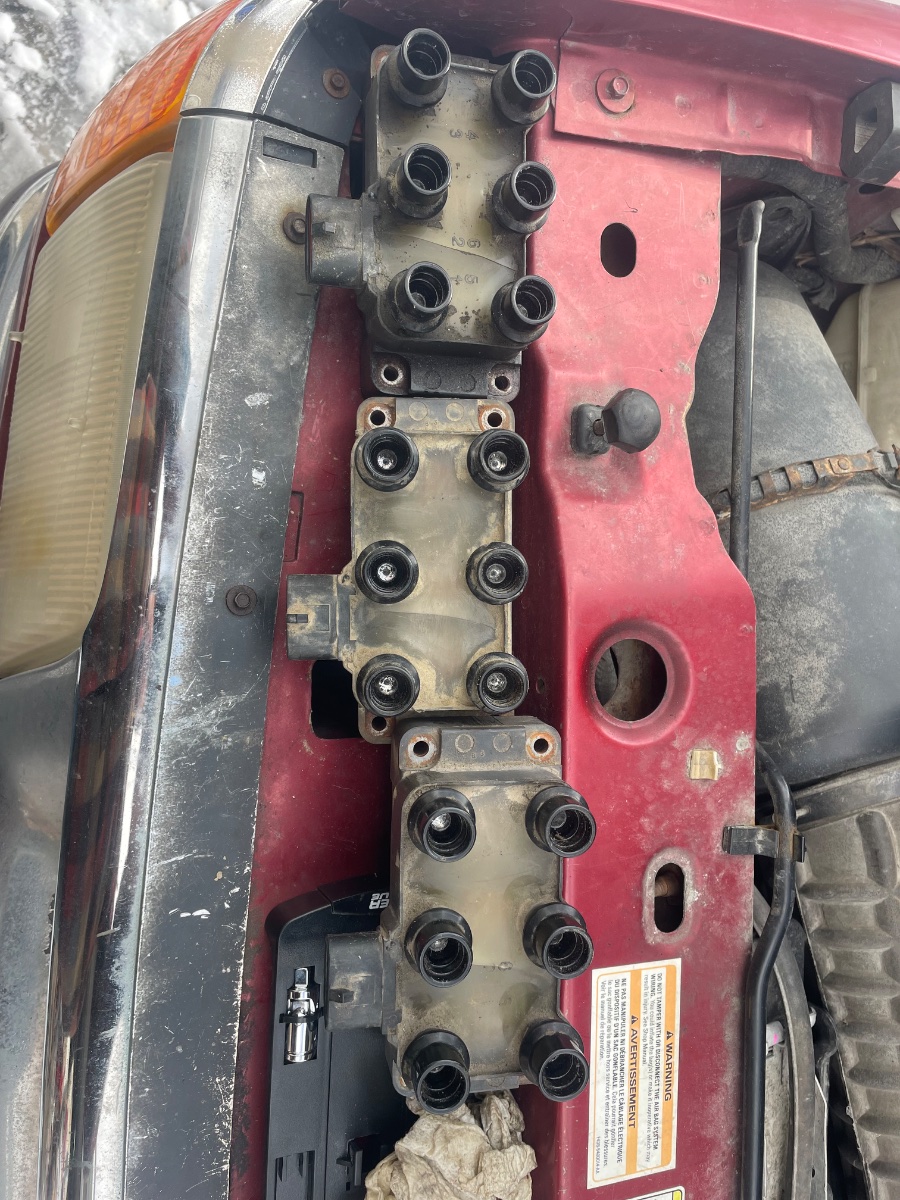

On going problem. This truck has destroyed 3 ignition coils. Middle coil for cylinder 2&6. Blows the interior 25amp fuse. Put a coil on it, seems to run for a short period, then runs rough, drops power then shortly after blows the 25 amp interior fuse. Before I put this last on on I changed plugs and wires. Blew 2 different ignition coils before I changed plugs and wires.
I’m at a loss what is causing the short or resistance. It’s been always the middle coil gets destroyed. I have ohmed them before and after.

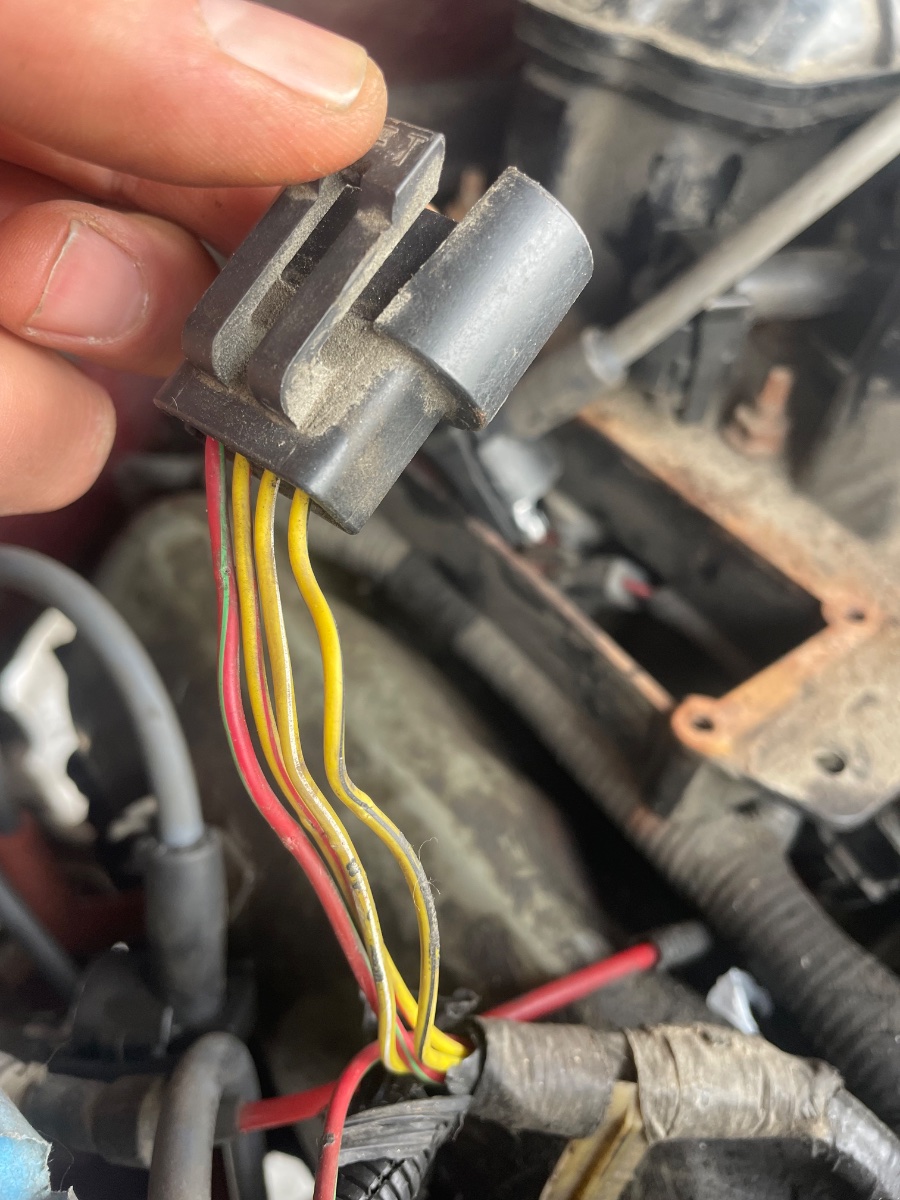

For the plug in, the red/light green puts power to it. I’m assuming the yellow/red is coil 3/4 cylinders, yellow/white 2/6 cylinders, yellow/brown (or black) is coil for cylinders 1/5. Where does wire yellow/white go? I’m beginning to think I have a short in that.

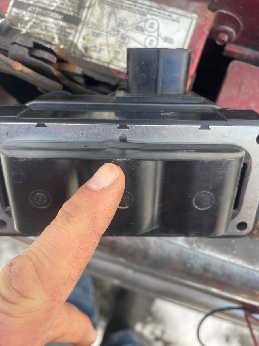

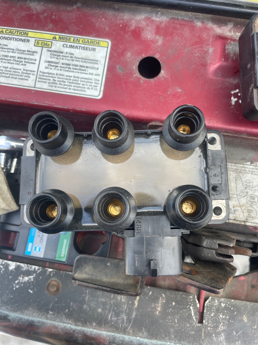

Also after the first 2 I guess stock or original equipment coils cracked, I bought a Blue Streak. Truck was running good for I’ll guess 50-100 miles then yesterday same missing low power then blew 25 amp fuse. Only this coil didn’t crack and all 3 coil packs ohm just under 12k which is what the were before. I had another original equipment one I put on, replaced fuse. I ohmed it and all 3 were in the 12k range. It started but running rough. Drove it 25 feet into parking spot in front of my garage and quit. Blew fuse and destroyed middle coil.
Actually it may have started to destroy the blue streak one. I just noticed a split in the plastic on the bottom. But like I said still ohms good and no cracks on the top

Check the pins on the trucks connector. If a wire got hot, it could have lost some tension in the female pin in the connector. Maybe cut a pin off one of your bad coils and see how it feels in each pin of the connector.

Do the yellow wires go to the ecm? I want to check the yellow/white wire to see if there’s any issues with it
I feel like the pcm signal wire for the middle coil is grounding out some where
I checked the wires with an ohm meter from the coil plug in to the pcm and they all seemed similar .11 - .06. I checked my 95 and had similar readings,

I think I figured that nightmare out. It seems to be the middle coil trigger wire, yellow with white stripe was grounded in the harness somewhere. I cut it and bypassed it and seems to be running fine now.
I had ohmed the wires initially and all had similar values. This afternoon I again unplugged it from the coil and from the pcm. Then ran ground into the coil plug for each yellow wire, hooked test light to the positive post on battery. Probed each wire. When I had the yellow white in a completed circuit it would light up. The yellow/red and yellow/black didn’t light up as expected. But the yellow/white would always trigger the light when it shouldn’t have when testing the other two. That took long enough.
