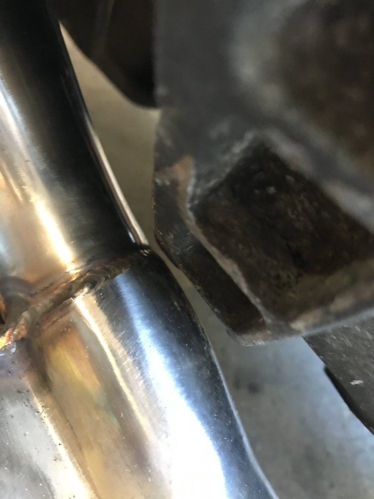

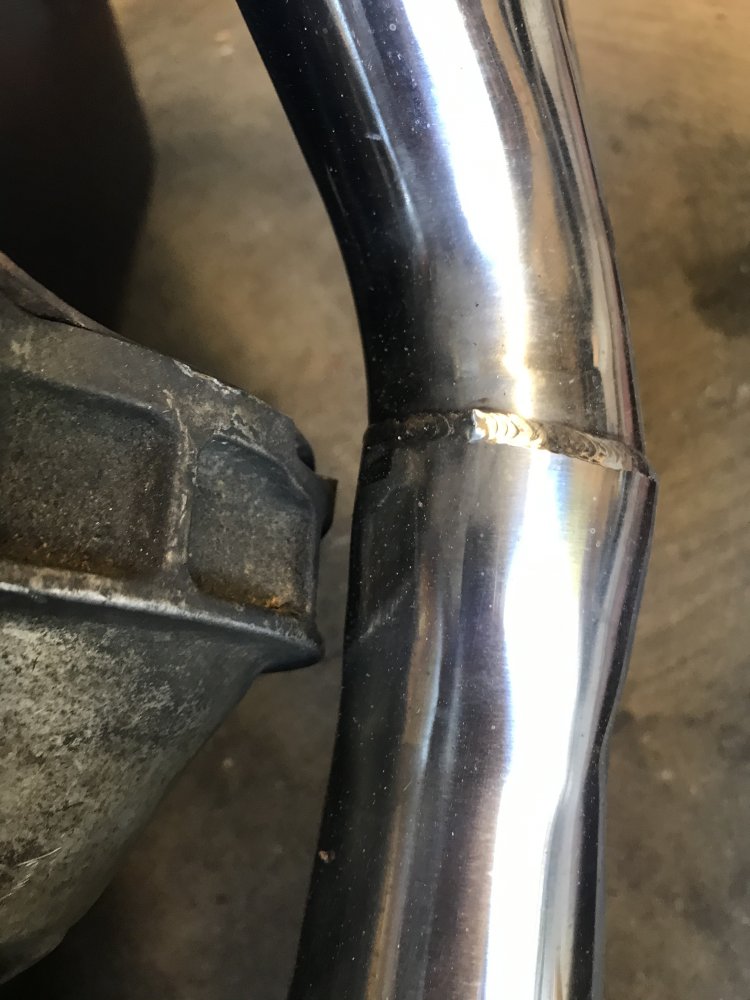

I think they fit in without cutting the frame the problem you are going to run into is the Tri Ys wont fit around the M5OD-R2 trans (164 tooth bellhousing) from what Ive read with out modifying the potion of the pipe near the collector.

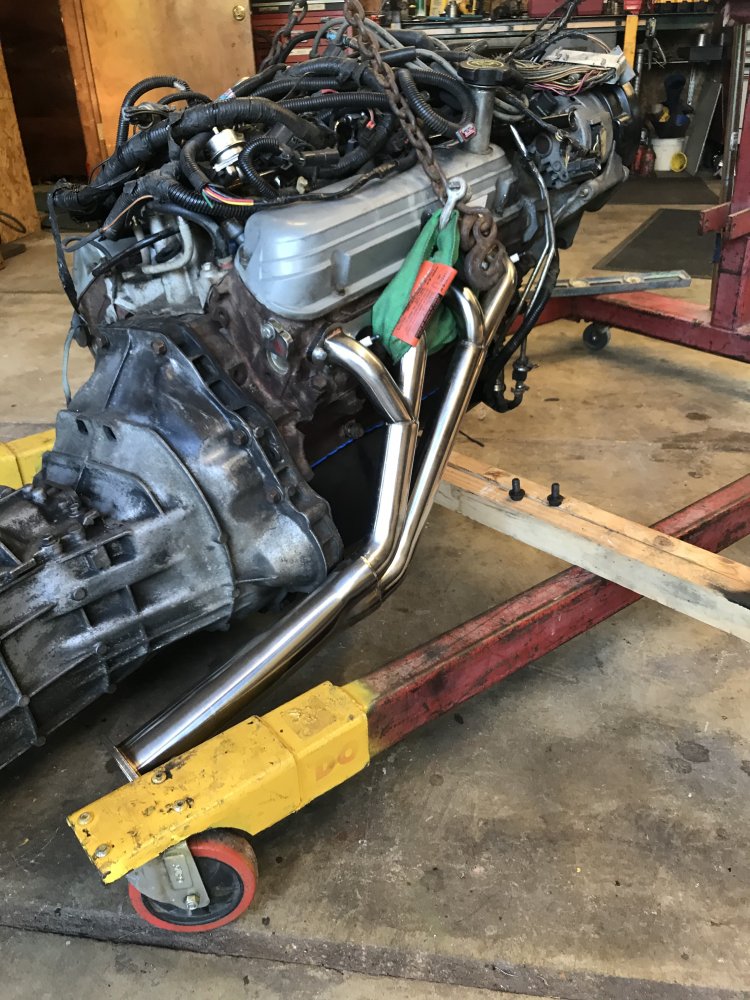

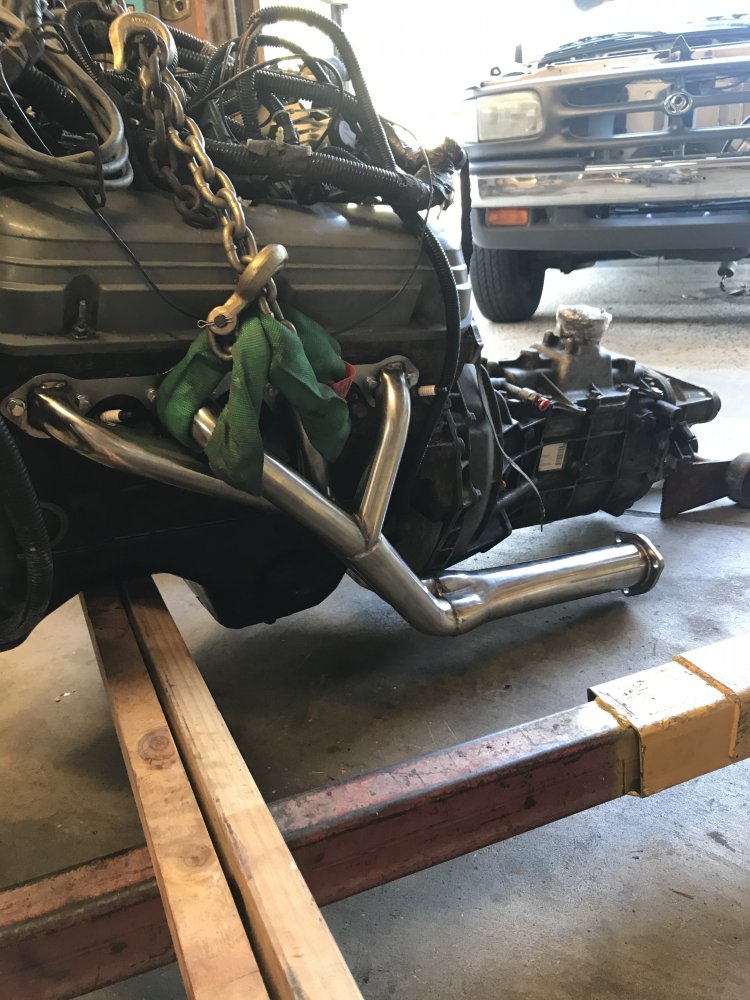

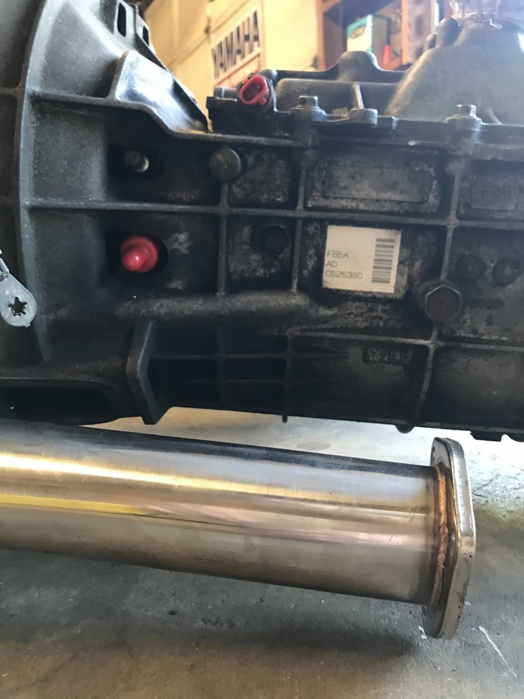

I gotta say the tri-y headers are tight to the engine, these are great! My Dad and I had to bend the pipe out a little bit maybe 1/4in, not even, on both sides to clear the 164 tooth bell housing. These look like they flow a lot better than the stock 93 mustang ones. I will post pictures soon to show how they fit in my 97‘ b2300

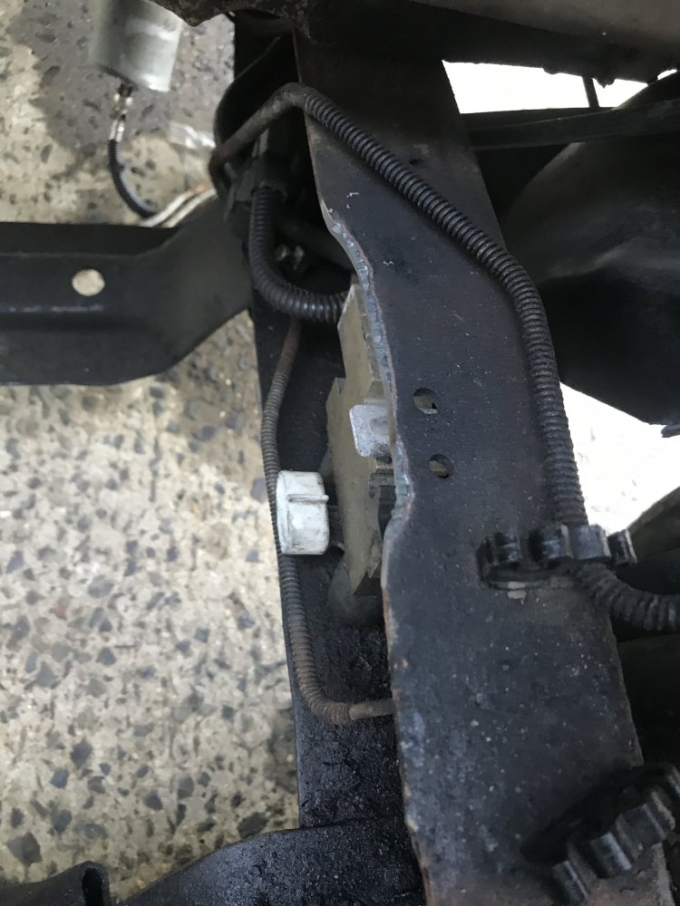

The other concern I had with those headers is the M5OD-R2 used a cheap plastic line for the slave cylinder and I thought it would interfere.

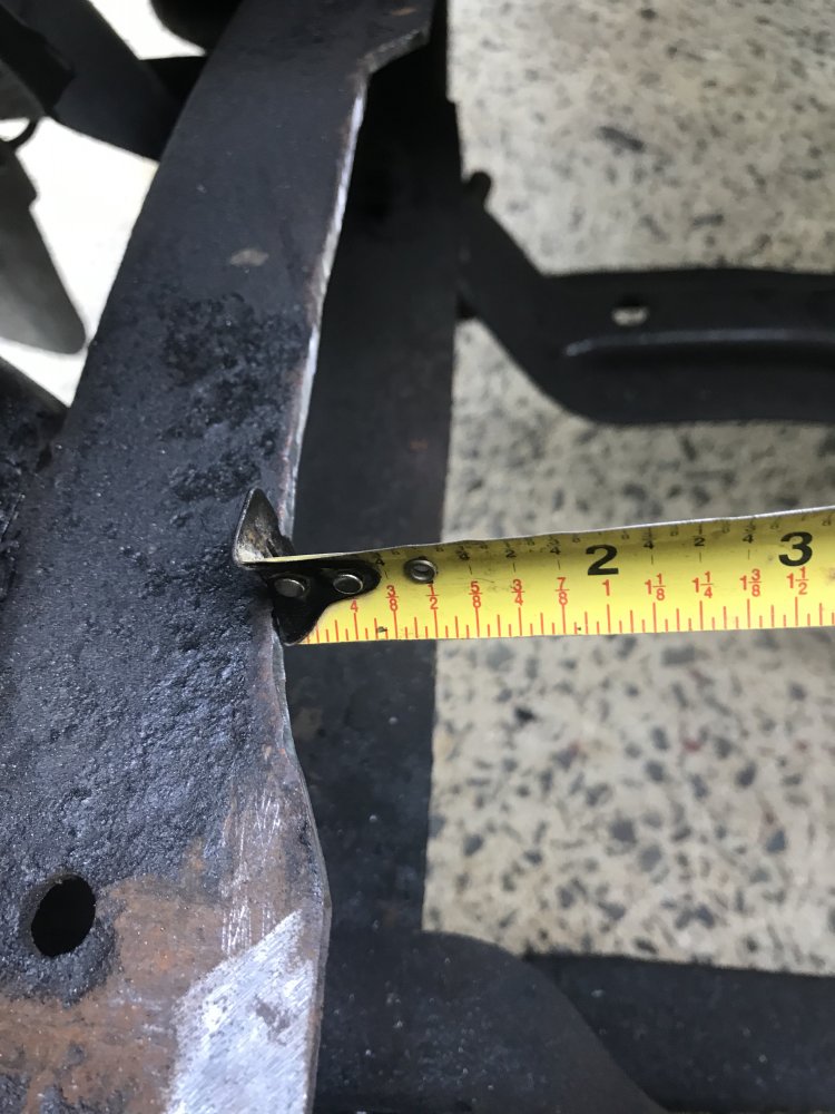

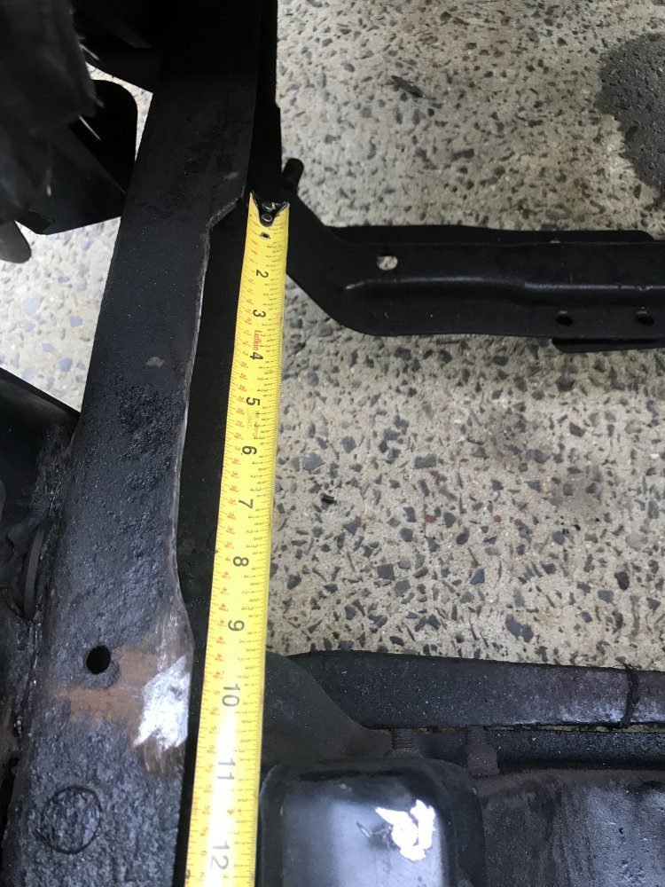

I see what you mean by the slave cylinder line. I’m probably going to be wrapping the header with wrap and I may actually put a heat shield up by the fuel filter and space line to be extra cautious of everything. But here is what the fitment looks like on the engine out of the truck because I’m buttoning some things up in the engine bay before I permanently drop this thing in. And I posted pictures of the 97’ b2300 2wd engine bay so you can see where I notched the frame with a plasma cutter. This took about 2 mins to do. The engine in the bay actually has a lot of room. I did not have to modify the heater core plastic box as the valve covers on the 93 mustang 302 did not really come close to it. I will post pictures of the engine actually in and the clearances in the transmission tunnel and engine bay with the fuel lines and slave lines and such soon too

Wrapping them is a wise decision....
Brake lines can boil....
