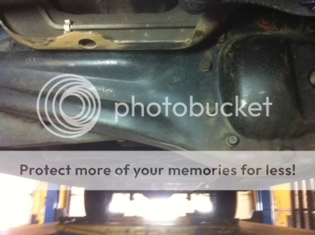

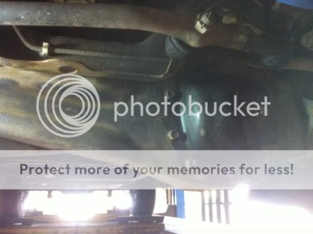

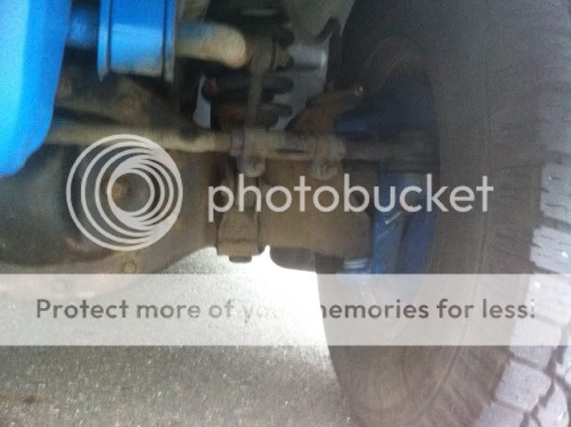

Two, after my poorly timed discovery last night, I took out a little frustration by cleaning the front axle a bit.

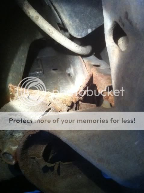

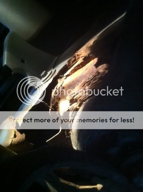

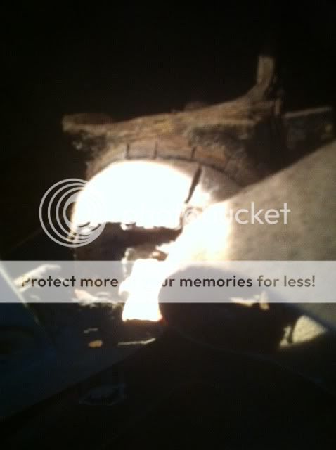

Third.... the bad news.
1994 Ranger - starting small

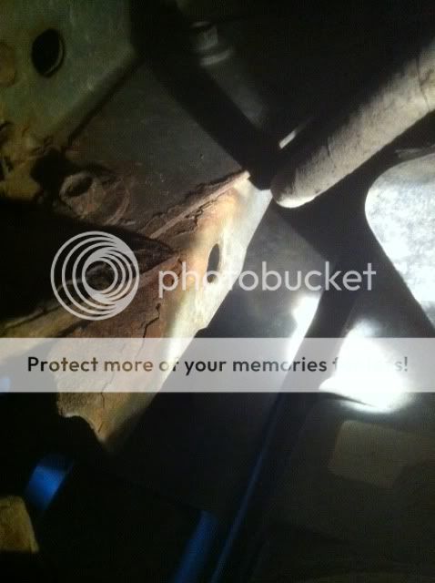

All the other body mounts are rusted out pretty bad. So, I'll be ordering a polyurethane set for that, a new radiator mount, and if I'm lucky, new brackets for the front body mounts. If not, I'll be looking into getting those fabricated.
In addition, also found a rust patch on the passenger side end of the frame, so that'll need to be patched, as there's a decent hole in it.

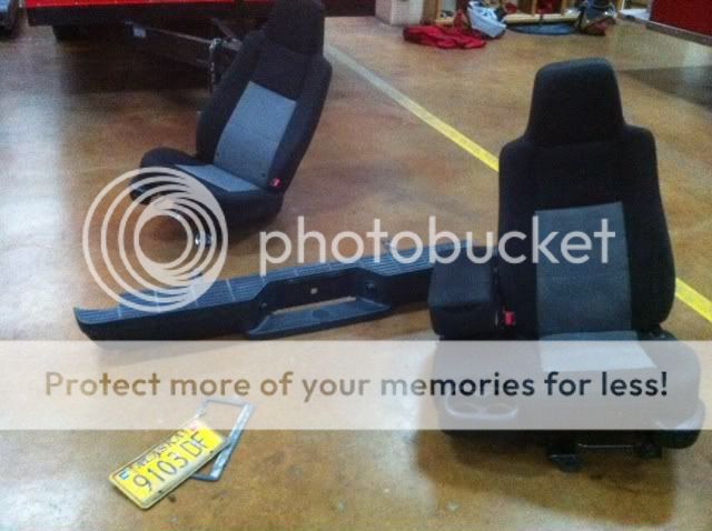

hey idk if you already answered this question but what year/modeldid you get these seats from? much appreciated

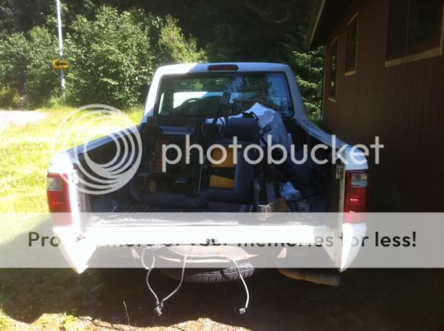

So, leaf springs did not get pulled yesterday. Somehow, I ended up helping a buddy hunt for a air compressor instead. But, I've made some progress on the parts truck.
From this...
To this:
Got a guy who's coming to take the exhaust system today, and when I'm all done stripping the truck of things I want, the guy who wants the motor is going to tow it away. Awesome! Saves me a hundred bucks plus tow costs, and he gets the 2.3 he wants.

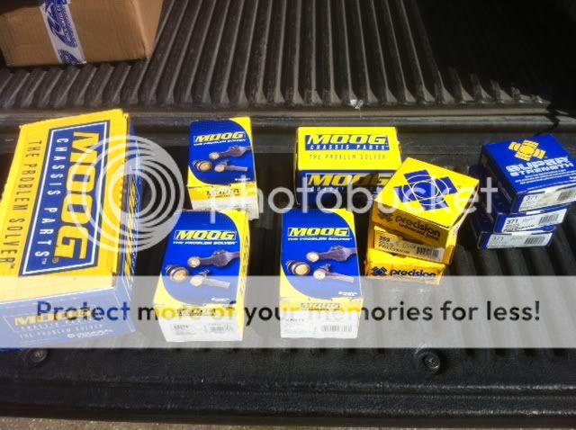

My parts came in!

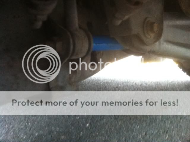

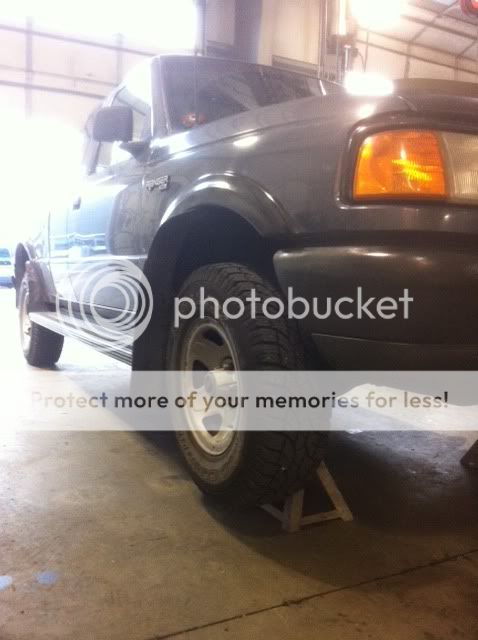

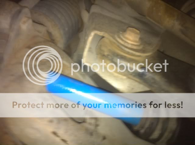

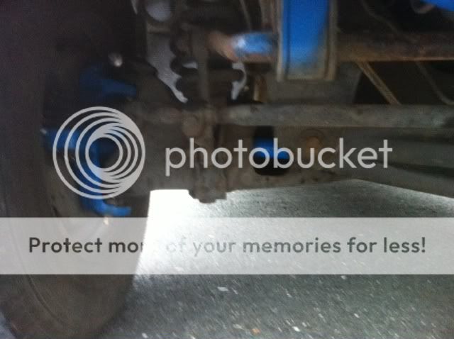

Adam decided he wanted to paint-to-match lol. Since our schedules are totally opposite, he's currently got the truck, and we're putting things on one side at a time. As of now, drivers side is a go!

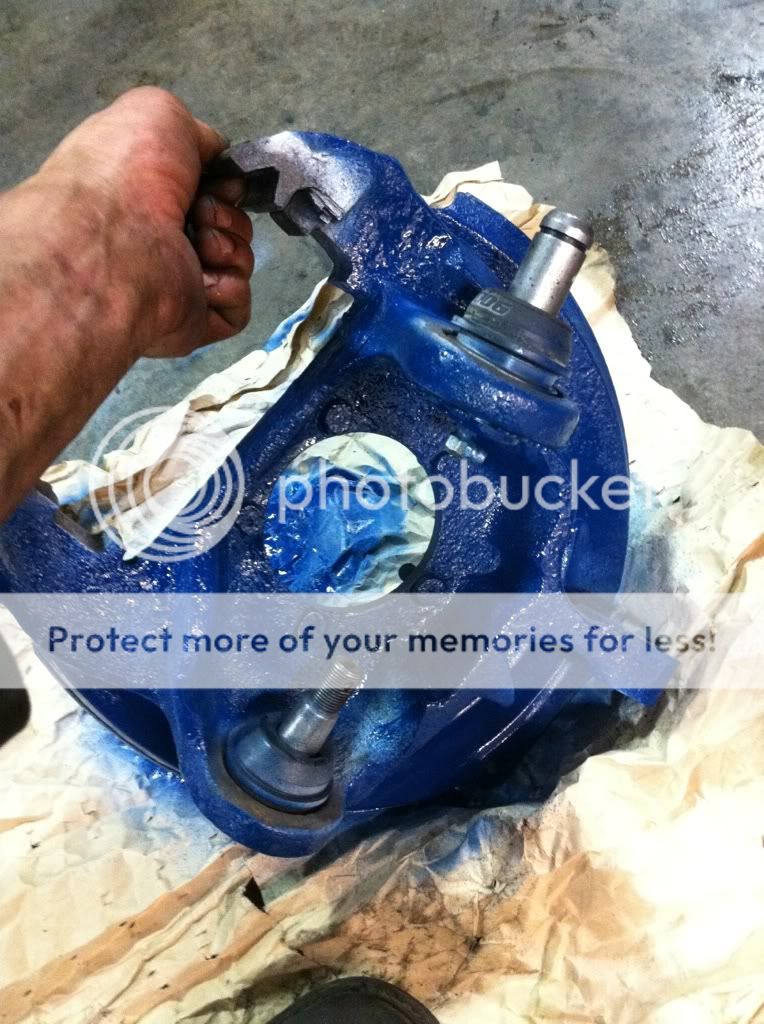

So, after a frustrating long weekend, the ball joints and u joints are finally in. It seemed like everything piled up this week to make it impossible to get to the truck, but Saturday night came and it barely got it done.
I don't have any pictures of the installation process, because I unfortunately wasn't there. It ended up being a "drop the truck off and borrow someones car" night, because shit met the fan in other areas.
But, Adam held true and did some more paint to match. On top of that, he got rid of my let-off-the-brakes clunk.
And a blue axle shaft to boot. :)

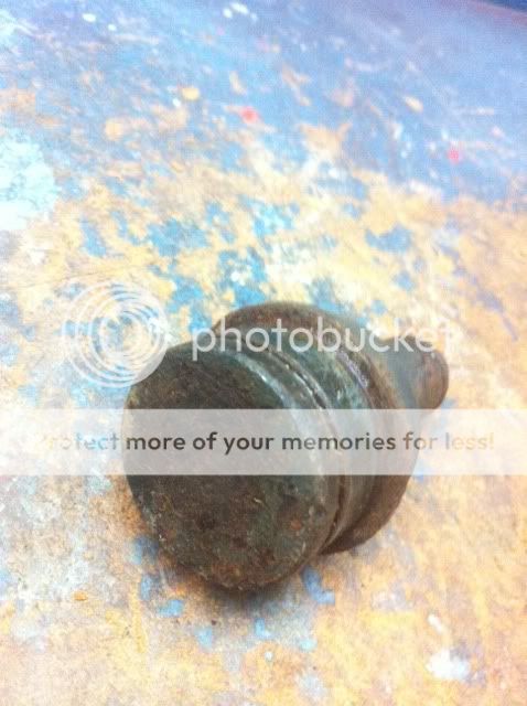

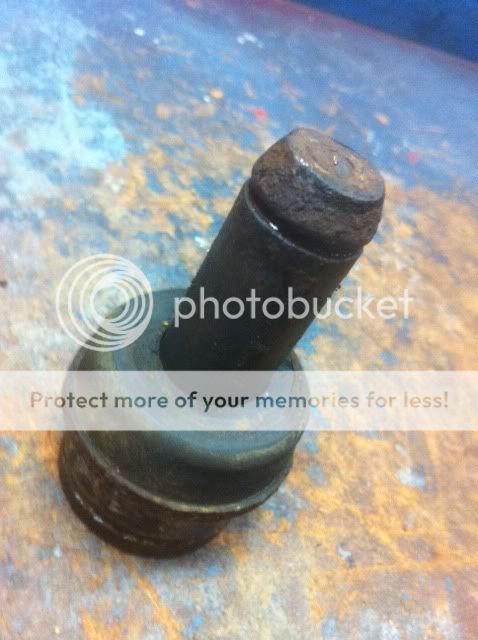

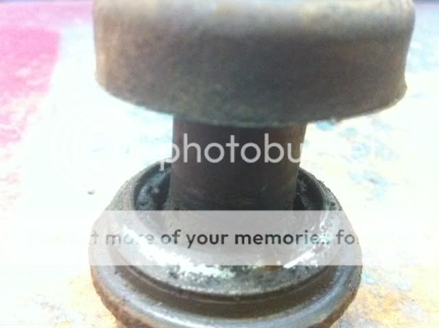

I've got one of the old ball joints in the bed of my truck. I'll get a picture of it later, just for comparison purposes.

Ball joint

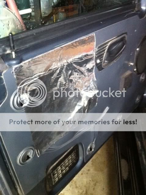

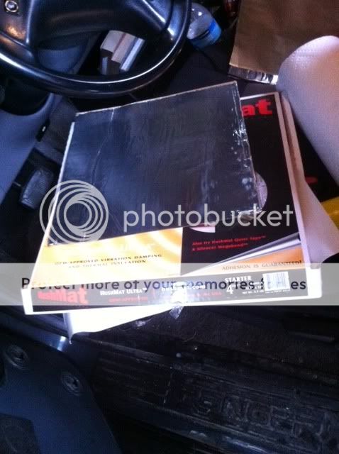

So, I decided that the road noise had bothered me for the last time, and went in search of sound insulation.
Apparently no one in town has heard of such a thing.
I finally tracked some down at SS Sounds (who have turned out to be very helpful and tolerant today - particularly when I came in near closing, forgot my wallet, and had to come back).

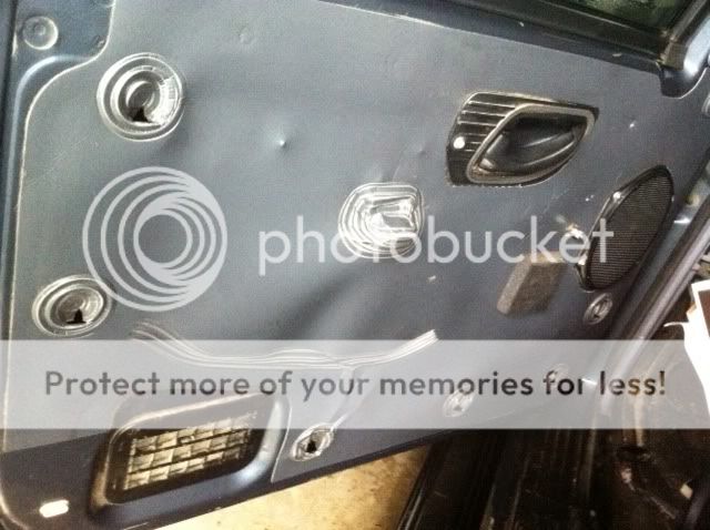

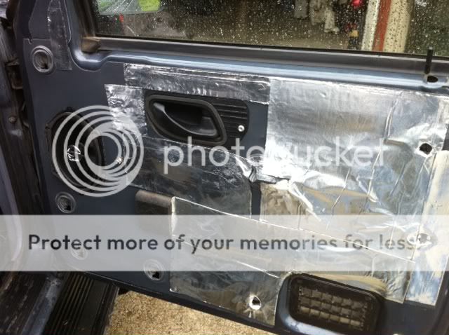

So, I pulled off the door panel on the drivers side. In retrospect, I should have started with the passenger side first (I drove around several times picking up things I'd forgotten)
This is the only sound deadener I could find. It was about 60 bucks for 6 square feet, and I ended up using 3 sq ft per door.

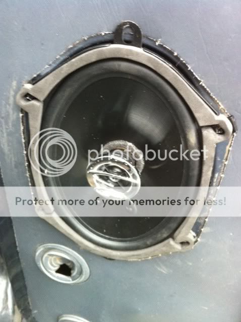

Decided that while I had the door panel off, I should replace the crappy stock speakers.
