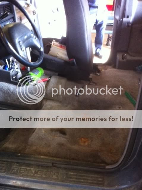

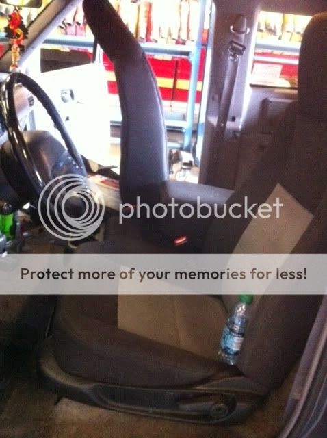

Got the seats in!
...three days ago.
But, computer access at work has been hazy, so pictures are just coming up now.

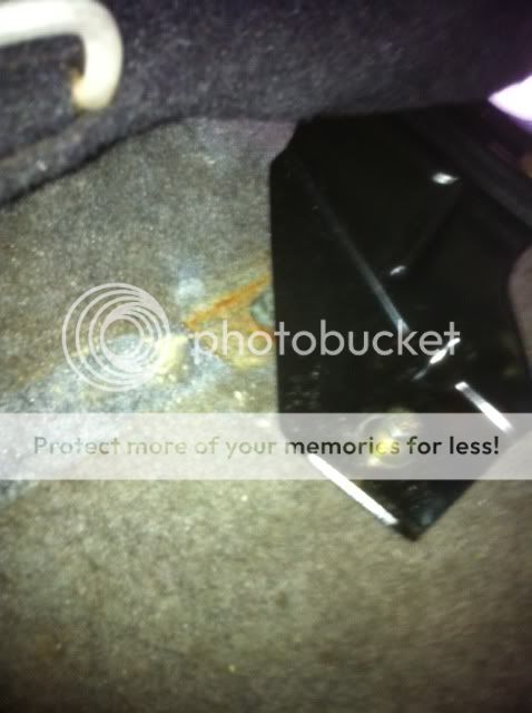

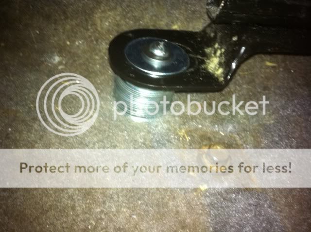

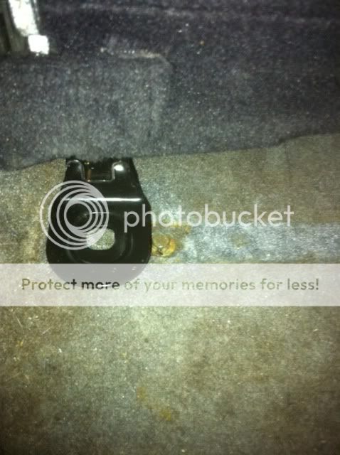

I decided to do one seat at a time, rather than both seats in one go. And it was a good thing I did, because the front bolts went in just fine, but the backs were completely off!
After drilling to fit, they worked great. They are a little bit taller than the 94 seats, though...
But, I guess from a 2004 single cab, I can't complain with how they work.
Drilling through carpet wasn't the best idea ever.
Bolted in!
And, ultimately, the ghetto-rigging. But, if it works, it works!

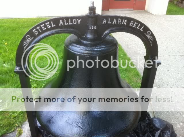

The other day, I found the only place in town that sells POR15! So, I bought one of the starter kits, to try out how it work. Turns out, my Chief wanted the bell in front of the station painted, so I got to try it on something that wasn't my truck.

Nice work, those seats look good. I like your ingenuity if you need to fill in the old holes 44 claiber bullet shells work great.

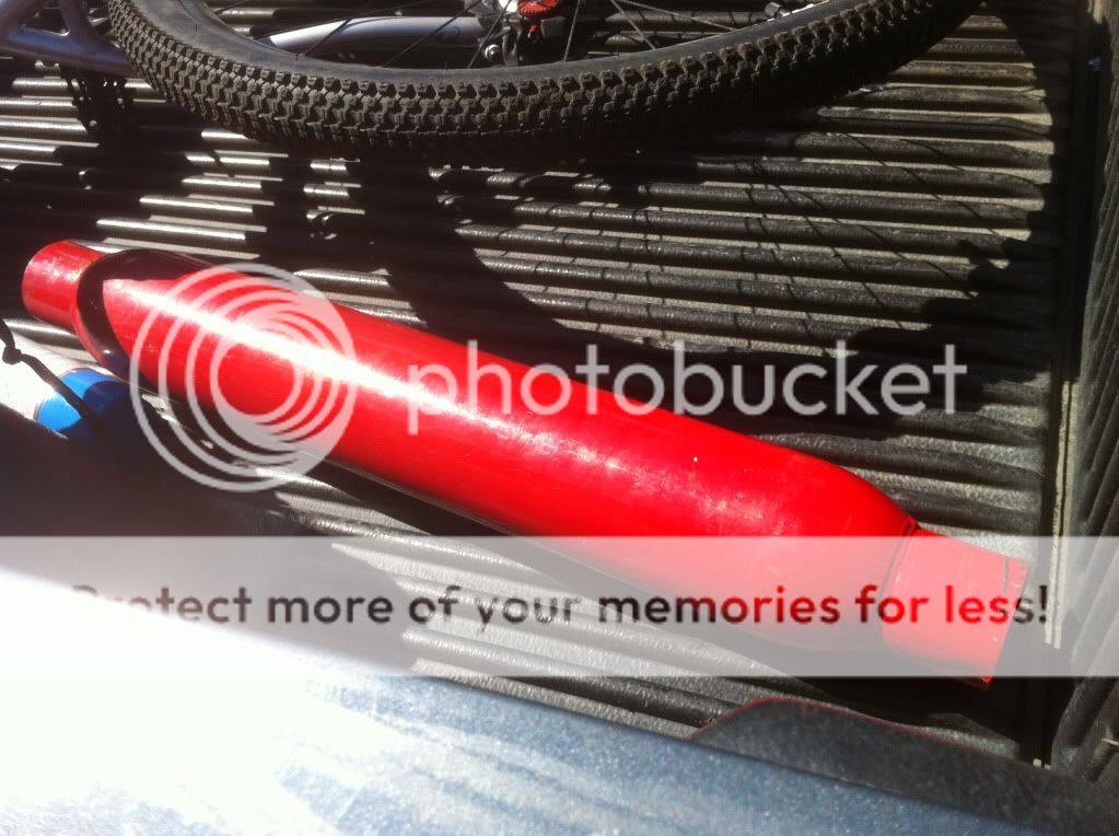

On the plus side, I picked up a cherrybomb muffler for free the other day. I have no idea how loud it is, what type or anything, and I'm not sold on putting it on my truck yet, but the idea is certainly there.
I had a cherrybomb on my old truck it was streight pipe to the cherrybomb then streight out I like it gave it a louder deeper tone I think. What kind of bike you got? I see avid disc brakes and Kenda tires!
