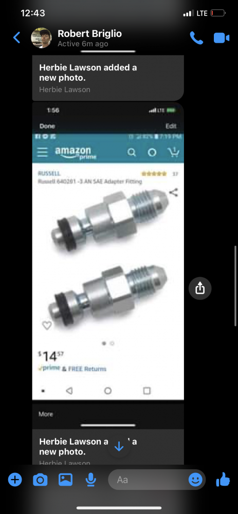

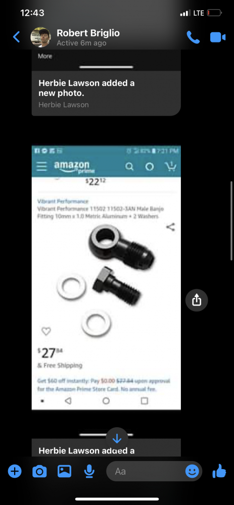

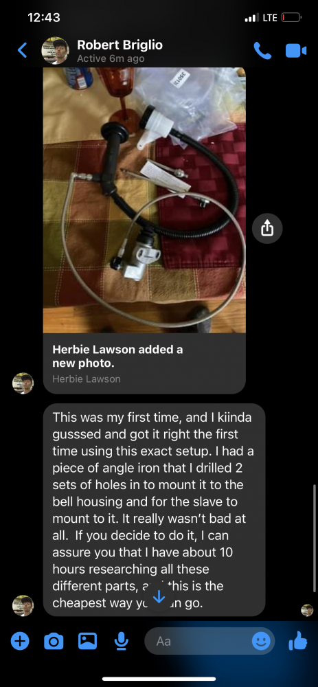

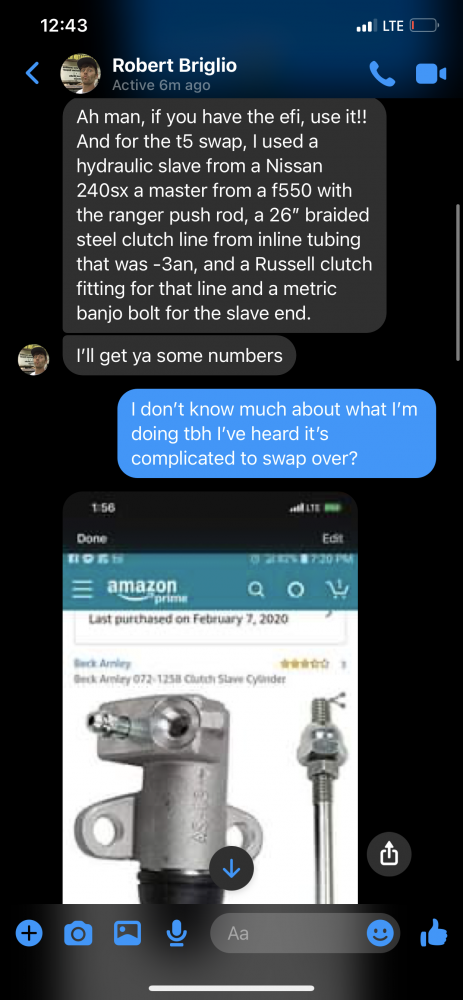

So I recently purchased a 97 all wheel drive 5.0 explorer I know I screwed that up but I’m a beginner and looking for all the help and pointers y’all are willing to help with I allready have the directions from ranger station on the swap in my 1994 2wd ranger probably gonna stick a t5 transmission in it
