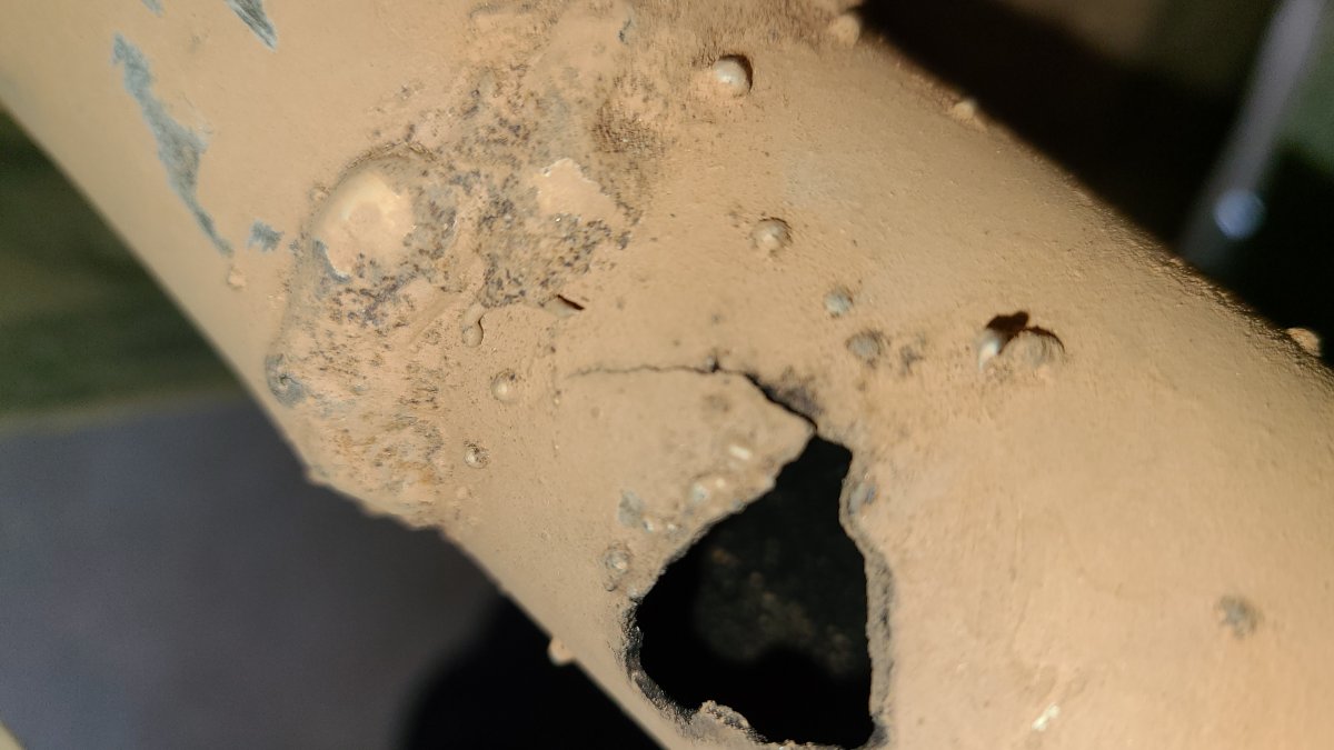

I believe I mentioned that an exhaust leak started while I was at Windrock. I had assumed that it was on the flex piece I have installed near the forward end. During the rock slider project, I accidentally nicked the outer braided part of that piece with a drill.
Well today, I was under the truck to measure my pinion angle and t-case output flange angle for someone and decided to find the leak. It's NOT on the flex pipe.just aft of there, there should be an exhaust hangar welded on that hangs from a bracket on the transmission mount. It's missing. Don't know how that would happen. It was on the top of the pipe, out of harms way. Anyhow, it should be an easy fix some day when I get the ambition to take it down and weld a patch over the hole.

a little flashing tin and a couple of hose clamp will quiet it down for a bit, my whole exhaust system on the ranger is peiced together that way.

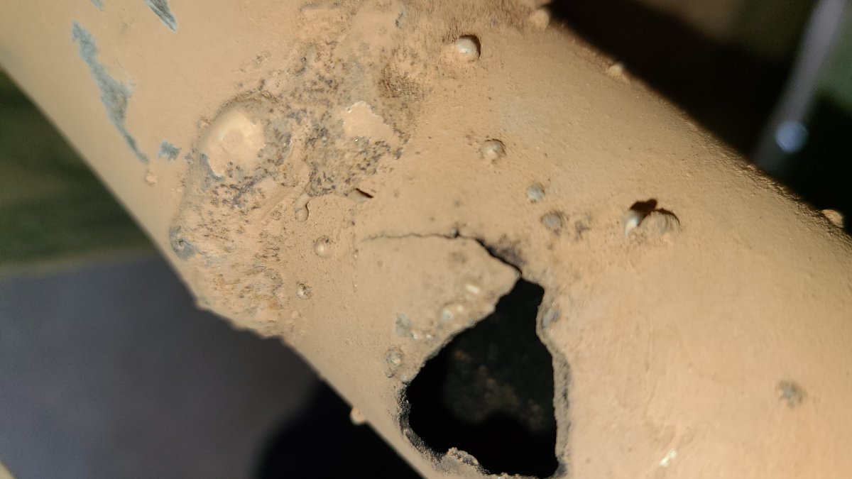

Cut a slip connecter in half to make two c sections, place around pipe with exhaust cement, exhaust band clamp on.
Have done it. Doesn't broken again.
Beer can and hose clamps work just as well. Little red RTV if you really want to pretend you care.
My trail rides and rock crawling are at low speeds. So, yes, I do care. The fumes are obnoxious. I prefer to live.

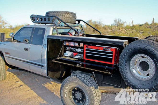

What if the replacement bed was really just a removable camping box? Something you design yourself with exactly the storage bits you need. Maybe build it so it's a table or something otherwise functional... When you get to the trail, have an engineered in way to offload it. Then -everything- you need for camping is easily accessible, and there's nothing at all to damage on the trail.

If you build a skin on the outside your styleside you can design it to hold various item you would otherwise store in the bed, gas cans, spare tires, ect. Could even mount a small cabinet or two similar to a utility body.
