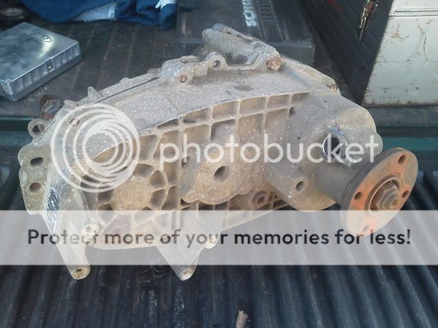

Scored a 40 lb HF sandblaster on CL for $30 a couple months back and finally got to use it for the first time tonight. I'm sandblasting the shell of my transfer case with glass grit ( $35 for 50 lbs! :O ). I'm not sure what I was expecting, but it exceeded them. The part of the shell that I finished looks brand new and polished. I'll get some photo's up when my camera batteries are charged.
Is it a sand blast cabinet, or is it an open unit style? I know I could use one, might have to get one if it works as good as you say it does. Do you have before pics of the case half?
SVT
It's an open style. Suprisingly you can save MOST of the blasting media with a broom and some window screen/coffee can
Before:
After(the whole case WILL look like this when I'm done):
^ That's a pic I found online ( I think it's Plumcrazy's actually by looking at the logo on that plastic tool case) but you get the idea.
Yup thats the one I have for sale.lol. I don't even have truck that case is sitting on anymore.lol
-PlumCrazy
Looks good. You can also make a cheap decent blast cabinet out of wood and line it with poster board. Here's a thought on the RBV cases, the 4405 front case half is all one piece. Might be worth looking into using the case and parts of the internals (has the 6 pinion planetaries) and the 54 internals to make a good, strong setup. I have most parts of a 4405, when I build HWW's doubler I might try to work something out...
