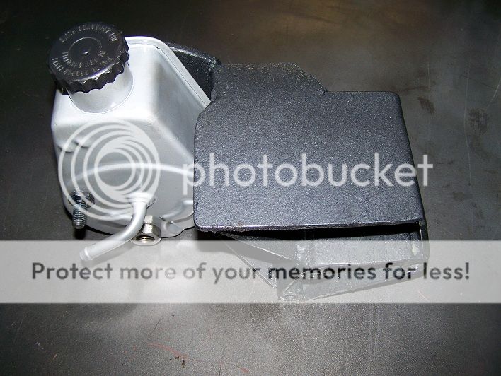

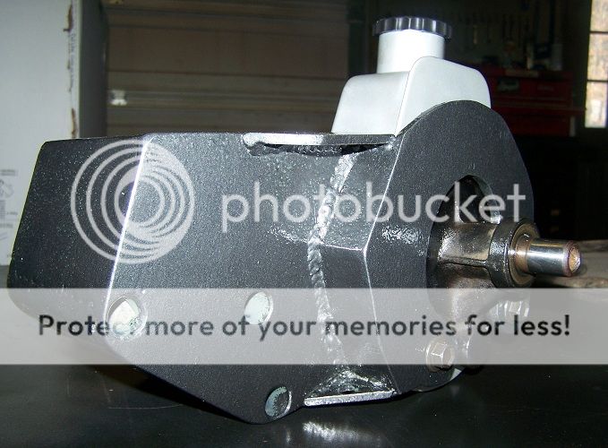

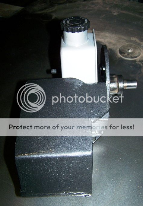

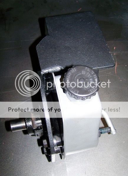

Got a bunch done tonight. Got the pump/bracket aligned and installed. Got my drilled/tapped steering box installed and I got a new power steering pump cooler and installed that as well.
All I need now is a serpentine belt. The belt I need to use when re-using the pulley that came with the pump is from a 2009 Jeep Cherokee SRT8 with a 6.1L.
awesome ps mount!!! i need ta figure out a mount for my 347 i have the pump
