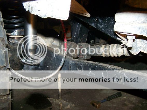

Finished up running my brake lines tonight. Got the driveshaft installed and finished up aligning it.

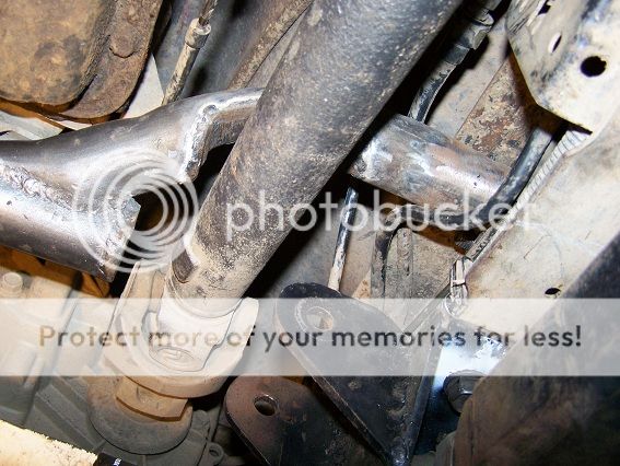

Crossmember. Everything is 0.25". I reinforced the area where it's cut out for clearance.

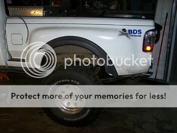

Had to install flares on the rear to please the law. Funds are running low so I just used the extra set of front flares for the time being.
Because I dont. I have 5" showing. I bump-stopped it @ 4" uptravel. The rest is all for down travel.
Very nice. I guess it didn't look 5" from the picture. Have you tested the flex out yet? At least with a floor jack?
