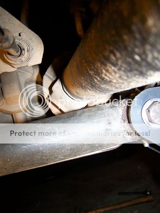

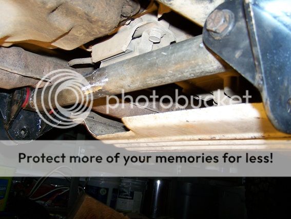

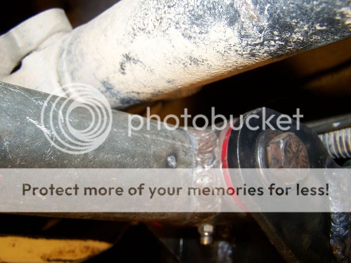

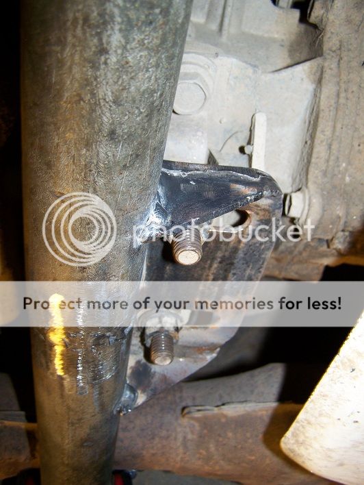

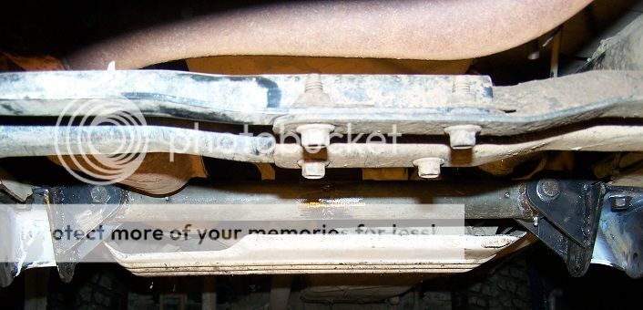

Got my frame mounts bolted up tonight. Now it looks like I have to shorten my crossmember. It's 1-5/8" too long...
The bolts Im using are certified frame bolts for big rigs with steel (no, not nylon) locknuts. I used 2 on the horizontal part of the frame and 3 on the vertical part of the frame. I might add a couple stich welds but I'm not sure yet. I had to weld a nut on the inside of the mount bc you cant get a wrench back in there.
Crossmember is in. As of now, at full flex, it does not need recessed for driveshaft clearance. We will see once my x-arms are in.
