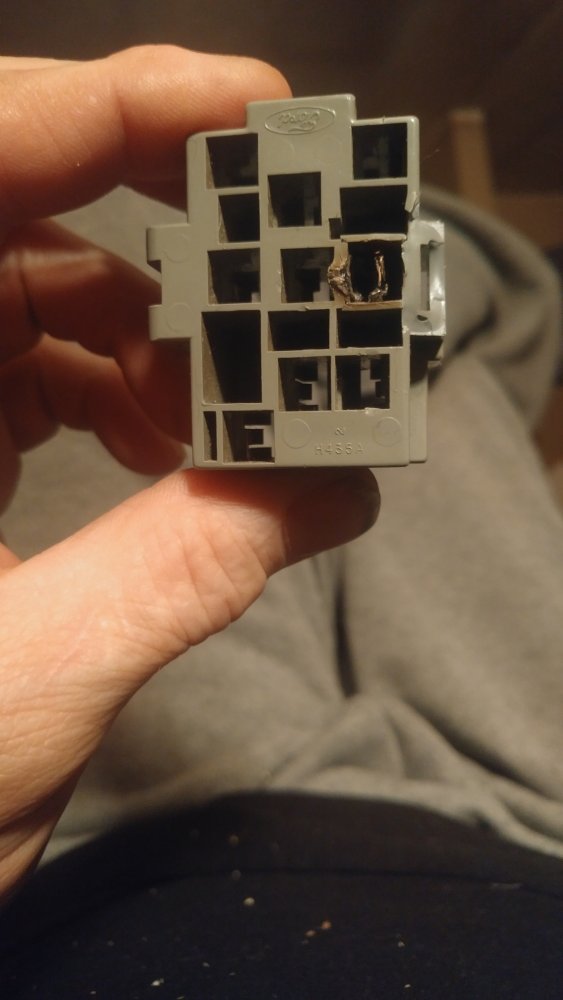

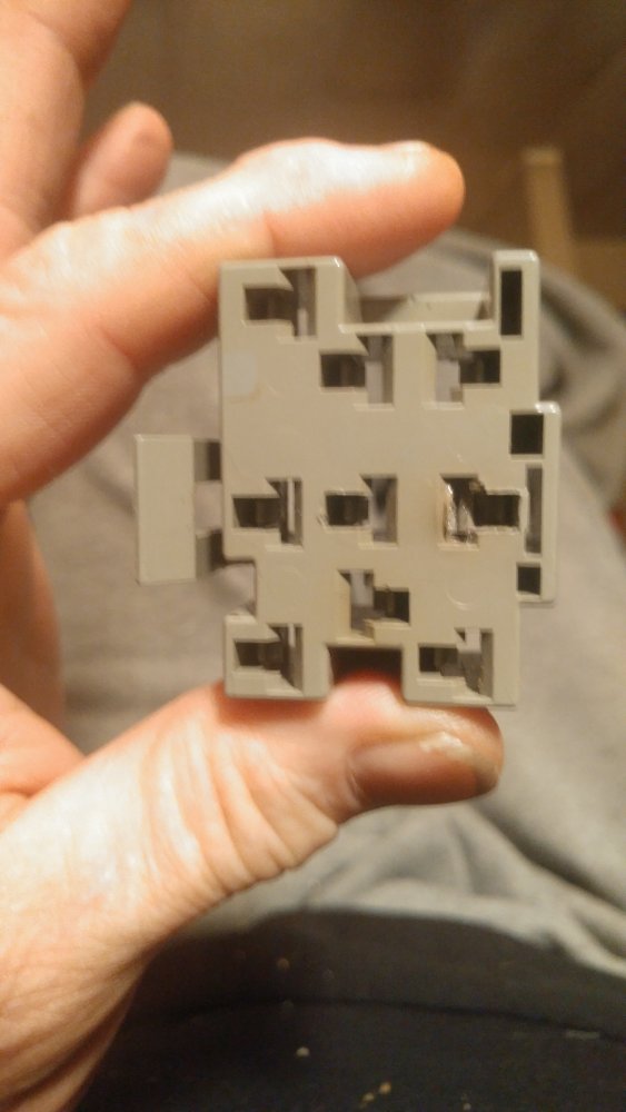

The socket behind the dash that the headlight switch hooks into. Mine is melted, both of them!...
Shipped to Red Deer, Alberta, Canada.
I would assume so. I don't know for certain. There has been a few threads where the 94 electrical diagrams were posted for 93 trucks....
If you have one easily accessible compare to the pic. Or if you can get the whole wiring harness off the dash lets see what that would cost to ship.

In my experience... when the connector melts you probably need a new switch too.
