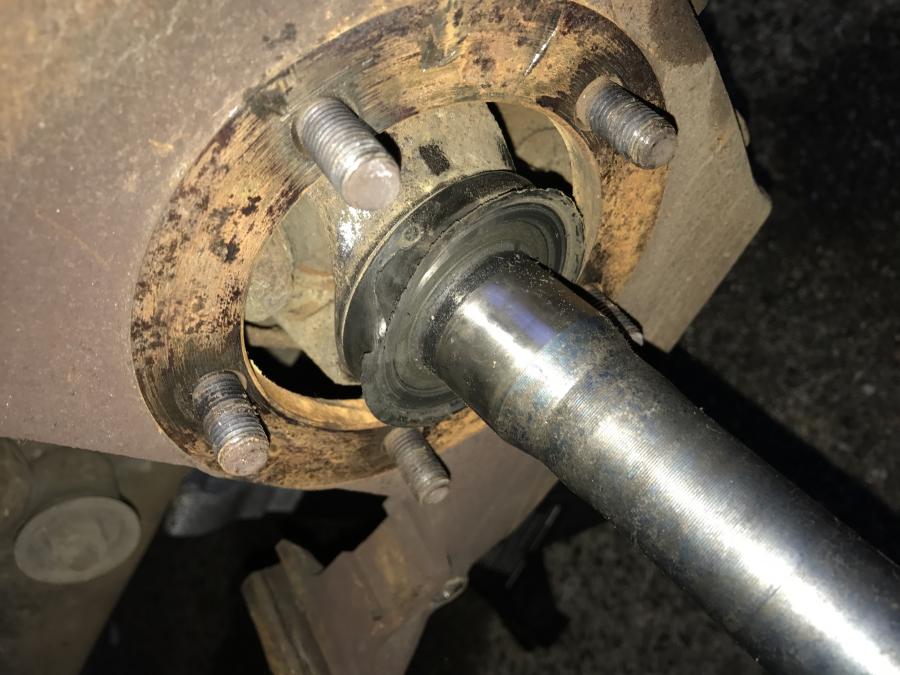

Thanks guys - I guess I was being kinda a pansy, once I popped the C clip off, everything else came out real easy. Next question though (there's always a next question, isn't there? :) )
Got the spindle off, and found that this seal had torn straight through - the other side was a rigid ring that looked to attach in the middle. Am I looking at a spindle seal here?
