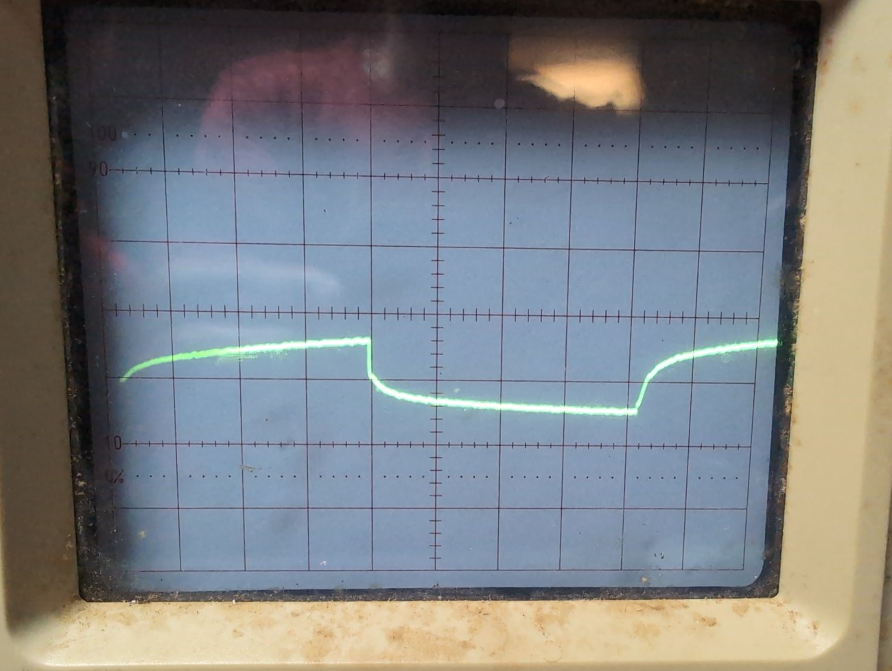

The rough idle starts about 30 seconds after startup as the idle settles down to around 600-700. When it warms up the idle is about 600 and the vibration is worse. When I step on the gas, there is little hesitation and the engine seems to run great at any speed above idle. If I disconnect the IAC when the engine is cold, the idle drops. When the engine is warm there is no noticeable change. I put an oscilloscope on the IAC and the voltage is pulsing from 2V to 8V at about a 50% duty cycle. Is this normal? I was expecting to see 0-12V pulses. If I snap the throttle open, the pulse width shortens to about a 10% duty cycle which is expected then returns to 50%. Also, If I hold the RPMs at around 3000, there is no change in the duty cycle. I would expect the IAC to remain closed at anything above idle. Both ECMs (original and junkyard) are doing this. Resistance on the white/blue wire between the IAC and ECM is 0.3 ohms. I jumper-ed the red wire on the IAC directly to bat+ and there was no change in the signal or idle. The red wire also reads about 0.3 ohms between the IAC and bat+. I cleaned and re-seated the salt and pepper connectors.

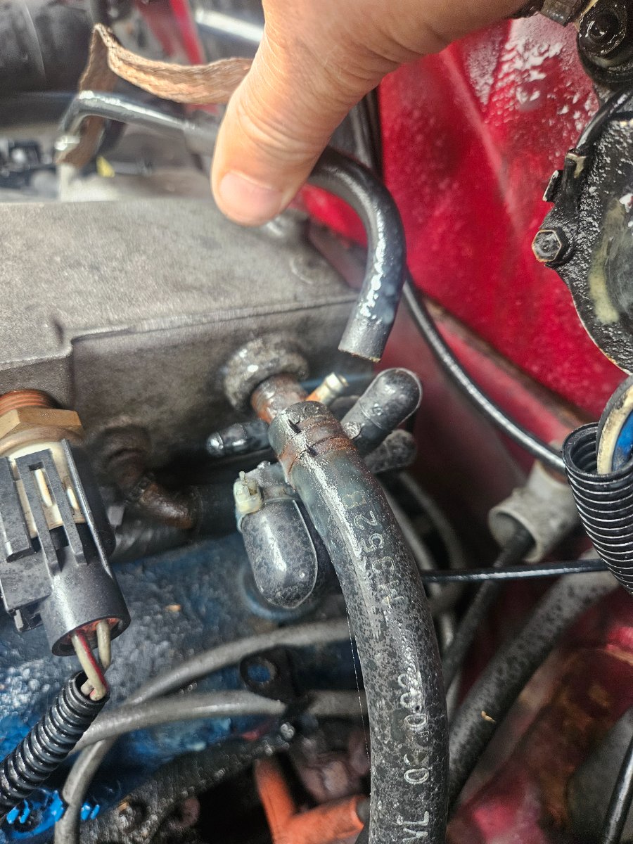

If u can , check your vacuum lines. I had that same issu with my 93 Ranger 4.0. Once I found it the truck ran great again. There's like 4 vacuums on that hub going to the intake.
