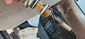

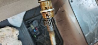

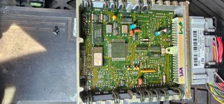

Also someone told me to check the eec and thats what it looks like. Impressive considering its age.
Check at the base of the blue barrel-shaped capacitors on the circuit board. By far the biggest failure of these older Ford PCM's is those start leaking white paste onto the circuit board, which indicates failure.
That dizzy gear is showing extreme wear. Hopefully the cam gear doesn't look the same.

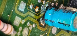

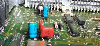

Also will picture those blue capacitors.

Definitely some corrosion under those caps.
...and the circuit board under one of them appears to have been getting quite warm. Unknown if this is your issue, one of the bad things about failing PCM's is you are reduced to checking all the things that plug into the 'box', if they all check good then you condemn the 'box'...

What does the eec have all tied into it? What should I check? I tied the battery terminals together and did a flash. Ran the truck 15 minutes and didn't get any codes back this time. Now im back to being confused besides possible distributor timing being off a little, the eec starting to go out, or there's an issue with the TC. I got a new noise that developed after they changed the distributor. Sounds like a rattle? Almost like timing chain slap. But its towards the back of the motor. I hate describing noises, the truck seems to idle decently for the most part but as soon as it goes into gear it gets shudders and that misfire. I never checked injectors because the rails are buried under the intake. A new eec isnt that expensive, especially compared to obd 2 systems. The capacitors do appear ro have a form of corrosion and the one definitely seems black on one lead under it. The wires into the eec look great for being 33 years old.
