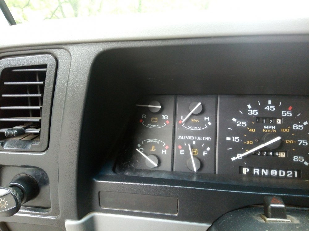

When I bought the truck the temperature and volt meter gauge didn't work. Key on/off the volt meter doesn't move at all.
The temp gauge when I got home is basically where it is now in the pic, but settled down a needle's thickness worth, but doesn't move or anything while driving. When I got home I checked the trans fluid (cause there's a tiny leak at the linkage) and the engine bay was super duper hot, handling the hood prop was like holy crap that's hot. So where is the temperature sending unit so I can make sure it's plugged in/not corroded, and is there a nice article on removing the dash to get to the gauge to make sure that's connected/grounds/etc, and where to go from there. I'm waiting for the engine to cool to check the coolant, but my overflow reservoir is empty because that does leak.

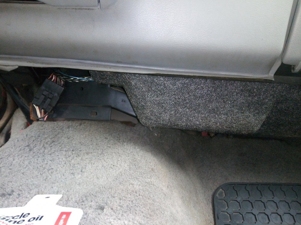

My vent fan blower randomly vibrates funky on high, I turn it one click lower, then back to high and it's ok for a while till I hit bumps. Also doesn't seem super strong. To check the blower motor/possible debris, loose bolts, connections, etc. Do I remove that lower felt cover inside under the dash? Pic posted.

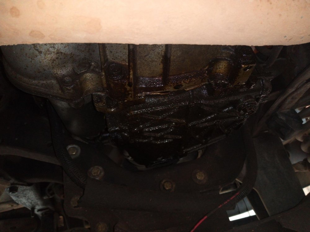

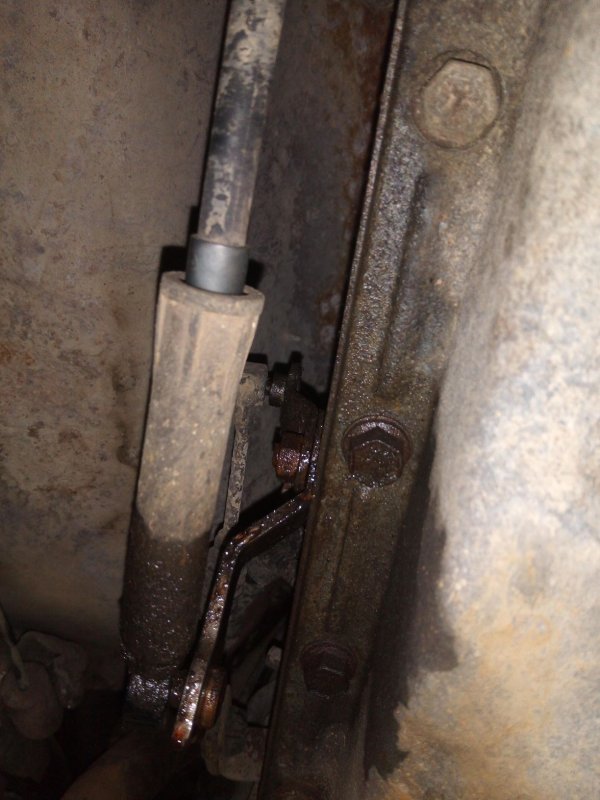

Trans leak at the shifter linkage. Looks straight forward. Drop the pan, there's a nut on the inside. Replace the seal. I'm pretty sure I have the right part at rockauto, but I'm not 100% sure. Anyone can provide a link to both a good gasket/filter kit and the proper seal for the linkage?

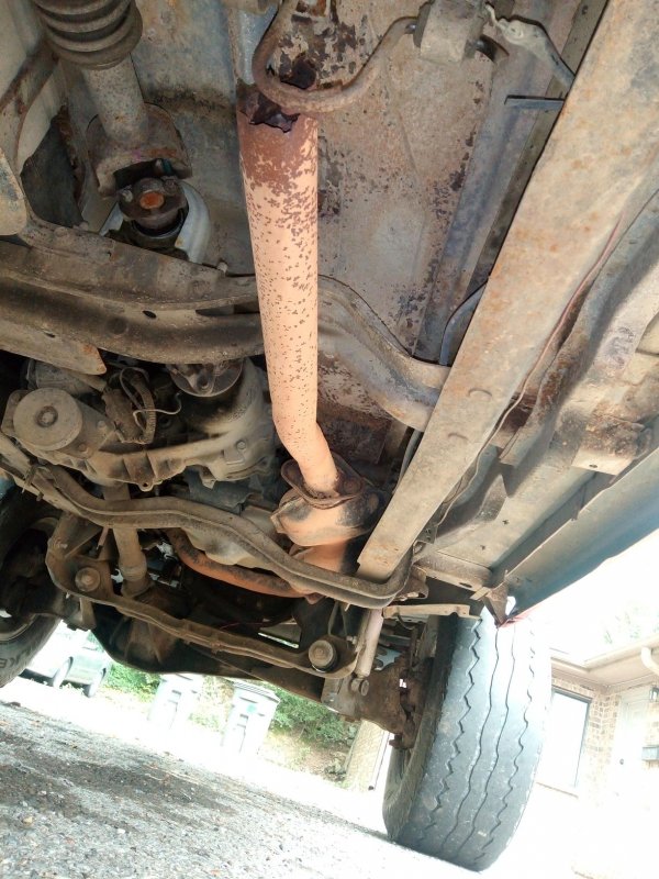

And a cheap catalytic converter/muffler set up to pipe past the 02 where it connects. The pipe's missing, it all looks old and rusted to snot. I don't care if right after the bracket where the pipe is broken if I do a 90 degree turn down for now. I can have a shop finish it out past the tire later. This isn't a priority either.

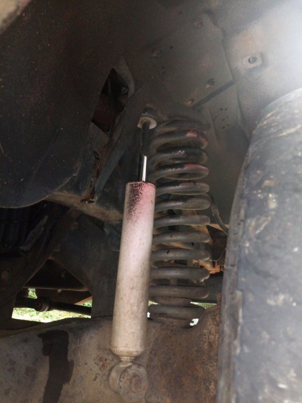

Has blocks, its lifted, is this 4"? Two separate 2" blocks? The upper block is 2 3/4 and the lower is 2 1/2 sitting on that spring perch. Ubolt is a foot long. Don't care for it, wouldn't mind the 1.5-2" lift via springs. I like minimal suspension lift for what I want, like a spring pack, and fender trimming, maybe 31" tires. It has 33s but it don't fit. R/R tire has a line down it from where it hits the fender. I can't turn the front lock to lock w/o rubbing. Any preferences for a tiny tiny bit of lift like I said 2" or so. Front springs? I've always had solid axles. My end goal is a tiny bit of suspension lift, fender trimming and 31s with 33s one day when I get new axles with a lower gear ratio. I have 3.27 gears currently. I just want it to ride nice, its a daily driver. Ultimately I'd like a tiny bit of lift, as good handling as I could have, 4.10-4.56. This isn't a crawler, its a DD, that I would play in once in a while later when I could. I never drive highway, AR has nothing but two lane twisty back roads.

And then today this morning it took a long time cranking before it started, and same when I left work. Then while I was driving home it died probably 8-10 times. So yay. No hesitations or stumbling, idles and drives smooth. Not electrical radio and blower motor still running (Had the heat running just in case). Laser said the block was no more than 220-30'ish in multiple spots. To make sure I'm not a dumbass I'ma dump a gallon in but my gauge still reads 1/4 was on F when I bought it. Guess I have some reading to do.

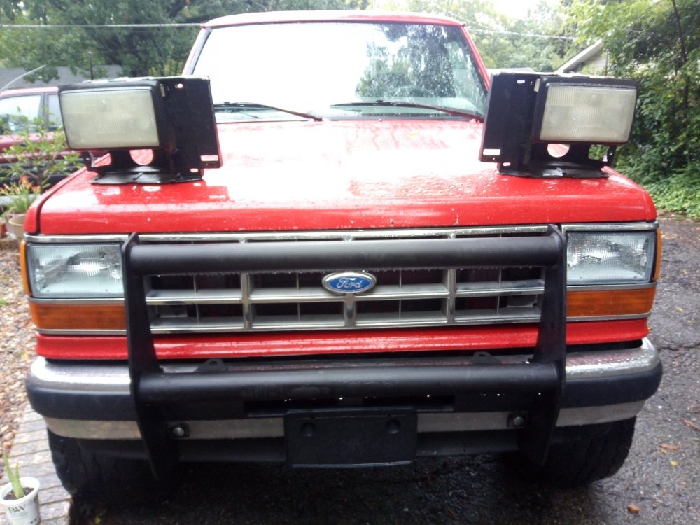

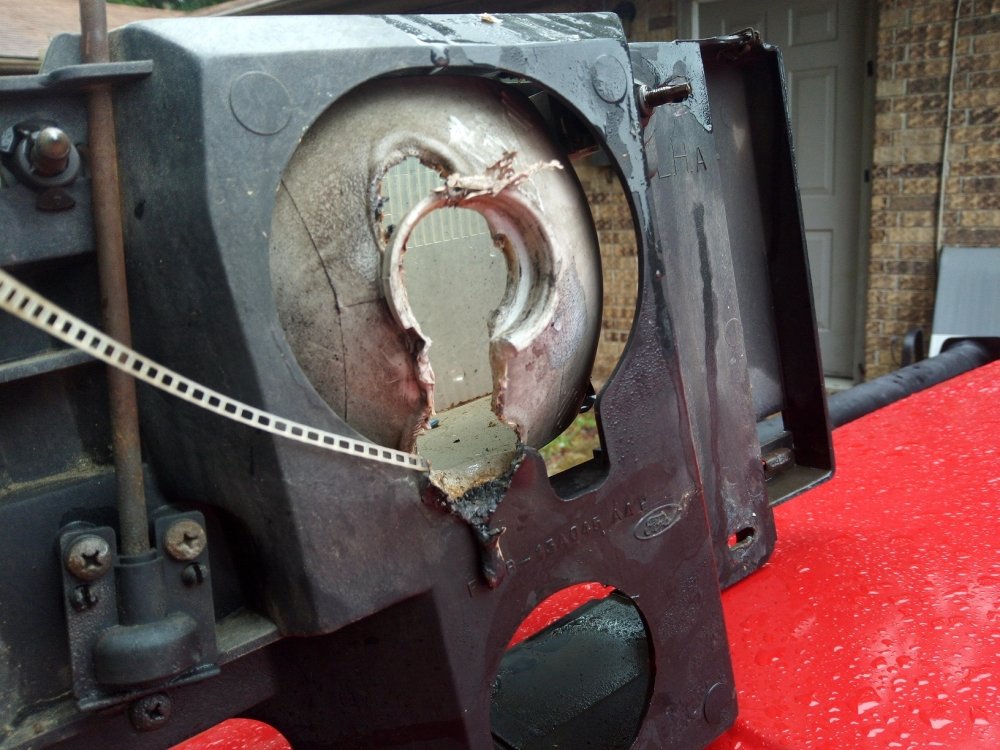

Bought a set of headlamps. My driver headlight was melted through the housing when I bought it, put them on today so now I'm not scared of an electrical fire anymore. I was just going to buy one, I'm so happy I got the set for just a little more; big difference in clarity.

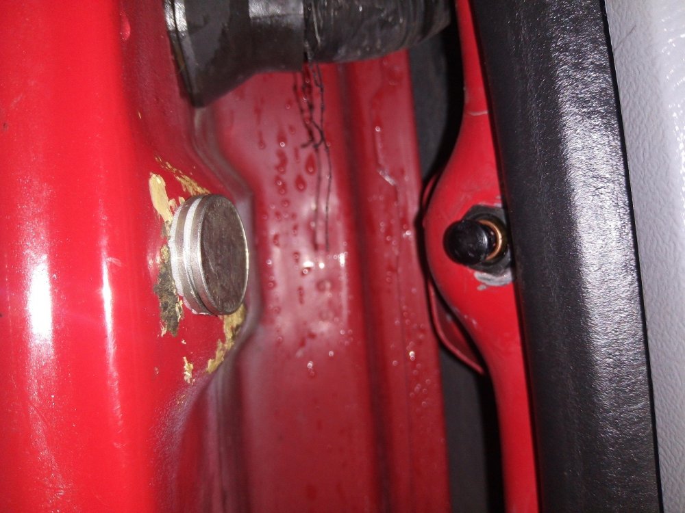

That led me to my final headlight annoyance; the door jamb switch wasn't turning the dinging off when my headlights were on, so I spent quite a few drives to or from work with 'ding... ding... ding..." for 15 minutes straight. So I bought a new switch. Still dinged, said screw it and hot glued two nickels to the door to shut 'er up. Was there supposed to be a little rubber nub on the door? Spent $11.99 on a switch, when 10¢ and some hot glue would have fixed it :ROFLMAO:
Haven't done squat with the transmission. Though I will do a fluid/filter change soon and replace the leaking shifter linkage seal.
