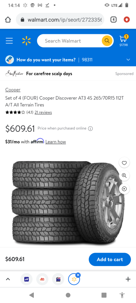

Here is a set of 4 from The "Walmart.com". They are A/T3-S4, 275×70R15. It has been my experience that take off Ranger wheels in both the 15×7 and 16×7 are very easy to get ahold of for $100 or LESS. Those tires are also available from The Walmart in 16" for about the same price.
"https://www.walmart.com/ip/seort/272335656"

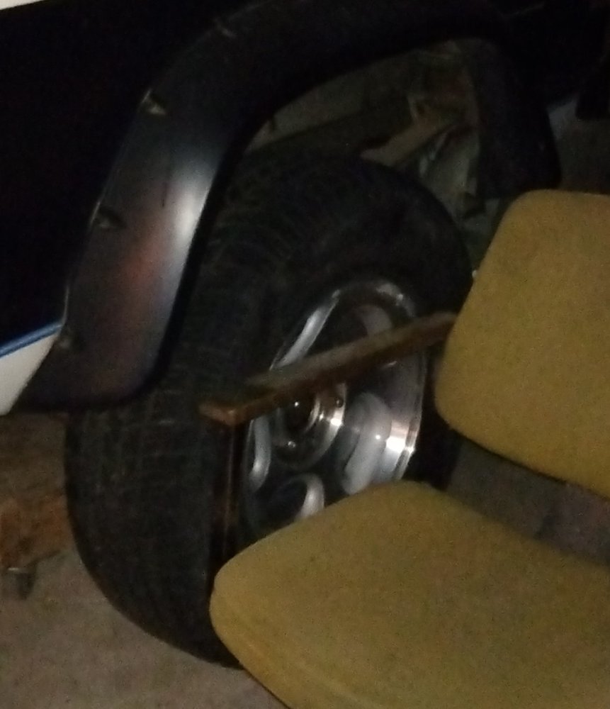

Not a great pic, hopefully you can make it out. I call these Ranger Fireballs, in 16×7 with the Ford centercaps do not look horrible. I had to open up the center holes a little to fit the D35 4x4 manual lockers.
I can't spit in the wrecking yard without hitting 3 sets of these, let alone on Marketplace ‼️

I like the price, but I’m looking for closer to 31”. Closest metric size is 265/75R15.
