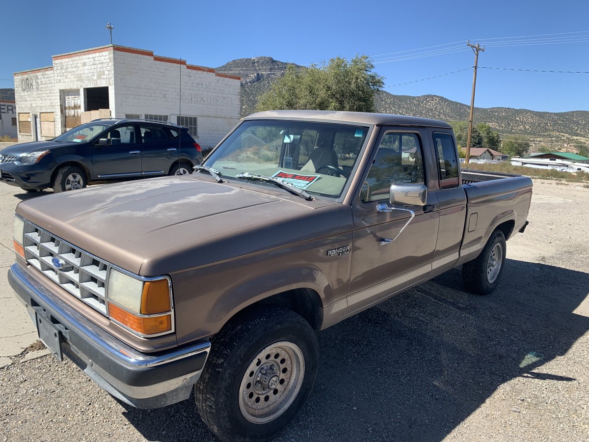

I recently purchased a 1992 Ranger XLT 4x4 with 4.0/A4LD/3.73 ratio.
The trans won’t go into gear without revving the engine. So a rebuild or replacement likely in order, and the tires need replacement before the snow flies no matter what I do with the truck.
My plans are to use the truck as a daily driver and for light duty off road for hunting, fishing, mining, camping exploring and towing of a trailer under 4K lbs.
I will be doing most, if not all of the work myself and my budget is $4,000 including the transmission, which I can do myself along with other minor issues with the truck.
I anticipate doing a suspension or body lift kit to allow for larger tires, and using the stock wheels if usable for the tire size I decide to go with, most likely in the 31-33” range. I am thinking reliable function over form for this build.
Any ideas or thoughts appreciated!

You should be able to fit 31" tires stock if that helps any decisions, might be tight up front though...

I was leaning towards 31’s, as they will fit stock. But, I don’t mind doing a 4” lift and going a little bigger.
will 31’s fit the stock wheels?

They should fit on the stock wheels, some tire shops get cranky mounting wide tires to narrow wheels but a '92 should have wide enough wheels...
If you do all of the work yourself... 4K knocks a bunch off the to do list. I would probably go further if ya need to to do it right if the truck is solid.
I think 31 inch tires are a good choice. Any taller would likely require a gear change to keep it in the power. 31's are also better for daily duty stuff. They will certainly fit your 7 inch wide wheels. They're bigger then stock and the first and second gen have small wheel openings.
I'm not really into tall body lifts. But... they do gain body clearance for tires and clearance to powertrain... fir fixing stuff. A good suspension lift totally blows your budget.
I'm thinkin fresh HD springs all around... a 1 inch body lift on 31's would be a pretty sweet spot and keep your budget from creeping.

That’s what I was thinking. The “Executive Budget Committee” aka the wife, is onboard with $4k. I can see it hitting $5k ish, and am prepared to negotiate that.
I agree with that logic. I just need to find the right tires. I not into real aggressive tread or wide tires.
Was originally looking into a 3” body lift, but didn’t like the idea of the bumpers not moving with the body. Just started researching lift kits. I saw one in the $600 range. But I do know better then to think it’s a great one.
Great idea on the springs. I was going to replace all the suspension rubber, so replacement springs fit into that scenario.

I'm considering a 1 inch body lift myself. While it use to be available as a kit... no longer true. There are shops out there... even ebay that sell 1 inch aluminum pucks. I've read that 1 inch requires no other alterations. Slip the pucks in... tighten them down... done. No radiator/hose/shroud issues... no filler hose... steering shaft... wire harness... and the bumpers stay where they were meant to be. It does end up with a bigger gap at the bumper... but livable.
Rangers come with 9 or 10 inch brakes. Typically 9 inch on the 7.5 rear end... 10 inch on the 8.8 rear end. You will have to check the door tag... and look in the Tech Library for your axle code.
