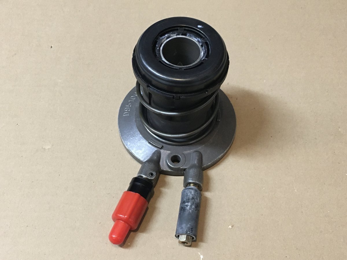

Hello,
I mistakenly bought a whole clutch kit from a guy for a 1991 4.0 Ranger thinking it’d work for my 1994 4.0 Ranger. Upon further research... it seems the slave and clutch master are different part numbers. The flywheel, pressure plate, and disc had the same part numbers.
my slave
60119
the right one
60120
They are obviously different. Will the slave I have work or just screw it and order the right one? Kind of a dumb question... just mad at myself for not doing my research and i feel dumb because I thought I got a great deal on these parts... now I’m stuck with them lol. Live n learn
thanks!
It will work. The differences are in the hydraulic hose quick connect end, and that part of the slave cylinder, and possibly the master cylinder pushrod. Verify that it is the same length as yours. You should be able to use all that on your truck, but not mix and match parts with what you have on it already.
