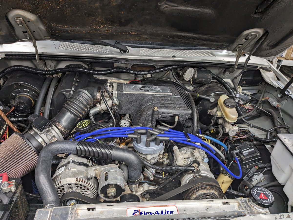

Figured would post some pictures of Ranger, 91 STX. Purchased unseen from George, rust free but needs repainted. Installed 3" James Duff lift and 31" BFG. Pulled 4.0 and installed 91 Mustang 5.0 and AOD with Advanced Adapters t-case adapter. Freshened up motor with new bearings, small Comp cam, GT40P heads and intake, Heddman headers, Ron Francis harness and MegaSqirt computer.
That is a nice clean truck. And great job on the 5.0 install; it looks stock.
Thanks for sharing it.
Gorgeous truck Steve!
She's a sleeper!
NIICCEE. What's wrong with the paint? Looks good from here.
