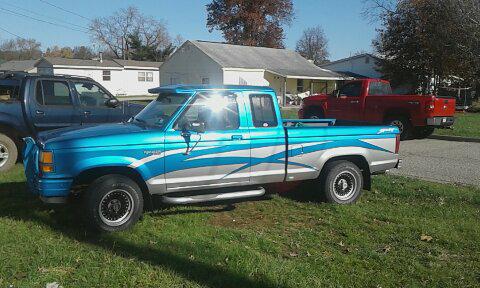

has the 4.0 that needed new head gaskets transmission already had a shift kit installed (from what im told cant prove it so its up in the air) has 60,000 original miles
custom paint, bumpers and brush guard painted to match interior is 8 out of 10

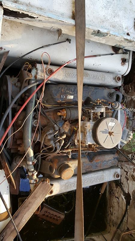

i did get my hands on a 5.0 out of an old house boat pics to come btw the motor was free
heres the motor guy said i can have it all 30 foot trailer and a 5.0 if its saveable oil was still good and clean havent turned it over yet had a ton of water in it all for the price of fuel it took me to move it. i say its a win win. :icon_rofl:

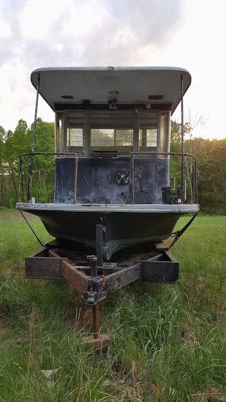

heres the boat had 844 hours on the reading im really just hoping the block is good its gonna get a complete rebuild.
  • 1991 ford ranger
started the tear down yesterday pulled the valves and intake off and one head exhaust bolt is keeping me from taking the drivers side head off didnt have a cut blade for the saw saw it was a lot cleaner then i was expecting it to be a change of oil and filter a few times should do the job. got the boat moved gonna take it off the trailer and turn it into a play place for the kids and pull the motor.
