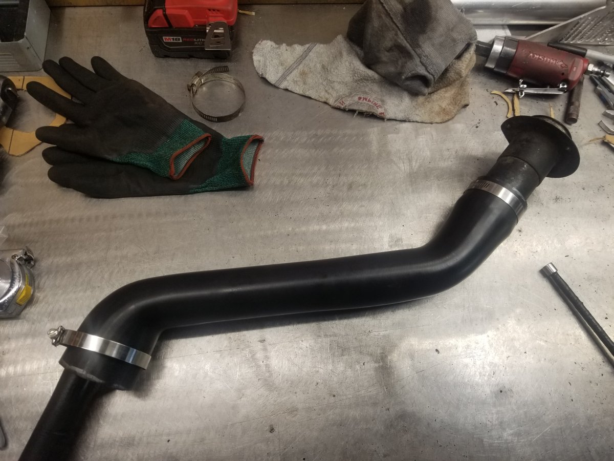

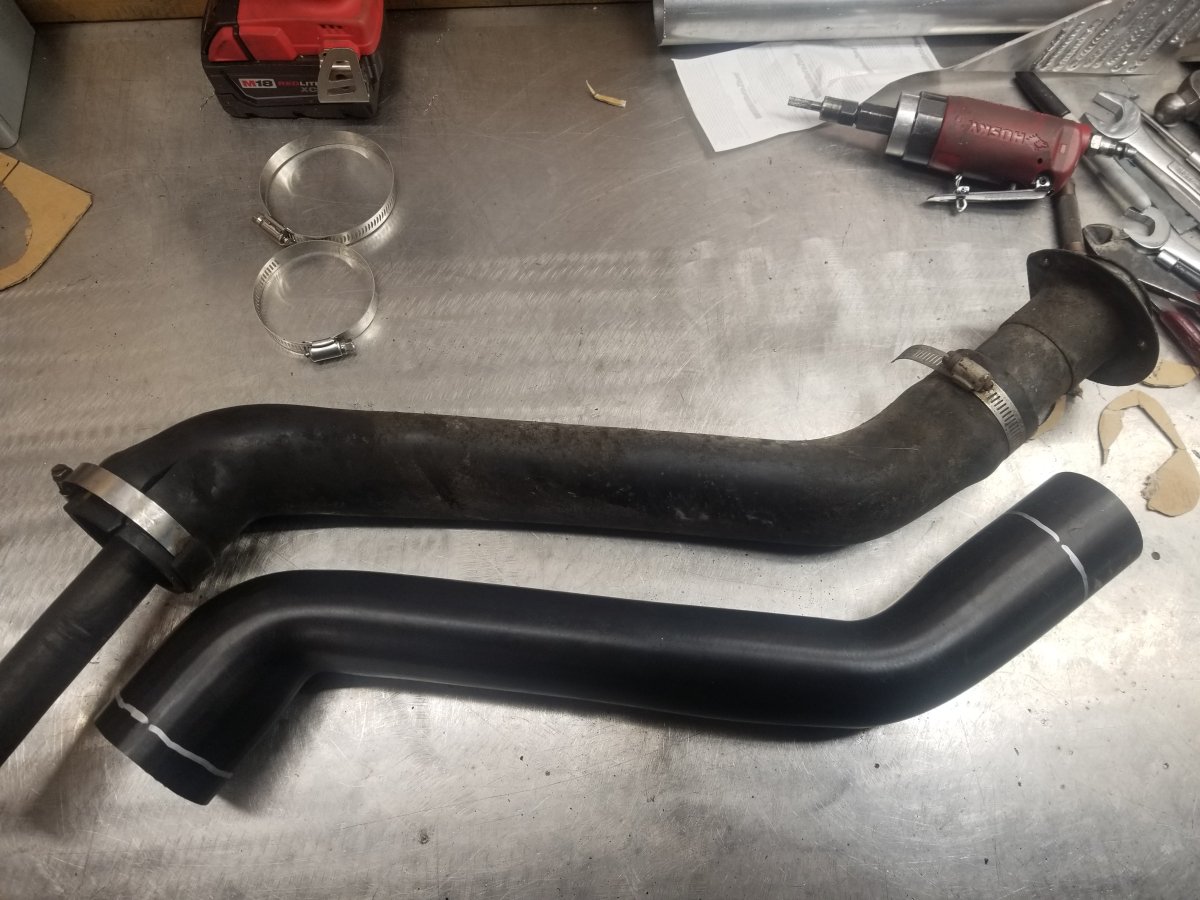

This hose worked
Was able to swap it out easily by dropping the tank down a bit.
The new hose was extra long so I trimmed it down same as the original one. Should have NOT cut the upper end, was almost too short, but still fine.
I wasn't looking forward to it, but ended up being an easy swap.
