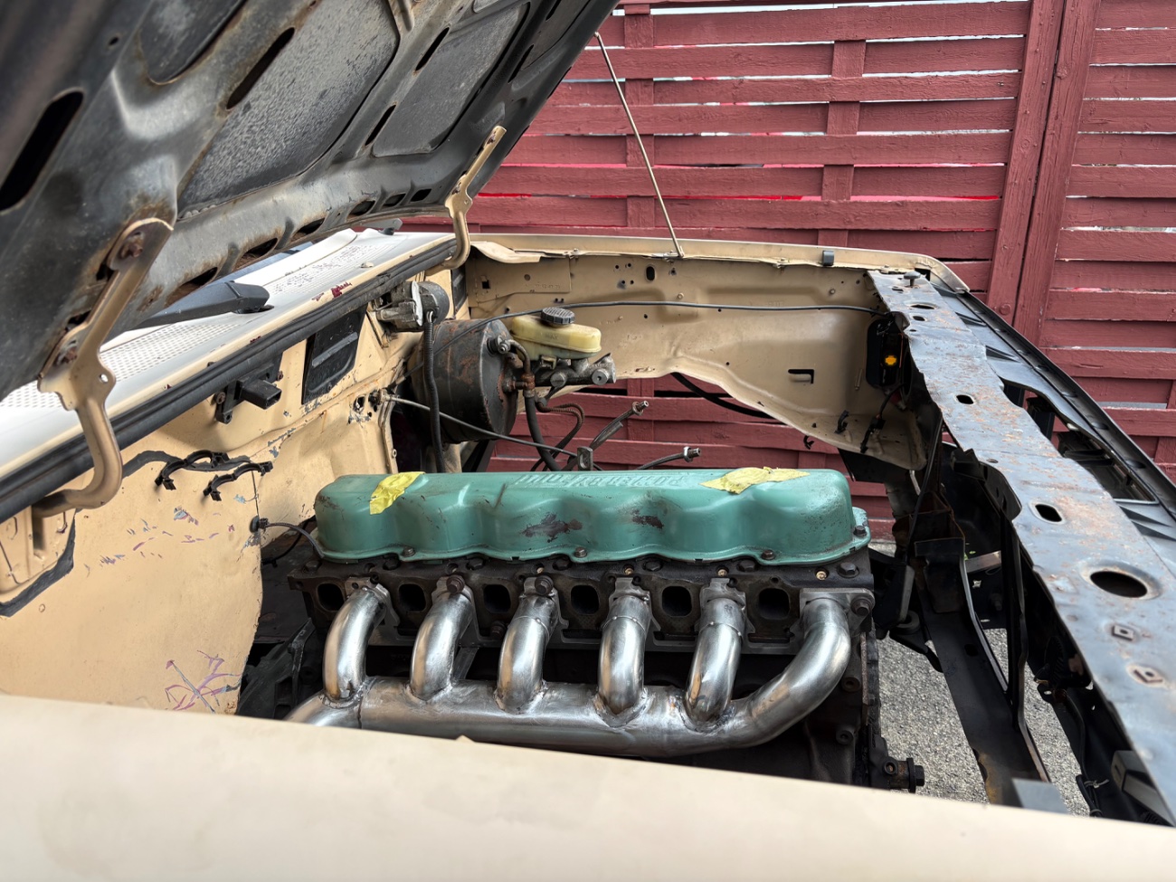

1990 ford ranger 300 swap in progress
there are several with zf 5 and doublers out there...
most have aod automatics or c6....and usually 2wd. very hard to make the aod happy with the aod....with a cutback kit and fixed psi its easier...
Not saying your wrong just never seen a build thread, post, etc out there on them. Just said to my knowledge. Granted I didn’t choose this route to be a “ 1/1build” I just don’t care for the zf5,and I like the 300 and have a ranger with no drivetrain and I refuse to run a big body lift 😅
None the less if you favor serviceability, hate body lifts and refuse to hack up the firewall or rad support you end up where I’m at lol. I’m sure I’ll iron out a solution for for now just get it all hung and see what works and most likely what doesn’t and go from there.

that turned out better than titties and ice cream.
definitely consider an over rail box or a jeep box....maybe even drop back to a push/pull setup.
you modified the firewall already....
or at least shitcanned the oem hvac. the ttb k member is a ghost....
easy peasy with those two things out of the way.

I’m changing back to non ac hvac lol that was just a lazy attempt to keep rodents out of the cab and water out while it sat for 5 yrs 😅

I don’t hate the idea of like a Toyota box or similar but I’m not sure it would be any better: but maybe. It’s something to look more into. Eitherway and thanks lol like I said I’m just trying to do the swap some justice.

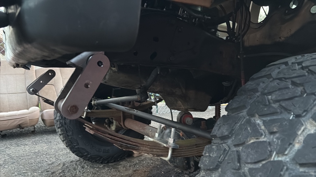

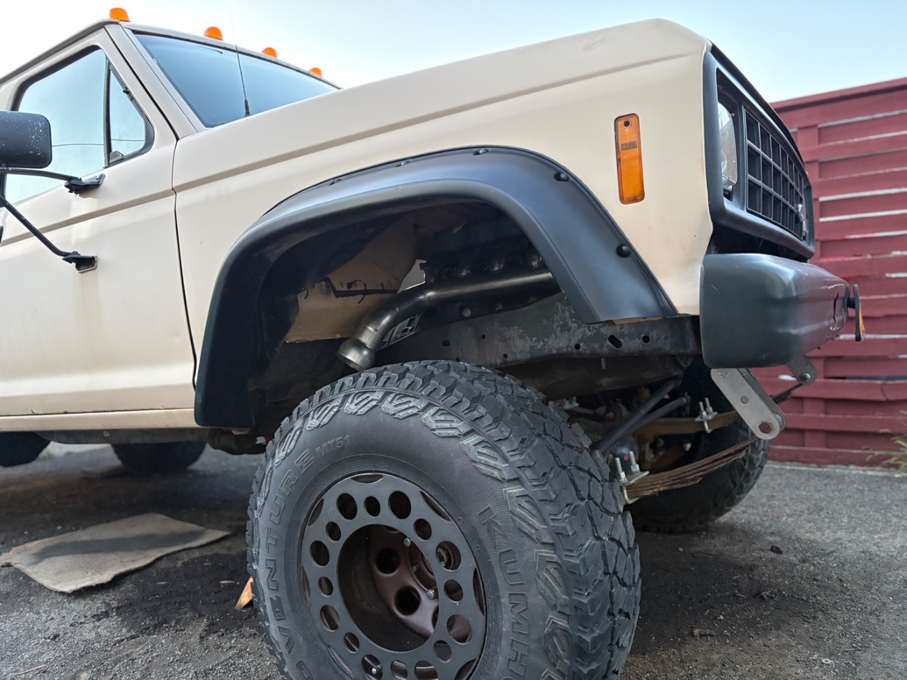

Unfortunately weather delayed any real progress as had to spend the day on the roof repairing a leak… and tearing out the furnace. That being said moved the axle around. Have it pretty much where I like it. Still genuinely curious how it’ll sit once in its own weight but time will tell. Hopefully make be progress on it tomorrow.
>dumps exhaust out the fender well like a MG/Rover V8 swap.
My man. 😎
