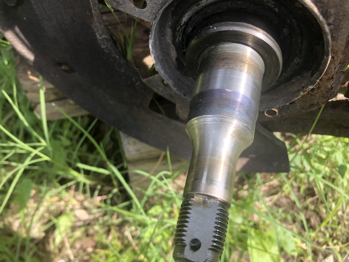

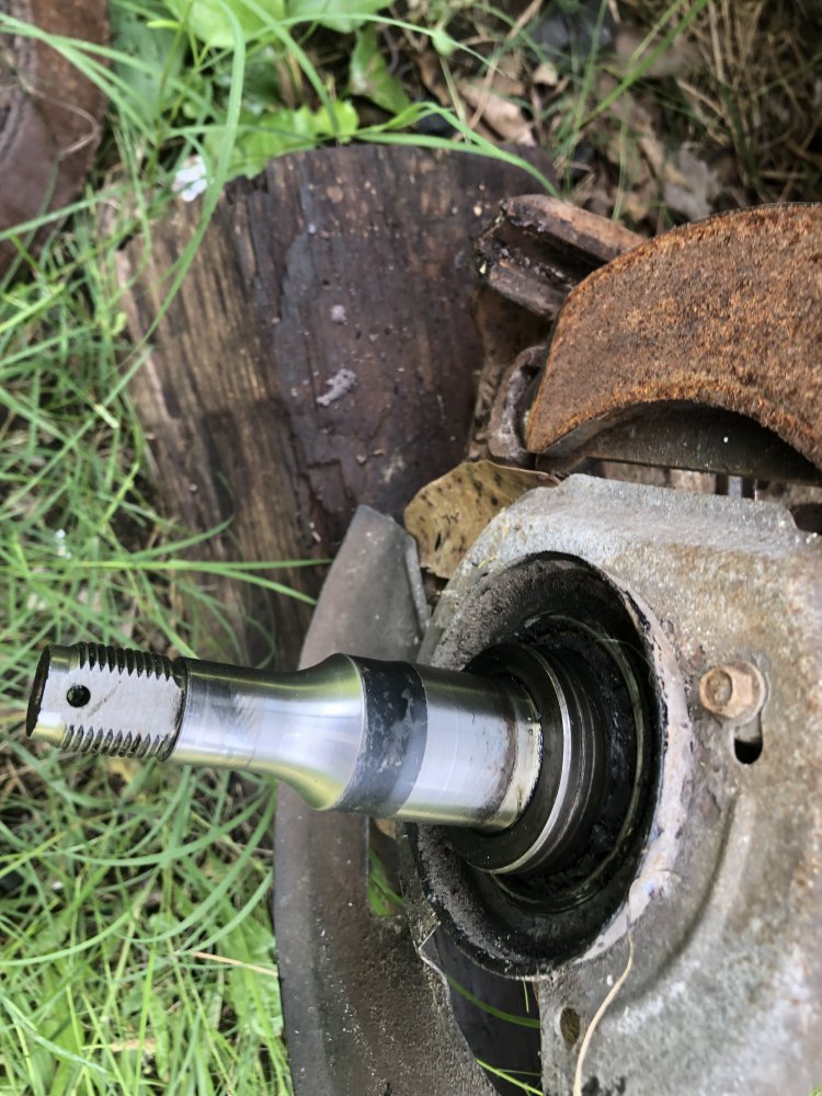

I have a 1990 I use for body parts I’ll pull the rotors tomorrow and check the spindles and let you know .
They are in real good shape . $80.00 plus shipping

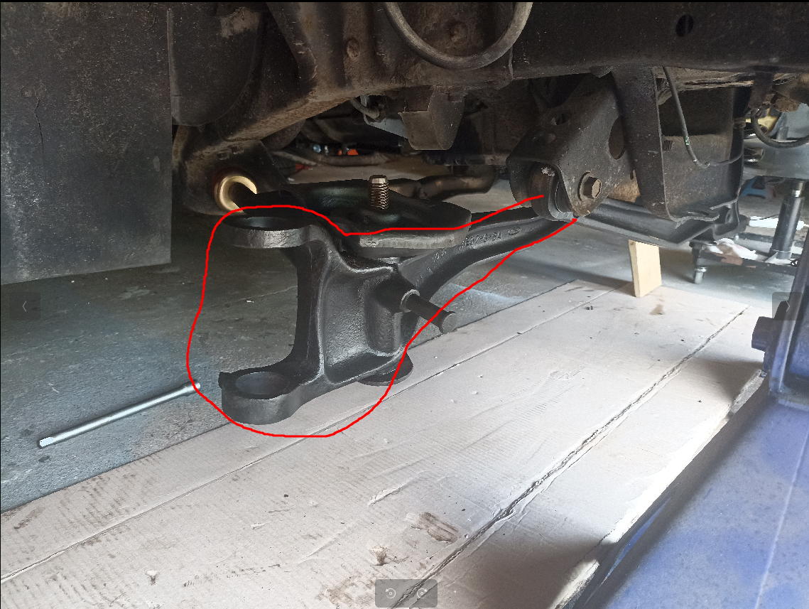

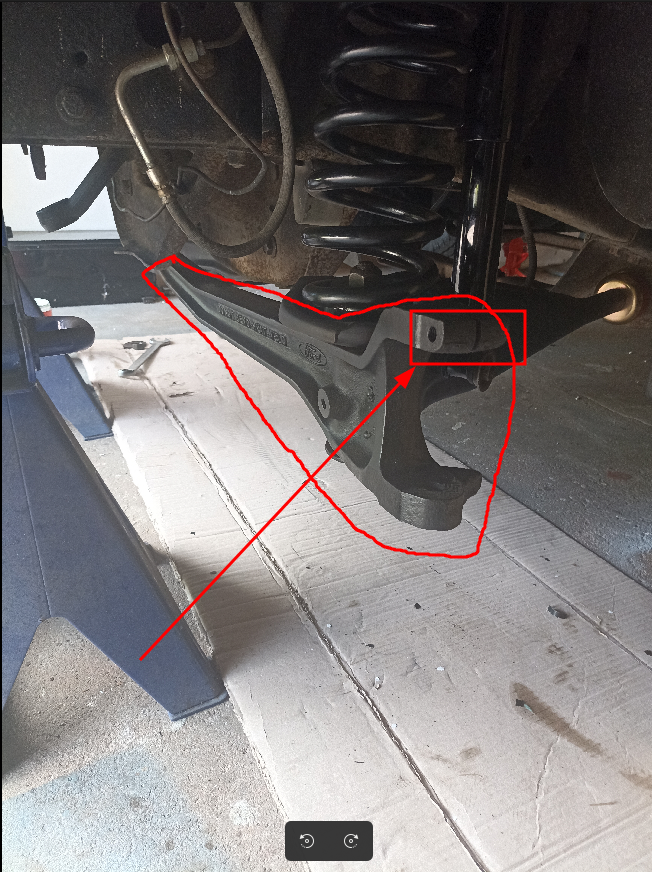

Now, I stared to think that my passenger side i-beam is from the different vehicle - maybe F150 or similar. It's almost an inch longer and does not have a hole ford the camber adjustment pinch bolt as on the drivers side. Can you guys verify that from the images below ?
The 2 axles are different lengths. There is an article somewhere that explains why. I will try to find it and update my post.
Edit; couldn't find it. To other members that may know; I was looking for an article that had a diagram with a top down view showing the orientation of the axles and radius arms pivot points.
I dont think an F150 beam would even fit a ranger.
OK, but how about pinch bolts ? Shouldn't it be there on passenger side too ?
Sure, that was just a wild guess from my side
Yes , it should have pinch bolts . Just went out and looked at my parts truck .
