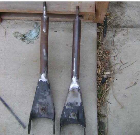

If i used the stock rad arm and fabbed it up to make it a extended. How long should the tubing be for my six inch lift?
here is a picture from the forums of what i want to do.
Im wanting measurements of this set up. So i can make myself a pair.
If you choose to build this style. Don't end the pipe right the base of the arm. Run the pipe along the inside of the stamped piece tieing it in throughout the entire distance. Trust me it'll make it alot stronger.
Alright, not to hijack more, but I picked up a pair of those brake lines. My question is, on the driver side stock one, there is a spot for 2 hard lines to go on the flex line, on these ones there is only one spot. I just wanted to let you know it wont be a bolt in, or a least in my case.
Any ideas on how to fix it so it will work??
The arms you posted are mine :D
They are 12" longer than stock, this is just the right length so you can still use your tranny x member. And yeah, make sure you run the tubing a ways into the stamped arm, if you look closely at the pic, you can see the heat mark from where I welded it, it's almost exactly where the red box was drawn in. :icon_thumby:
