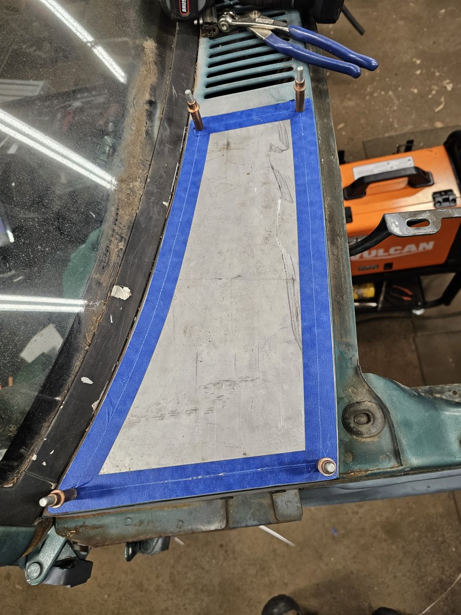

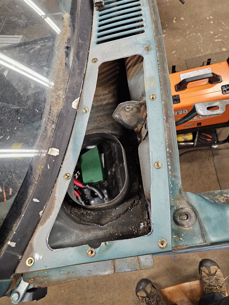

Unfortunately the cowl seam goes up under the windshield and is spot welded together there (the windshield actually glues to the same piece of metal the cowl is made from) I am refurbishing a cab that sat for 30 years and had a mouse nest in the cowl, which rotted it out. I cut a hole on the passenger side top and made an access panel because I needed to get a welder in there, which I couldn't do because the hvac intake is in the way. I made a nice stainless steel cover for it as well. Once I get my paint done I'm going to put some butyl seal around the outside edge and leave it raw stainless after. I was leery of cutting the ends out because I didn't want to affect the structure of the cab.

That will look great when you are done. I think that may need to be the direction I take as well. The way the water is coming in I dont think there is any way I wont have to weld some in the valley.
Around where the heater hoses come through the firewall and behind the heater box is a common rot spot. The cowl seam and the firewall all make a 3 layer sandwich. Ford put seam sealer between all three and spot welded it all together through the seam sealer. It eventually turns into what is effectively concrete and doesn't seal the seam effectively, water gets in and rots the whole thing out. I thought I only had to repair a couple of small spots in the cowl but it turned into needing to replace the entire top edge of the firewall and a few sections of cowl as well.
