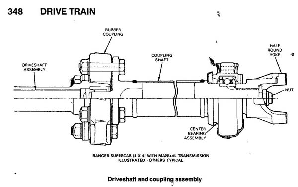

1989 extended cab, looking for rubber coupler between transmission & drive shaft
By any chance did you succeed in finding one? I have a 1989 Ford ranger that has a coupler that is cracked and I'd like to replace it. What did you end up doing? Thanks!
No, I haven't. The local transmission shop couldn't find one either. if you remove the coupler, the bolt holes line up between the trannie and drive shaft. Putting a piece of thick rubber between the two and bolting them together may work although I haven't tried it. The rubber would allow just a tad bit of flex as needed. Probably need lock nuts on the bolts. I am still driving on the original coupler, but it is definitely time to do something about it. Thanks for the reminder!

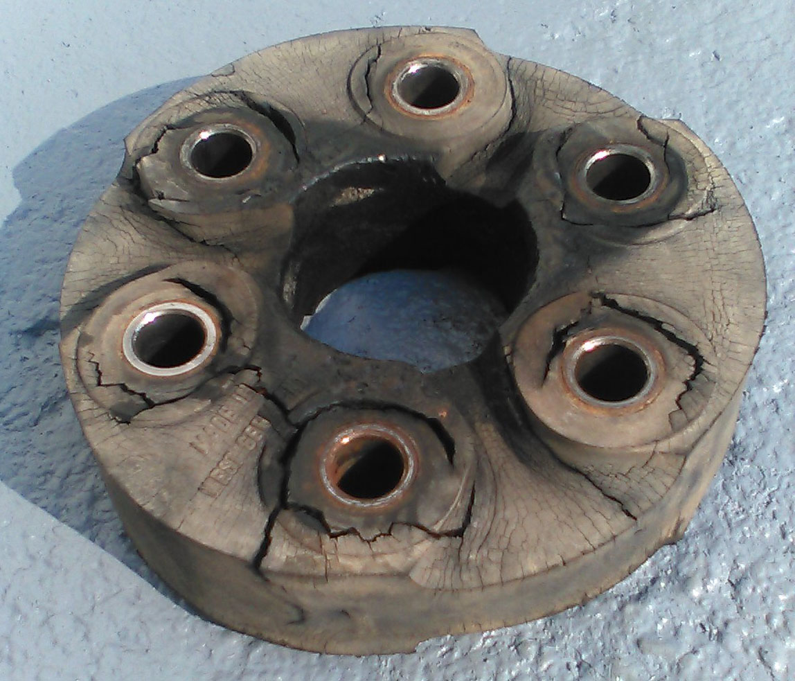

they are also called a guibo, if you can;t find it under coupler (i have never heard it called a coupler on a driveshaft).
but rockauto would be my choice too
your picture looks just like the guibo on my 83 bmw 318, and on previous bmws i have owned from 79-91.
you can also buy aluminum replacement versions from a number of online shops. measure yours from hole to hole centers and thats how you figure out which size to buy
Torque Solution Solid Billet Driveshaft Flex Disc (Guibo): BMW (96mm) w/ 12mm Bolts
i have been through trying to find the right one when i swapped a 4 cylinder bmw to a 6 cylinder and when we swapped from one 6 cylinder auto to another 6 cylinder with 5 speed.
i just found this link too:
PowerTrain Industries - Catalogs
