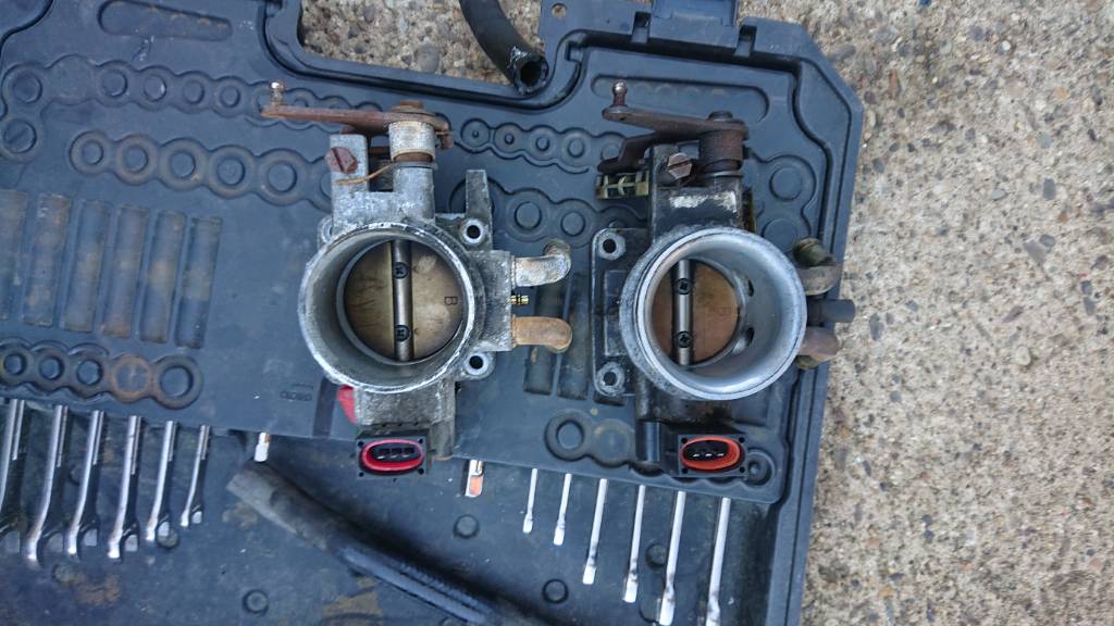

Interesting day at the junkyard today.
Installed it and took the truck for a short run... Not sure how much difference it has actually made.
I'd ask for tips/input, but I've read the throttle body swap threads...
Keeping the old one around in case my fuel economy goes to hell. DSC_2046.jpeg

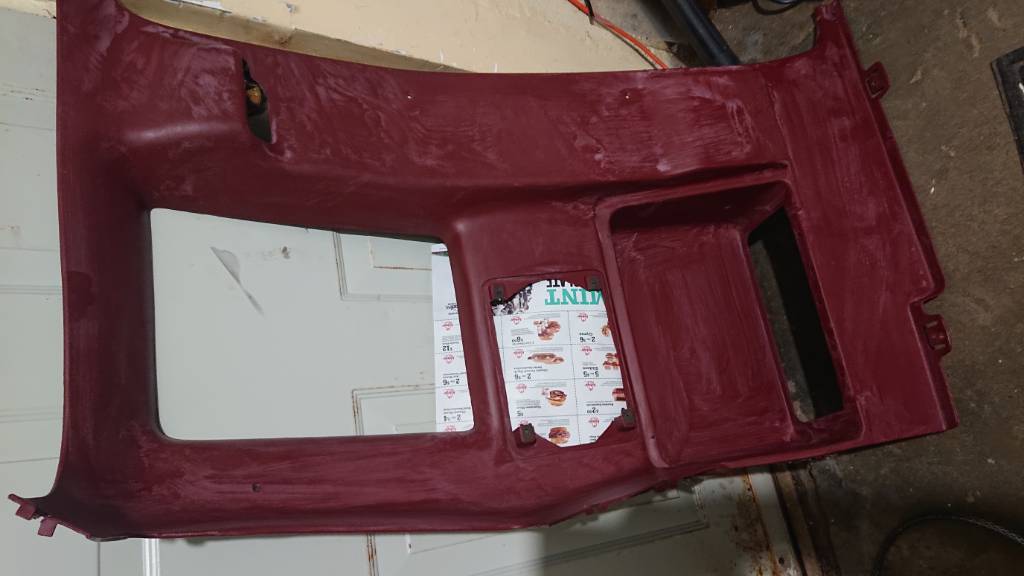

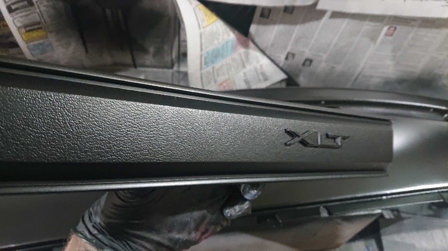

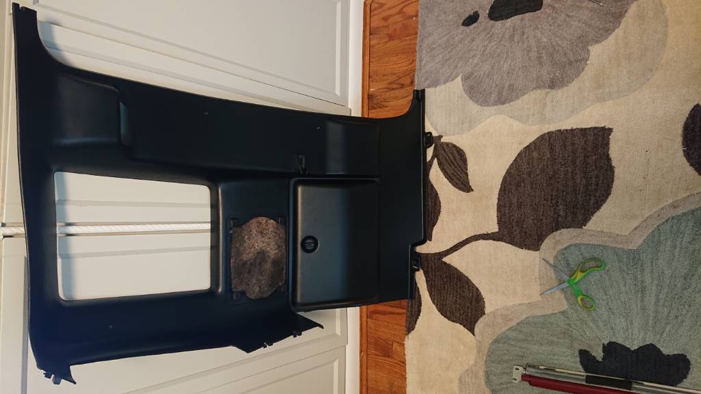

Killing two birds with one stone here.
Before and after shot of one of the factory jump seat deletes.
Paint is Dupli-Color Vinyl and Leather Flat Black. Stuff is weird to use, but once you get the hang of it and the prep work, the parts come out stunning.
It also makes you feel like you took a long inhale of an air sample from the Woodstock Concert after 10 minutes of using it. So, the parts may look great, or I may be somewhere between Willie Nelson and Syd Barret right now. The pink elephant sitting next to me hasn't told me yet.
Sent from my H8314 using Tapatalk

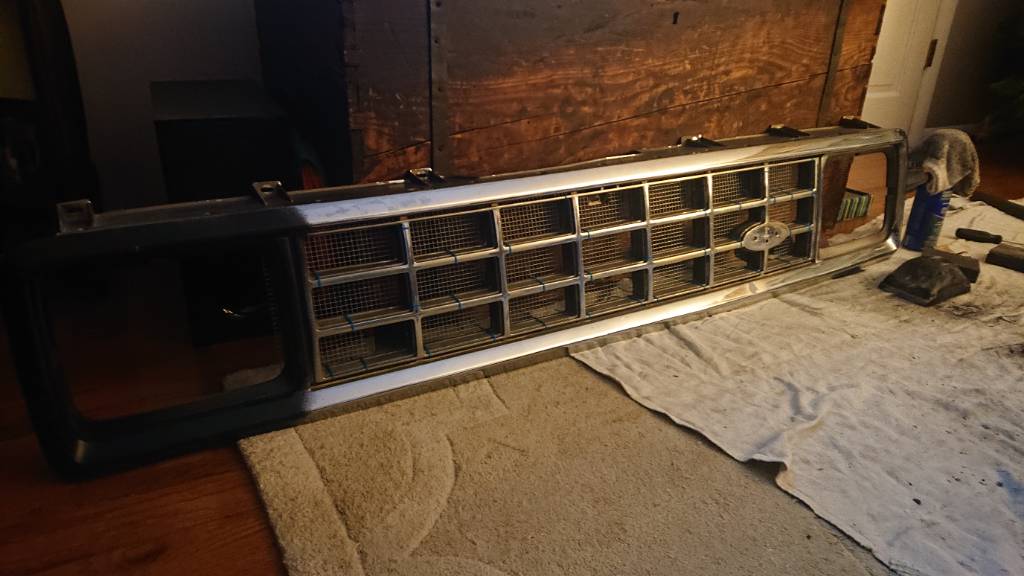

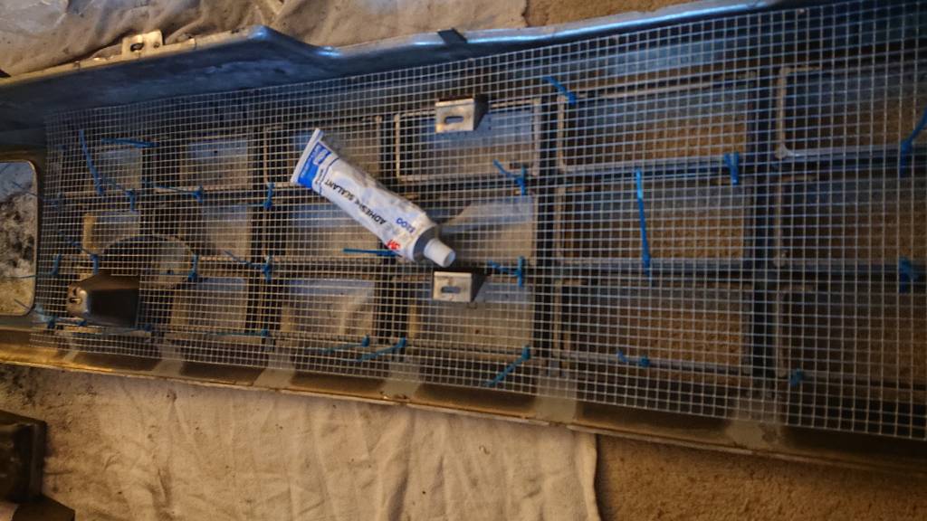

Experimenting with an idea for protecting the rad from larger bugs, birds, stones, etc.
Never had 3M marine adhesive fail on anything I've used it on, and the black coating is plasti dip. Just trying to get a feel for what I want to make the front end blend with the smittybilt bumpers. DSC_2097.jpegDSC_2095.jpeg

Those interior panels look really good... I would have never thought of using vinyl and leather paint. I wish they made those for seat delete panels for my 06... but maybe they did... and I've just been living under a rock too long.
They make all kinds of grill inserts for my 06... not so much for the first gen rangers... I think your idea with the mesh looks really good... as long as you can keep it in place.
