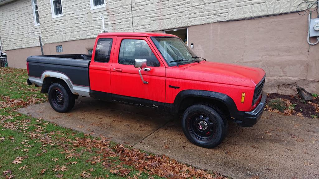

Busy day yesterday. But hey, at least it will pass inspection now. [emoji1787]
Sad part is, from what I can tell, that's the original color of the truck.

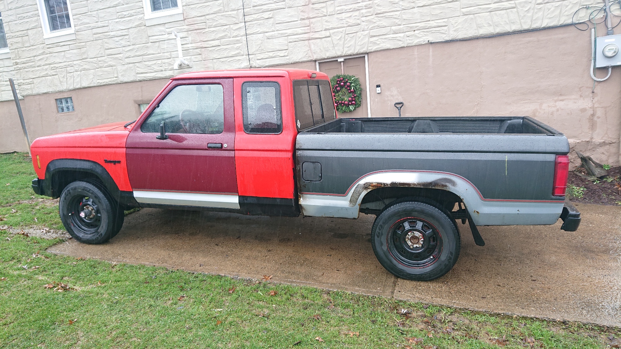

New 'bama doors are on, and 'bama fenders are at a buddys being un-crinkled. Smittybilt bumpers are in their first coat of bedliner. Still shaking off the feeling of being able to taste sound and hear colors from the fumes of painting them in the basement.

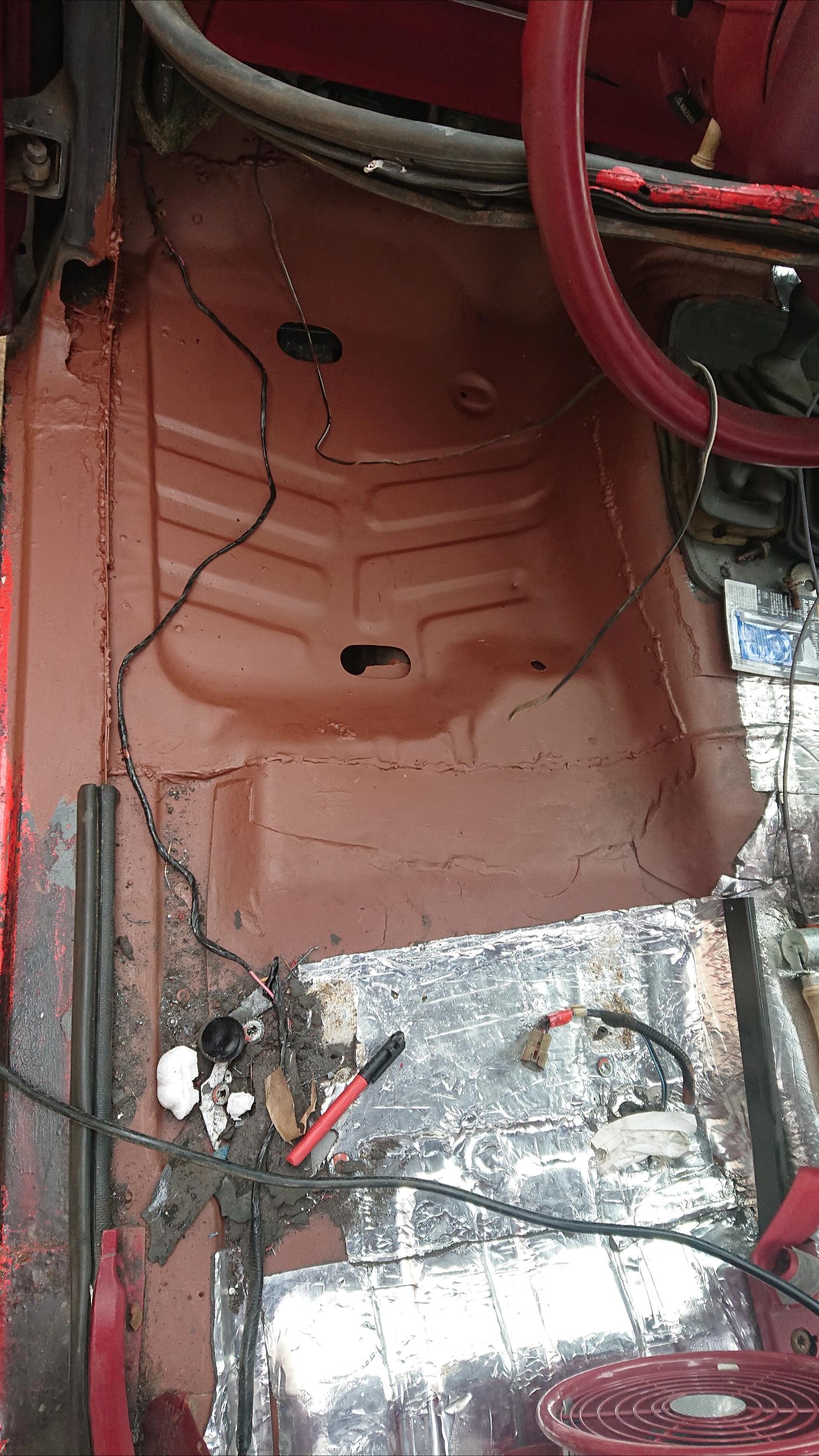

Well. Despite my splatters and horrible flux core weld job, a new floor exists.
All of the crappy looking plates are just that; every spot that had a hole was patched with 16 gauge. Because that's all Lowes had.

good enough for me...wont you be a good chap and head over to my place down 22 and hop down 250 to dennison and do mine while i am still laid up at home in detroit....:D
And after that you can jump on westbound I80 for a ways and do mine really quick. :icon_idea:

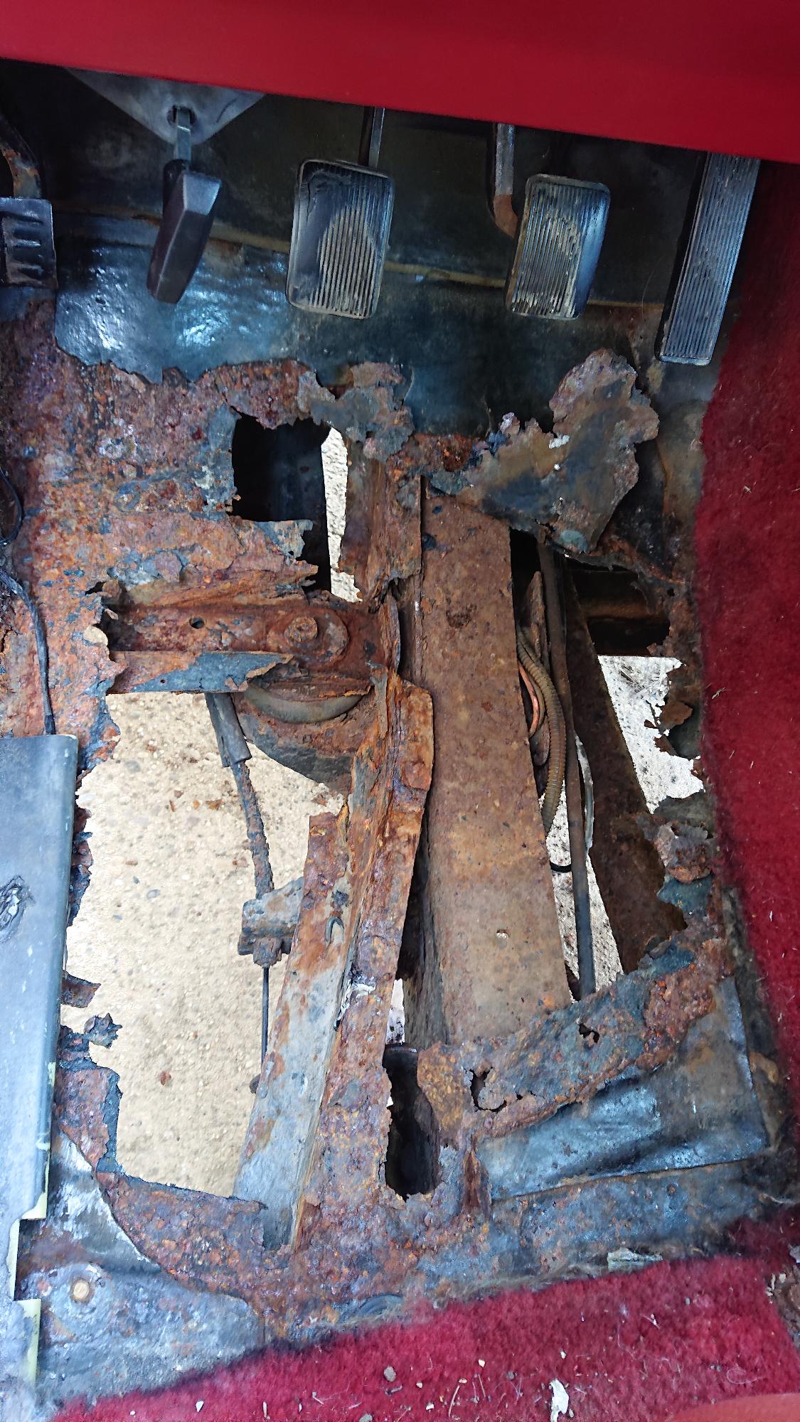

Cross post from another thread I started. Before photo of the same floor.

yeah....remember.....we all play that floor game round here...
some of us on 2nd and 3rd floors...:icon_surprised:
i got a 146 that might be rebuildable...
they are getting expensive....same or more then a m5od around here. i suggest just getting an m5od.
What floor? I don’t see a floor! That is typical for me around here. Northern Ontario Canada. We get pelted with road salt 4-5 months out of the year. Good job on rebuilding it with flux core!

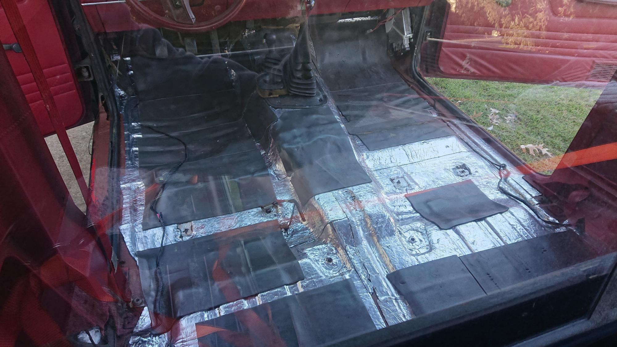

Well, noise barrier on the floor is finished. That was a MASSIVE PAIN IN THE ASS. Next up is the walls, etc. Saving the ceiling for last.
Word of experience with the Noico butyl noise barrier: spring for the Noico brand name roller. I tried the clear/green knock off one, and lost a day to it. Had to order the brand name one immediately. The Noico brand name one makes the job go very fast (by comparison) and shows you wherewith bonded vs. not.
