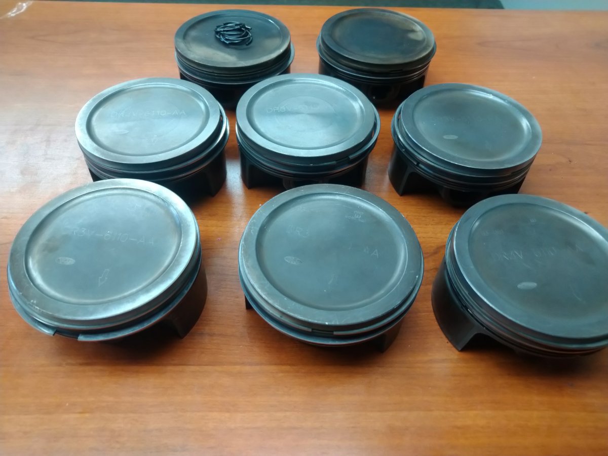

Pistons showed up! and from what I can tell, they fit PERFECTLY.
Just in case someone goes looking for another set... Ford part # DR3Z-6108-A, even though the piston tops are etched "DR3V-6110-AA"
Set of pistons came out of a 2013 Shelby GT500 Mustang with the 5.8l Trinity engine. Engine detonated with 2,000 miles on it due to what looks like a wiring or injector fault. eBay find. Heh.
Their loss, my gain. Long story short, they work in a 2.9l.
Plan of attack is to use them as-is. I did think about changing rings, but..... Nahhhh..... This is a junkyard build.

548 gram 5.8l trinity pistons with pin and clips installed
Seems that 302 forged H beam connecting rods (I'll double check these post-machining) fit if shaved 0.002 side to side, and 0.003 off the back of the bearings

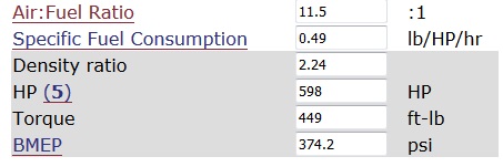

Since I managed to track down full forged internals, I may splurge for once in my cheap-assed life and pick up the T70 twin scroll thats on my Amazon wish list. Planning on setting the wastegate to 21 psi after a dyno run or 10.
As much as I DO NOT like online turbo calculators.... I messed around with the one at not2fast just for kicks. I stayed relatively conservative with my inputs.
BUT
At 7000 RPM redline with full 21psi manifold pressure:
Good enough for me.
Keeping in mind that online calculators are usually inaccurate, at 7,000 RPM and 21psi, this is what it came up with...
If I wind up with HALF of that, I'll be running through the streets nude in celebration.
If its within +/- 20% as it claims to be, I will kiss each and every one of you on the mouth.
