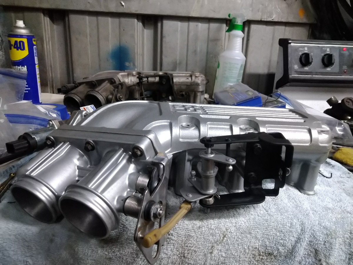

Took a break from working on heads while I wait on a few things, so started shooting powder on stuff for reassembly.
Lots of fine detail stuff on the upper intake and throttle bodies, which took lots of time I didn't wNt to spend on it, but hey, won't have to deal with corrosion for a long while.
I think it turned out OK. Need to get an accent color on the lettering.
Also powder makes it look that much cooler than the factory RBV one. 🤘🏿
You need to replace that crappy looking plastic linkage with something nice.
Agree. May paint and call it a day, may fab something.
The linkage on the euro intake is the only weakness. Works great, no question. Very over complicated for what it is, though.
