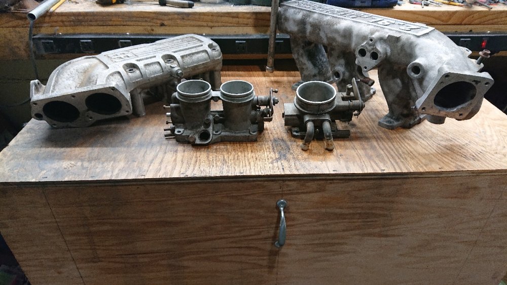

I've been trying to hunt down a bit of comparison info / writeups / howtos in between things at work since reading that bit today, but I would think a merkur motor, mounting-wise, would just drop in wouldn't it? Still being a Cologne and all, minus of course intake and some configuration..
Basically trying to begin researching before I begin buying things and jumping in. Don't mean to hijack your thread so is there another spot for me to search/discuss such?

Yup. I have a post in the 2.9 forum with side by side photos.

I'm having trouble finding a writeup / thread where someone did the entire motor swap (referring to the 2.9). I've got a truck begging me to do something with her and if no one knows of any thread of such, I'm srsly down to be the first (at least on this forum to record the project) Granted I suspect it'd be easy and I'd be using some of your info as a cheat sheet.

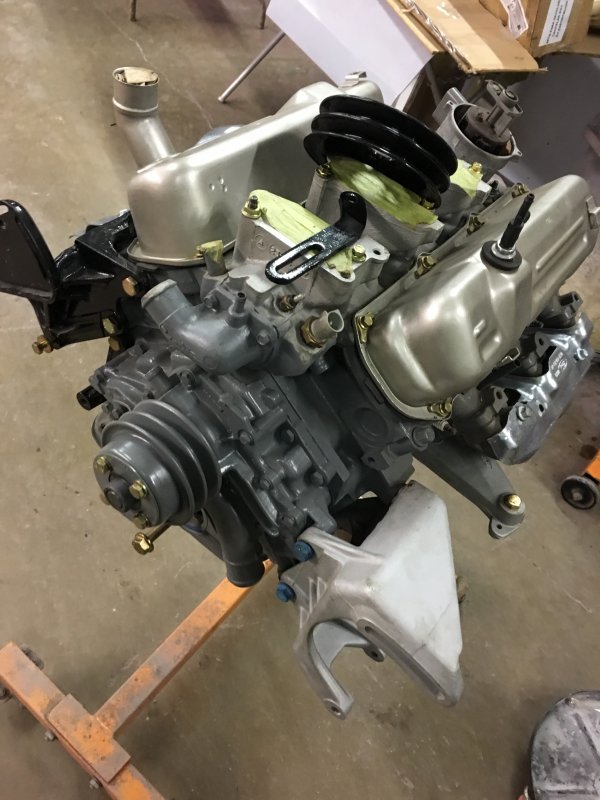

Short clip of it running with recent updates, and with the best tune yet that's been on the Megasquirt.
Still working with the Merkur guys to sort out a remaining few relocation issues. It's amazing how different the layout is on their engines.
In the process of tracking down a water neck, alternator bracket, and possibly set of valve covers from them.
Wow... it's alive! Way to go junkie...
Sweet! Why the surging at the beginning though? Some more fine tuning of the MS system needed?
Yep. Just some warmup enrichment and PID O2 tuning crap.to get after.
PID = Biggest pain in the ass ever.
Amazing how much power that ECU has added on this tired assed engine.
Honestly looking forward to the trail ride to get opinions of others that have had 2.9s over the years to see how mine stacks up against stock.
