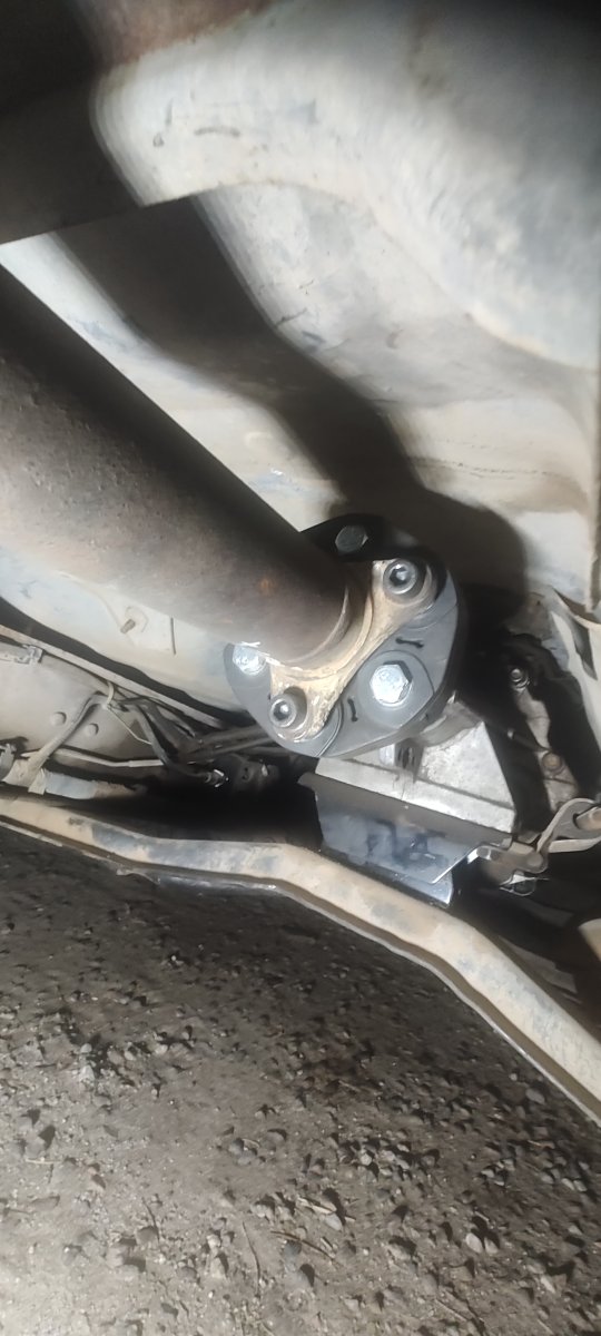

Lol sorry, I had a lot happen these past couple of months. I've been meaning to come update. Anyway, it worked. The diameter (where the driveshaft goes through) is a few mm smaller than the original tho. Finding 10mm bolts was kinda hard too. The truck drives fine tho, I was gonna update the bolt part # but I got hurt at work and then I got sick so I was completely throwin off of all this.
It came with 3 bolts, I had to find another 3.

I ordered two off Amazon, I used this one
https://www.amazon.com/dp/B0DJY39QDQ?tag=959media-20
It comes with no bolts
This one comes with 3 bolts, I kept it as a back up. I used the bolts on the other one, they're good to use as a reference for what you need.
You need the length of these bolts, the disc won't fit all the way. Once you put the bolts and tighten em on they'll force the disc into place.
