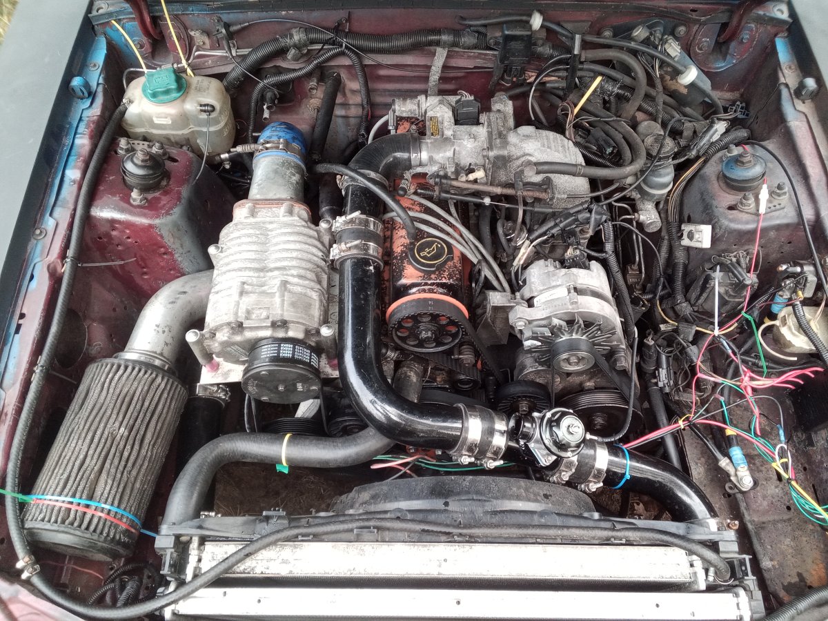

Here's a shot of engine bay... I need to figure out how I'm going to rotate the intake and then pull everything out for paint and polish and clean up wiring.. happy with amount of boost for now have a block to build up later for more boost, but it's time to focus on suspension and transmission upgrade/repair and possibly 5 lug conversion.. after the 4.10 posi install the transmission is like "no I'm not having this s*#t" and puking trans fluid out tailshaft even though it's a fresh seal... I know I can t5 it but the adapters and everything take this out of the "budget build" area and into the spend my savings build area so...

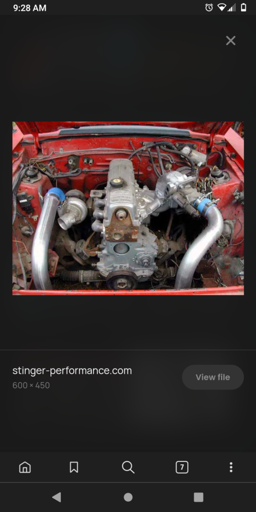

rotate the intake so its not facing backwards with a long tube to the filter?
the upper intake manifold of this design is commonly cut and re welded to point towards the driver's side.. you can buy them but my dad's got a tig so may attempt the diy...
