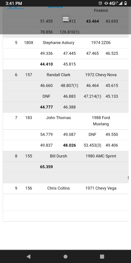

Went to my first autocross event in my 1988 mustang 2.3. It was a good guys car show.Number 7 on the time slip... Was the most fun I had with my pants on in a long time!!!

there is a guy in my local autocross group who has been running a fox body mustang for almost 20 years. it does well.
i had an 89 2.3 hatch back mustang back in college. what a great little car that was
did you spin out on the third lap? time increased a bunch and a dnf
Dnf was my tailpipe hanger not caring if it was red thread locker and falling off, I had to use a coat hanger and zip ties in the pits:LOL:.

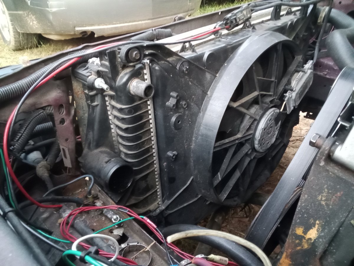

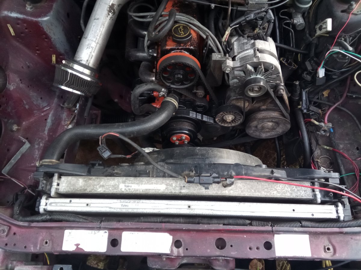

Had a chance to continue work on the AX Stang, mounting a Volvo intercooler and radiator.

Here's another view

Uses the factory Volvo fan as well as the factory mustang hoses. Two 1 1/2" strips of aluminum using two factory holes at top of radiator support and 4 self tappers on bottom of rad support four nuts and bolts and four random bushings 1" at top and 1/2" at bottom to make the radiator plumb(level but in the vertical sense). Don't know if I'm going to relocate battery or just get a Honda size battery and make a new batt tray... Then it's time for whiney boy!

What Volvo and year?
That 2.3 must have a lot of intake suction to collapse the air cleaner like that...o_O

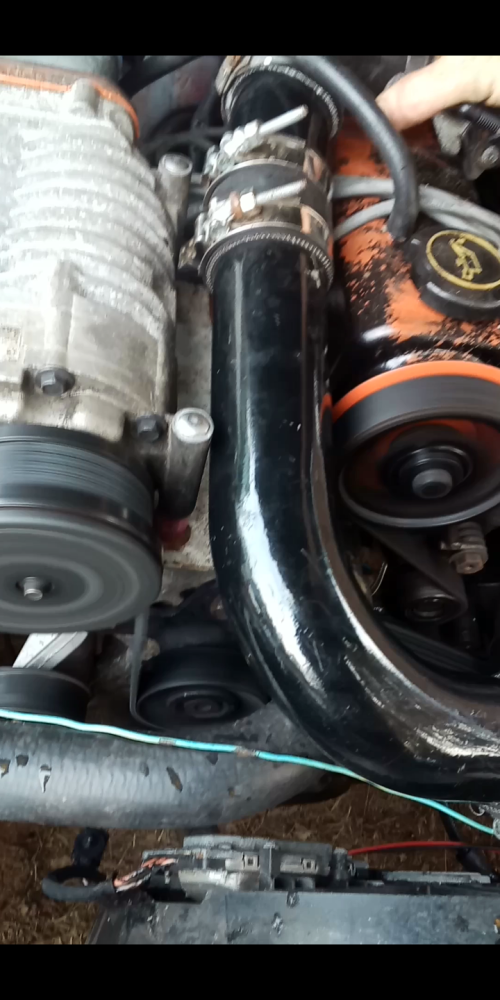

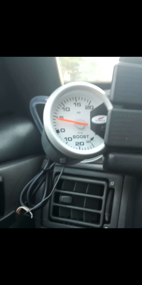

Busy busy this time of year but thing have slowed down I've gotten busy. Volvo ic and rad installed and functioning. Supercharger installed and running 5 psi at 4800 rpm. Need to adjust timing and install vortech fmu even though the fuel is good into boost... Still quite a few odds and ends need to be done and lots of paint and polish but the lil boost makes me happy!!

So I just couldn't deal with that amount of boost and I made a new crank pulley by cutting and welding svo/tc crank pulley to a ranger crank pulley, it's a little more obnoxious!!! Now just pondering between attempting installing a 88 la3 ecu and vam with 35lb injectors or using my microsquirt and a custom harness!!
